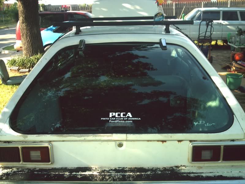

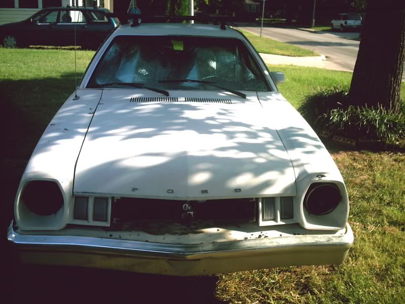

Well Monday I picked up a nasty little 60.00 car from the Field.
After looking it over its pretty straight and not much Rust at all. I cleaned it for most of two days Before sticking it in storage.
My Daughter is 15 and in love with this car..so it looks like she has her own project.
So far it's a old abandon stinky rat nest trash car with a fairly straight body and good glass. 2.3L with Power steering, Power brakes, Auto and AC.
The Deluxe interior is trashed, the Motor is in unknown condition, But the brakes Work!
I cleaned under the hood today removing the trash left behind from animals wintering. The Wiring harness is a mess
Rats Ate through the spark plug wires and most of the engine and head light controls.
I was going to use the car for parts but its seems I lost the car to my teenager. Her budget will be tight but the interior should come together quickly(she can sew well).
Fell free to donate to her project since I don't have much time to play with cars till next summer. She's Smart enough to work with the book. But I will watch closely as I can.
