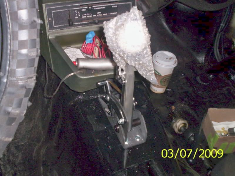

Progress report on the tranny swap.  They had to fabricate a new shfter cable mount to fit but with that done the trans is in the car.  Additionally the 4 spd driveshaft fit perfectly behind the C3.  More good news is the trans hole is covered by a plate which doubles as a shifter mount point.  The shifter is installed and adjusted.
Next come the mounting of trans cooler and the lines.  A few other items like the removal of the clutch pedal and cable.  After the trans part is done we still have to put in the new front springs.
To tell the trutch I am going crazy waiting to get it all done.  here are few shots.  the bracket is hard to see, sorry.
PS: The white ball is going aay to be replaced with my T handle with lineloc button sitting in the tray in front of the shifter.. ;D

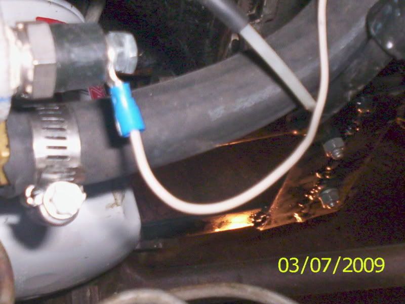

Evening all.  Been a long day.  I quoted the picture above so you can see what i did.  The electric radiator fan was not coming on properly [poor ground] so i figured the easiest solution was a ground ring and spacer.  Here is the picture, mostly self explanatory.

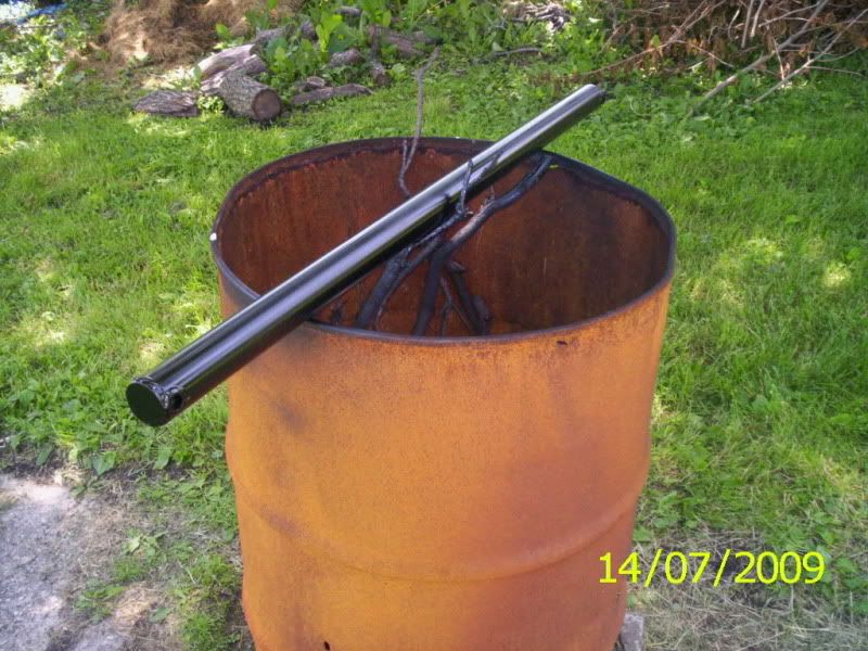

This other picture is of my paint booth as i painted and re-installled my swing out side bars for the roll bar.

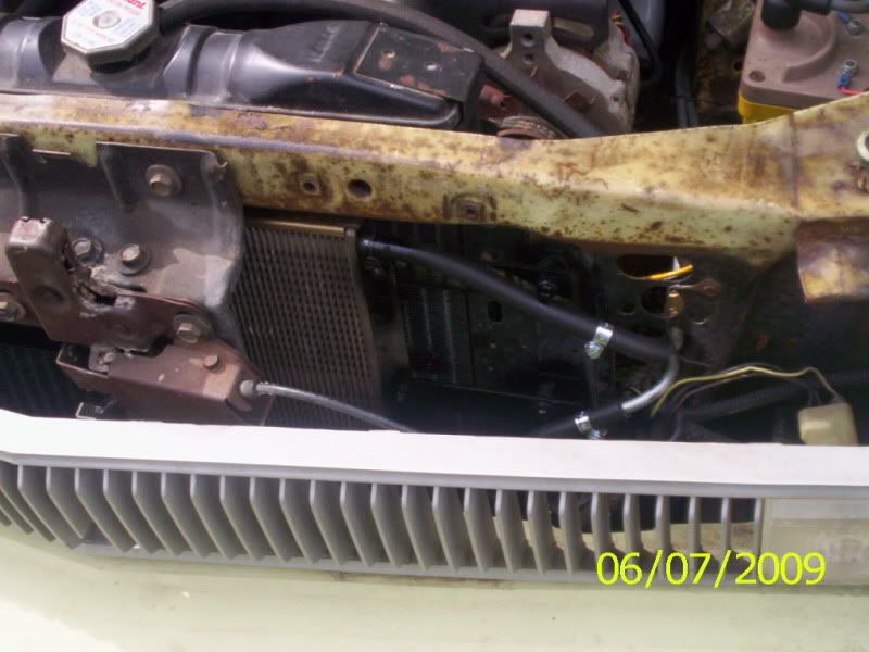

The pictures are of the tranny cooler and lines.  Yes i have already made some changes but no pictures yet.  Here is just one of them.

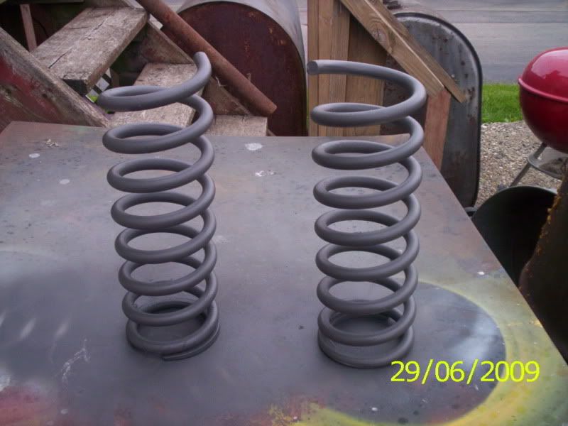

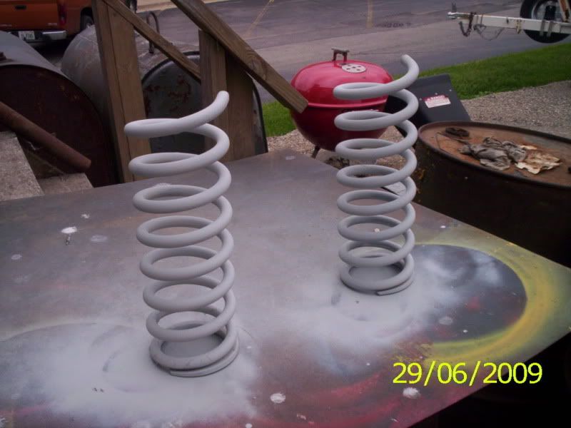

No the trans swap has not started yet..... :rolleye:  However I did do a little something.  I got a set of front coil springs used from Chris (POPbumper) and i cleaned them by hand.  The first thing was to spray them with PB blaster tolossen the rust.  I then rubbed them down with a grey scrub pad.  yes by hand.  After that i then took to some sandpaper and went over the coils springs.  i cleaned them and degreased them to spary with flex primer.
After that I sprayed them with a flexable bumper cover paint. Better than nothing while i wait for the trans swap....[did i mention that the wait is driving me crazy.......

First is the trans cooler is here and it is so cool.  This is one made at least 10 to 15 years ago and is it sweet.  Not one plastic piece in the whole damn thing..  Absolutly first class fabrication.

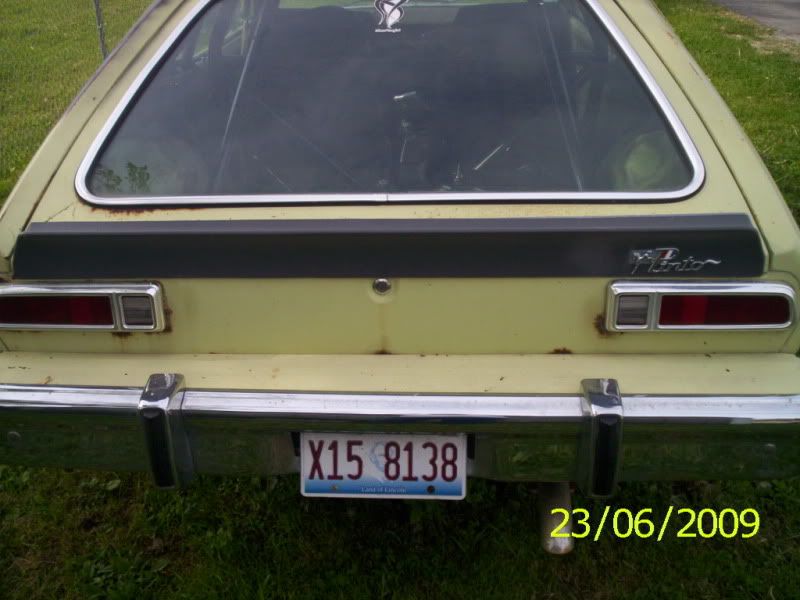

This weekend i installed my spoiler.  At first I was going to use double sided tape but after talking with someone who has done it before, it doesn't really work all that well. So what to do?  Silicon Adhesive.  Oh yes and make sure it is clear.
I first laid the spoiler up on the rear deck and it fit well.  I then laid tape around the spoiler to give me a layout area.  Oppss forgot, I carefully pryed up the Pinto emblem and the Ford letters.
Ok back to work.  Since I knew the deck under the spoiler was going to be under there for about 2 years I took the time to prep the deck under the spoiler.  I sanded and spreaded with a primer/sealer.  When that dried I layed out a beed of silicon around the inside edge of the tape.  I then laid on the spoiler and clamped the bottom and across the top I took a bowed piece of wood and put the bow down on the center of the spoiler to hold it down while it set.
After it had set, I cleaned up the extra silicon with a razor blade and it was done.  Alright i can't leave well enough alone.  Remember the Pinto emblem i took Off?  look at the picture of the spoiler.

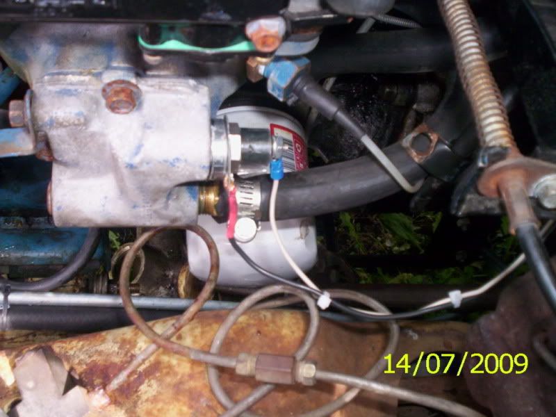

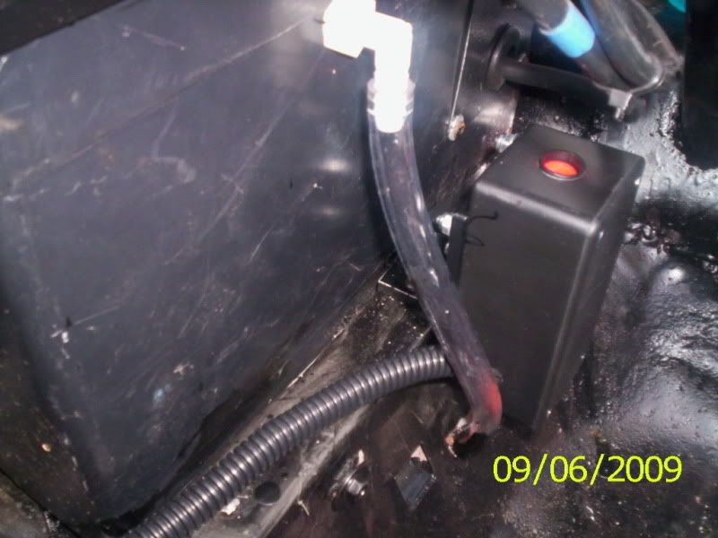

Ok back to your regular warm weather posts.  Today is pictures of my new inertia fuel pump shut off safety switch.  A mouthfull.  The first picture shows the parts required to put this together.  It is amazing the amount of time it took to do this right.  Basically I put the switch into a plastic box and mounted it next to the battery behind the pass seat within easy reach from the drivers seat.
The switch is from an escort and is relatively cheap $20.  The pigtail for the wiring which you will need is over $30+ dollars. :hypno:   Nuts and bolts about $10 and the aluminum was some scrap I had left over from another project.  It just takes a lot of time to sort it out but worth it.  The second picture is is installed.

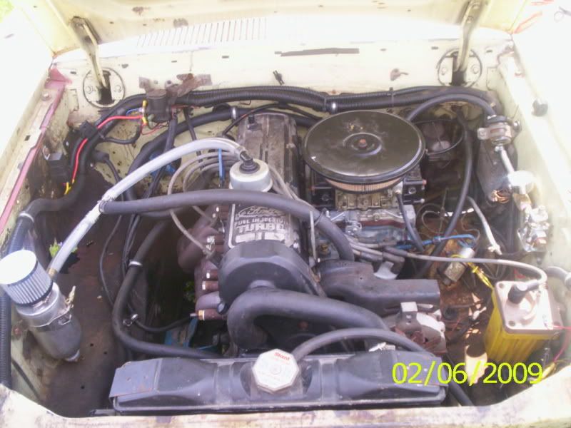

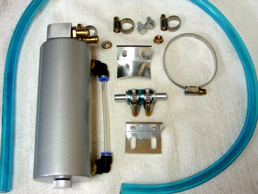

Dang...I missed it by ][ that much ;D  But you gave me an idea :amazed:  I'm staying wet sump but I'm going to install a petcock valve on the bottom of the catch tank with a high pressure return hose feeding into a fitting that I'll install in near the top of the oil pan or feed back into the oil cooler return line (more likely). Then I can let captured oil back into the engine when I'm back at the Paddock cooling it down. You just saved me A LOT of messy hassle between races ;D :drunk:  My Lotus engine was burping about 1/2 of one of these tanks each race (regularly hit 8000 rpm). I slightly overfilled it with oil for safety before each race (Paranoia). I am not using my AccuSump because it messed with me one time and cost me $$$. I don't trust it anymore and it's heavy >:(
Actually that is pretty close to the truth.  what it is is an oil / air filtration unit for a dry sump oil system.  It lets the oil drop out of suspension [if there is any] and the excess air breathes out the filter which keeps all the mess [oil] inside.
The system lets the engine breath which will be important when the boost is added.
Not to jump on anyone's post, it is an oil overflow or catch tank that is required by race rules. HIGH RPM engines can and do burp oil on to the track just in front of YOUR own rear wheels 1st!!! FUN :hypno: :accident: Pictured is what I bought on Evil-Bay for under $20 delivered about a month ago for my Hanto Pinto race project...
Hellfire, what is that setup going from the valve cover cap to the fender????
