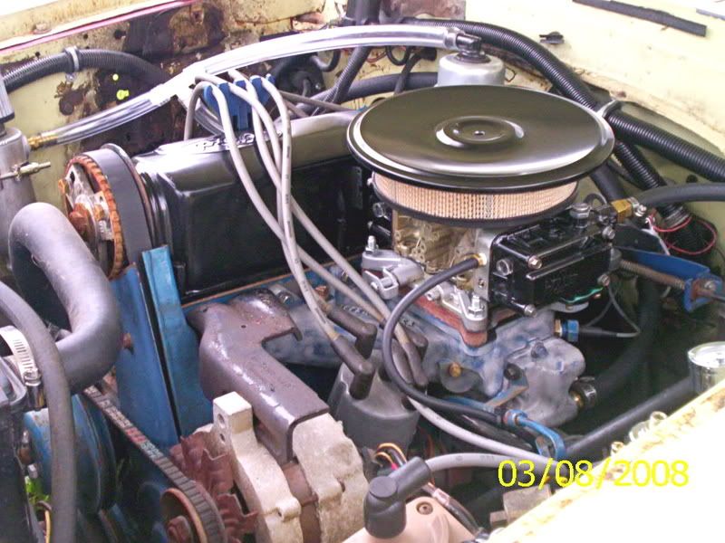

This is how i spent my weekend.  Since i was not in a position to do any mechanical work on it I decided to clean up the engine compartment.  I have always hated the chrome valve cleaner.
and
yeah i know the air cleaner lid is too big, what I need is a 6 " air cleaner top.  Anybody got one?????????????????????

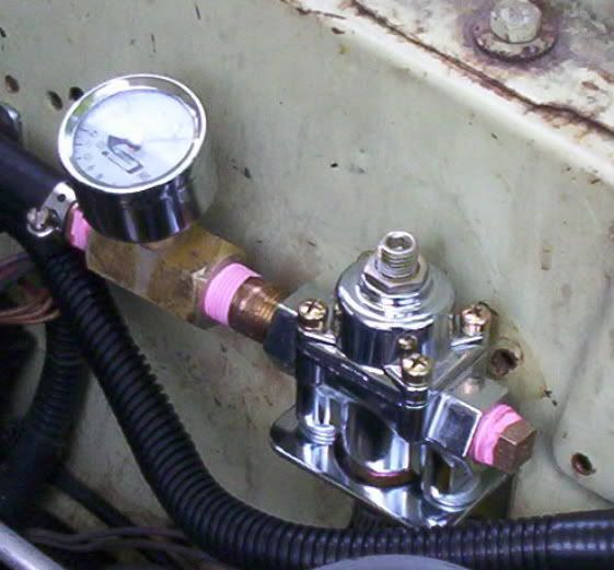

Do NOT use regular teflon tape when taping fuel connetions.  Gas will eventually eat the teflon tape.  The is a special pink color teflon tape that is specifically for gas lines and such.
Got a good start on the air cleaner but don't expect much as this is just temporary until I get the fuel injection installed.

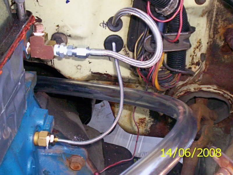

It was a pretty good weekend as i got some stuff done between the rain showers.  The first is the phenolic spacer.  If you remember I had an open 1/2 spacer which was ok but not what i really needed. So i got the 4 hole spacer and modified it to work.. there's that word again.... :read:

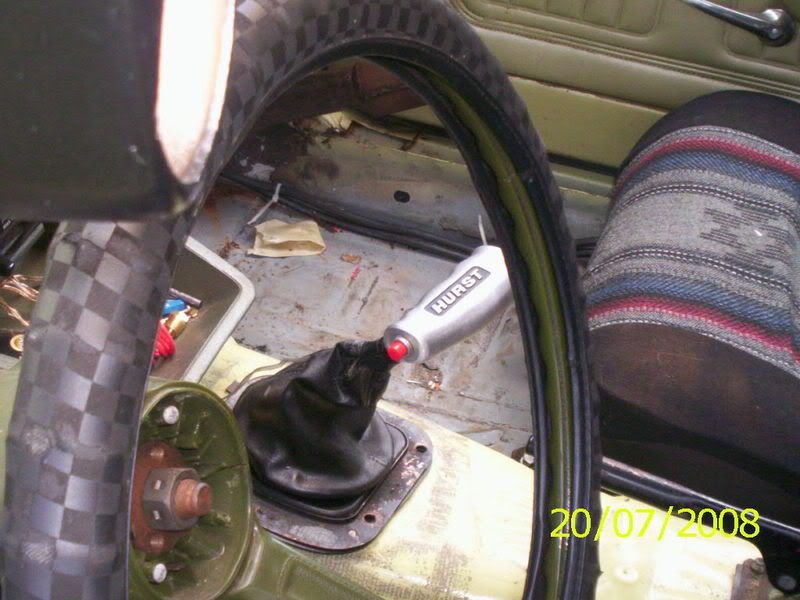

The next thing I did was install a Hurst t-handle with a button for the line lock and wired it in.  To work it requires you to manually flip the toggle switch and then press the button.  the toggle switch is to protect me from myself... :lol:  One shot is of the shifter itself and the other is how it fits in the interior.  personally I like it which is good because it is my car.
and
So what's next???  Well if things go right I will get the brakes done during the week, I hope and then next weekend I plan on making the carb air cleaner.  I will also tell you about the fuel pressure gauge.

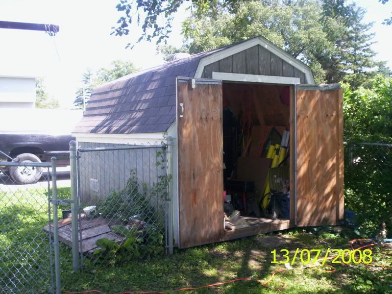

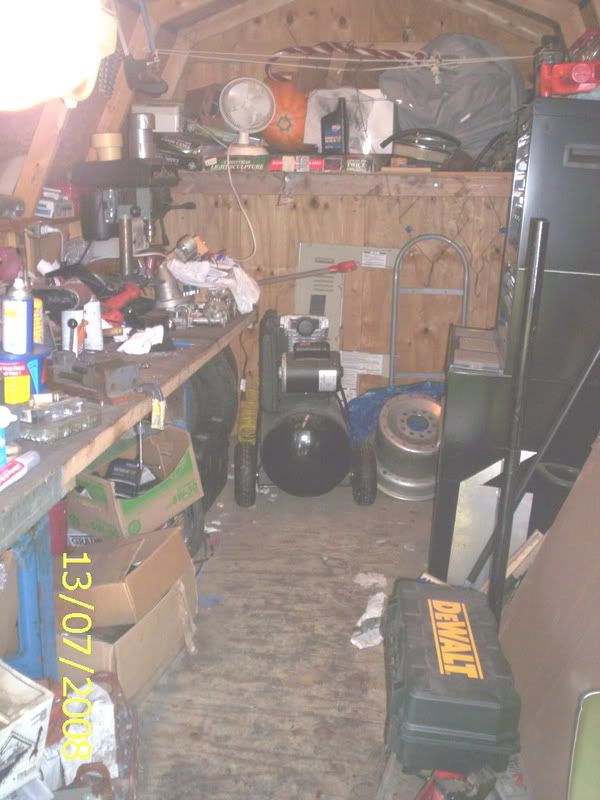

This second post is going to be a little different.  There have been over 3000 views of my project over the last couple of years.  The people viewing may think that I have a big garage and a machine shop to get all this done.  Well here is a picture of my garage:
and here are a couple of pictures of my machine shop:
and
The point of this is NOT sympathy for me but to point out that you don't need all the fancy stuff to get your Pinto the way you want it.  People just starting out and people who are burned out on their projects take heart, it can be done.  It just takes creative thinking and determination.  Take your projects and break them down into singular projects and tackle one at a time and before you know it it is where you want it to be,  I still have two more steps before my Pinto is drivable,  exhaust and brakes.  But i couldn't be happer with the results because I built it my way and the best that I can do with what I have to work with.  I am very glad I have the car as it helps keep me sane of course if you own a Pinto that part is questioned anyway. :lol:
So keep on working on your project and soon enough it will get done.

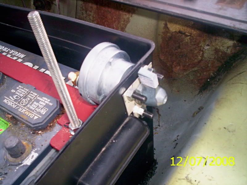

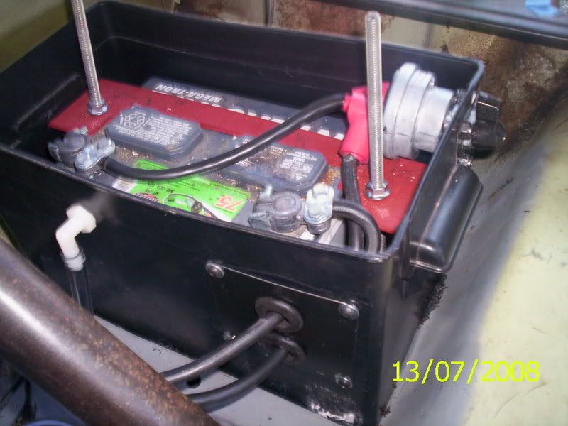

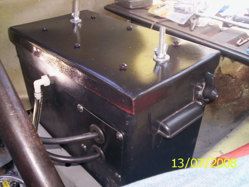

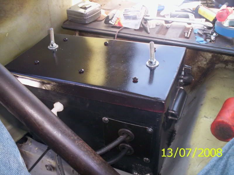

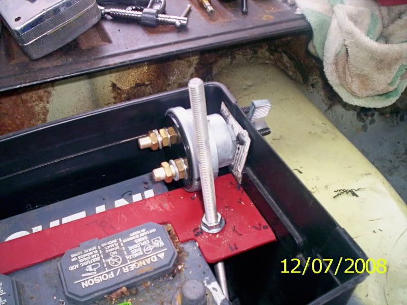

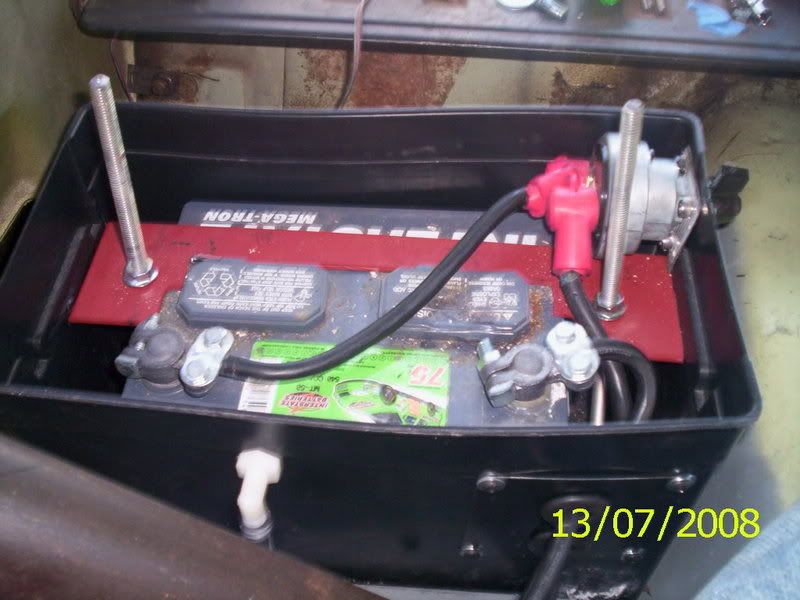

this post is about finishing the batttery box w/cutoff switch.  The pictures tell apretty good story.  i just simply finished the wiring and closed it up.  It works just fine.
When you look at the pictures of the battery box remember that the only  stock part is the lower plastic bottom.  Everything else in the picture is custom made in my shop.
I will post two pictures and the links for two more if you are interested.
here are the links for the other two pictures.
http://i93.photobucket.com/albums/l66/hellfirejim/battery%20box/cutoffswitch07-12004.jpg
http://i93.photobucket.com/albums/l66/hellfirejim/battery%20box/cutoffswitch07-12005.jpg
Now on to the second post................
I am going to try this again. the last time the site just freaked out on me.
Been busy today. I am mounting my master cutoff switch to the side of the battery
box so only the switch handle will be visable.  When i turn off the car i can reach
back and flip the switch to isolate the battery from the car.
Since the battery box is plastic i felt it neccessary to make up mounting plates
both inside and out to support the mass of the switch.  It is amazing that small
parts such as these take as much time as the big parts.  I had to design the shape
of the plates, then drill a hole where i think the switch will poke through. I put
a punch through the hole to keep the two plates centered and one at a time drilled
the connecting mounting bolt hole in each of the 4 corners.  The challenge was to
keep it all aligned.  After opening up the center hole to allow the switch to pokethrough
I then clamped onto the battery box and started the drilling and mounting of the
plate all over again.  Because the box was not a flat piece i also had to make spacers
to keep the mounting plates flate.  With the mounting plates secure I then cut out
the hole in the center using the plates as a guide.  Did I mention I LOVE uni-bits??????
So now we are to the point in the pictures. The outer plate is painted black and
the plate where the cables go into the box is also painted black....  now that I
am thinking about it I might just paint the outside of the switch and handle black
as to maintain the stealth look.    No wonder I am tired.  I also made multiple
trips to the hardware store to gets the necessary bolts.  why is it that you might
have the bolt but it is the wrong length?????
Tomorrow, I am going to finish the install of the switch and the cable entry plate.
Wire it all up and see if it works.  Depending on what happens and how long it
will take I might startup on mounting the muffler.
Brakes get done next week if the wiring goes well.  The goal is to get it on the
street drivable before surgury.  Now that would be good medicene.

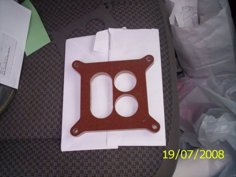

I then placed the carb on on the manifold and realized that I need to get 1/2 " of height to make it all work.  So I first went and got longer carb studs. Then i went looking for a 1/2" carb spacer.  Nope ain't going o happen so i then remembered the guy i bought the Pinto from had a shelf full of ..stuff.  Iswung by there and got a free 2" spacer that he didn't need.  Well lo and behold  each end had a 1/2" flat plate cast to a 1" spacer to get 2".  I simply cut off the plate and with the longer studes bolted it in.
It is an open spacer and i really need a 4 hole 1/2" spacer to make it right.  Anyway i fired it up and happy days.  it ran but wasn't "right".  Sunday i raised the fuel pressure from 4 to 6 lbs.  i then took it down off the jackstand  after 2 years and set it on the ground.  I hit the key and it fired like it was fuel injection.  I ended up driving it for a 2 block trip but straight pipes and dragging rear brakes created an issue.  I did learn something though and that is i am fooling myself to think I can manually operate a switch for an electric fan.  i am going to get a temp controller unit.
So that's about it for now.  if you have any questions please ask.

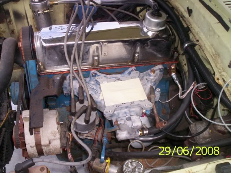

I am going to try and explain what i did to get the carb, manifold and linkage to all work together.  if it gets too long I will stop and I will do another post.
Ok first is the manifold.  stock it is an offy 360 that I have modifed the plenium area.  Next is the holley carb and it is a 450cfm that was gone through by a friend Walt Bainey out of Ohio and he did an excellent job.  I ended up using a stock accel cable holder but modified. That word seems to come up a lot.
The carb is mounted backwords so the linkage is facing the fire wall.  The linkage post is at the bottom of the linkage and yes it does open all the way.
Mounting the accel cable holder i first had to make a plate to move the holder to the right about 1 1/2" just used a flat plate.  I also used button head bolts to hold the plate to the manifold for clearance.  With the cable popped on that carb I set the cable holder down and realized the angle was way off.   So i did the first thing that came to mind and grabed the whizzer and made two cuts so I could bend the piece flatter to improve the angle.  Don't know what angle it ended up at but it works.  I took the piece over to the guy who does my welding and he cut two fill pieces and tigged it for $7.  i gave him $10.
looks to be agood place to split the post.  be back in a minute. here are the pictures to compare to what I have written.

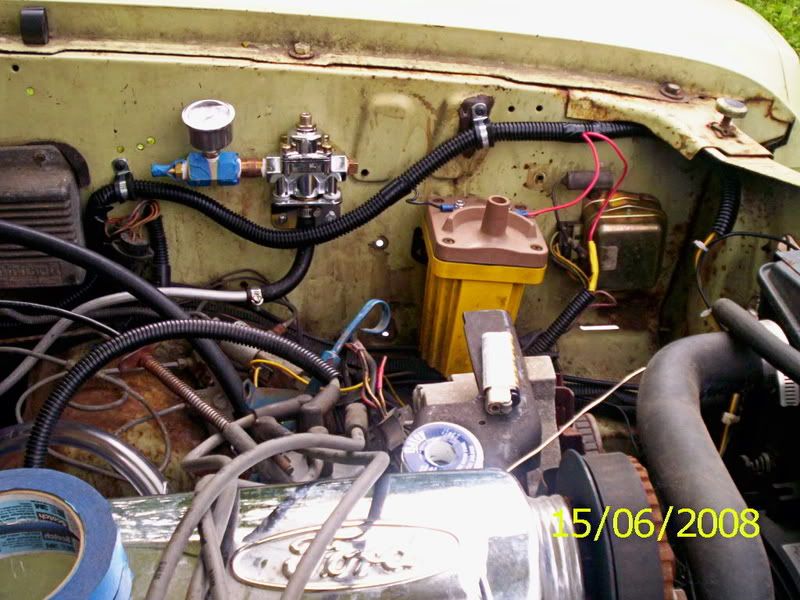

Yesterday was a good day.  Between dodging rain showers I managed to first get the oil and filter changed.  That oil filter sure is easy to get at with no intake manifold. :amazed:   :lol:
Most importantly I got the intake manifold installed and plumbed.  Here is a picture:

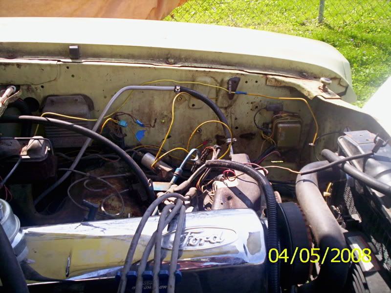

today, sat, is a good news day.  I was out working on the car and just came in before a big storm hit... :lol:
First thing I did was clean up the mess and tools from all the wiring work.  What a mess.  Then I painted my new claipers and NO I didn't pain them red.... :nocool:
i finished porting the intake manifold and took it over to my buddies to bead blast it.  Came out a funky aluminum color but with faint blue stripes.  hard to describe, I will get pictures tomorrow.  Speaking of tomorrow i start with an oil and filter change and then I actually start puting things back together.  It is posible that by the July 4th weekend this may be running.... we shall see.  it would be really cool to have this running before the surgury....
Well I have finished the wiring on the car and i thought I would be happier...  This Scot K death thing has hit me pretty hard.  As a racer I understand why he does it but if you have never raced at that level, you simply cannot comprehend the height of the dangers involved....  Only by the grace of God have there only been a few. :'(
maybe some pictures if anybody wants to see the finished work.

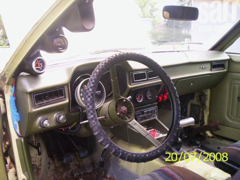

I am down to finish wiring the gauges for dash light power. [see question in help section]  That plus a ground and the gauge part is done.  Then I get to the fun stuff, the intake.  I get to finish modifying it and get it installed.
bobscat
Hey Jim, thanks for the heads up, and glad to see you are up and around fiddling with the car!
This is more of a heads up from my experience.  I had a sunpro mechanical oil pressure gauge and i decided that if that feed line for the car was coming inside I did not want plastic or copper. I found a braided hose at a decent price.  I went to connect it to the gauge after running it through the firewall and found it would not fit the gauge.  It seems that gauge only had compression threads on it and there was no adapter available.  So I bit the bullet and bought a VDO gauge.
On another board I read of a number of people that have had problems with this sunpro gauge leaking or filling up with oil,  I was spared on shear blind luck which is ok and appreciated.  The real deal here is don't short cut on things like gauges and such as it will come back and bite you in the butt.

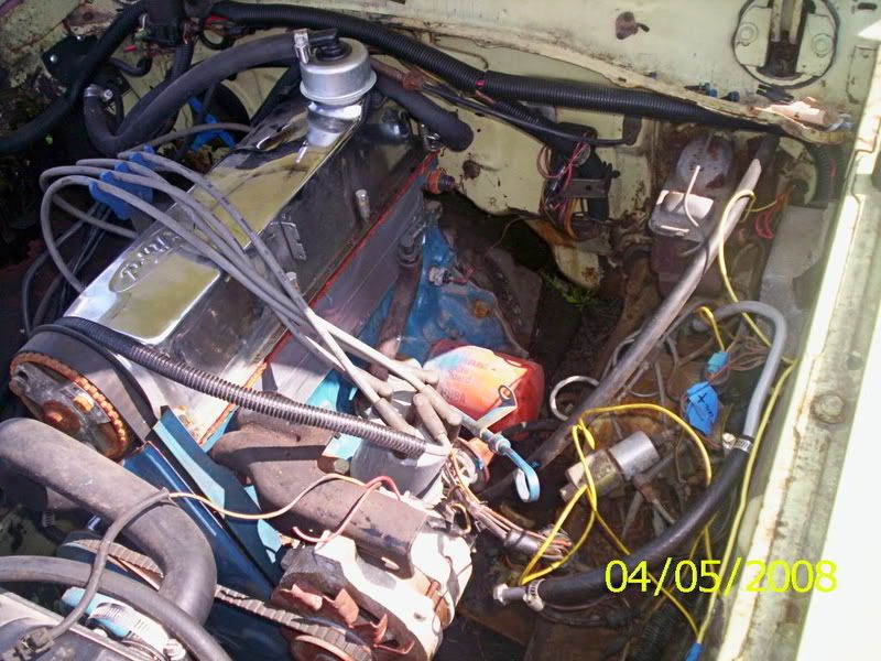

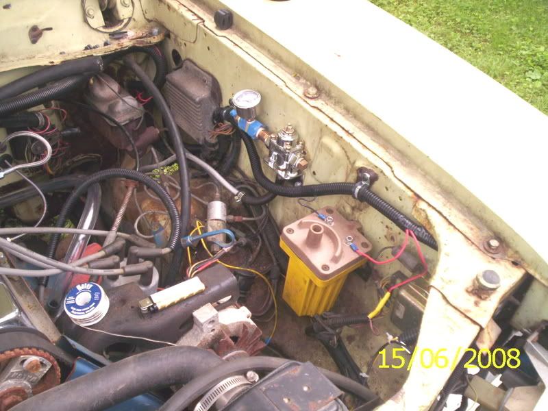

Amazing enough I actually got to go outside and work somemore on the Pinto.
Here is a picture of what the wiring looked like:
and
this is what it looks like now.
and
Just one more thing done.
