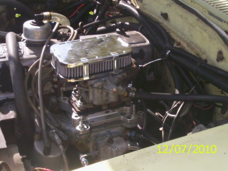

Here is the last installment on the great carb swap.  I painted the accel cable bracket and made a new copper vacuum line for the trans with 2 adel clamps to hold it.  i contacted Vee Dub Parts Unlimited [vwparts.net] and ordered an EMPI air cleaner 1 3/4 inches tall.  It is not an exact fit but really close  I had to use longer bolts and nylocks.  It also has a hole and fitting [included] for the pcv hose which I am not using as I use another system.
Anyway it is on, clears the hood and looks great.
PS: they have taller air filters also.
here is a link for two more pictures.  One more thing done.
http://s93.photobucket.com/albums/l66/hellfirejim/Pinto%20Carb/
When i put it back together it would barely idle and ran rough.  I did the trick of spraying around the base of the carb and sure enough it changed so i had a vacuum leak.  Took it back apart, resealed it and put it back together.  Much better but still had the bog when I hit the accel.  I replace the accel pump diaphram and that helped a little but it still wasn't right.
The main deal was I couldn't see the accel pump shot.  So I pulled the carb back off and tore into it.  Now keep in mind I am working with a holley 2brl built for Ford and is progressive.   I am not the smartest guy when it comes to carbs and I had never seen the inside of this one.  So I pulled the top off and I finally got the air to blow through the feed holes to the accel pump.  I had a feeling that it was not as simple as that so I pulled off the sqirters and tried to blow throw them and couldn't.  As fate would have it I still had the carb from my 75 and the squirters worked well.  Anyway I put it all back together and it started and ran like it should except is was rough.  Number one header pipe was not as hot as the rest so I pulled number one plug and it had not been firing.  I had another old set of spark plug wires and I grabbed one and check for resistance.  Put it on and it smoothed out.  Now it is responsive, idles clean and in gear it idles at 800rpm.
Most of this was just basic mechanics and a little bit on knowledge of carbs along with a whole lot of luck.  :amazed:  BUT I got it done and it works.  Now i have to order the air cleaner for it.  it will cost $16 plus shipping.
I am glad I didn't have to pay somebody to do this.  :lol:
peace

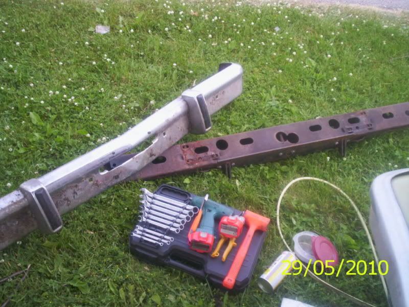

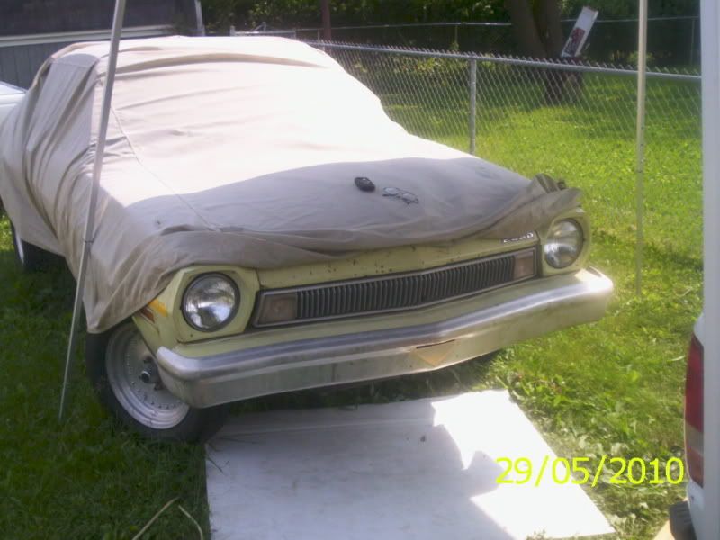

Ok a little more serious now.  I was going to put the old front bumper back on the Pinto today.  When I started to do it I just couldn't....So i went back into the shed and pulled out a 1977 aluminum front bumper.  I know that everybody says they don't fit but being a hard head I figured I would try it myself.  Guess what?  they fit!!!

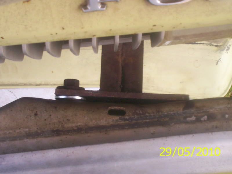

I took off the big steel beam from the car and bolted the aluminum bumper to the front mounts with 4 5/16th bolts.  It is not going anywhere as the factory only used 6 bolts for a package easily weighing 40lbs.  I am not worried.
This picture shows the only thing i added was a thick washer.
I just trimmed the fil panel and it was done.  I used the stock mounting points for the bumper and the flat pads for the bumper shocks.
This is the results.  The good thing is I have a 77 parts car that has very good bumpers.   :lol:Here is a link to the rest of the pictures.
http://s93.photobucket.com/albums/l66/hellfirejim/Front%20Bumper/

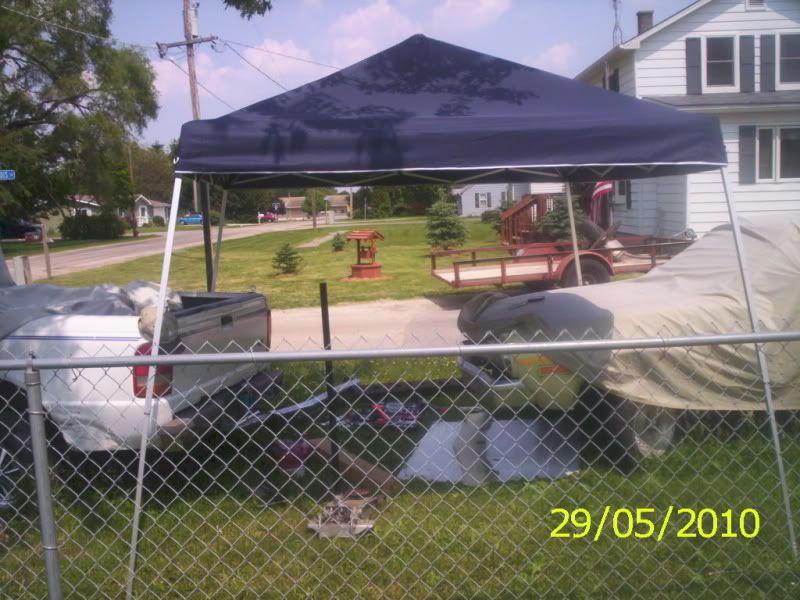

Everybody stand back, presenting my new garage with the blue roof  :hypno:
No that belongs to my chassis guy.  the engine if you noticed is a BOSS 429 style engine.  However it is 600 cu in and makes well over 1100 hp.  This is normally an 8 second car.  The last time it was at the track it tripped the 1/8 th mile timing lights with the BACK tires.  Yes it was skying.  it normally carries the front wheels but this new motor has a lot more torque......
But he is a Pinto guy and has been through many years.  It start as the usual 302 swap and then went through many variations of small blocks [some turbo] to the present big block ford.  The motor is a work of art.
So what do you know the last post was Pinto related...... :lol:
peace
Looks like a nice cruise-in!  Does that Pinto belong to anyone from here?  I especially like the Rambler convertible and the Edsel.
