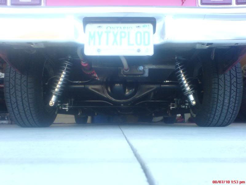

yup, it's kinda sick....i overkilled it for sure. Thats with M/T ET Streets at 10.5 inches wide....slicks with a couple of squigley lines to make DOT happy. suspension needs to be adjusted for sure, wish i bought the double adjustable coil overs instead of the single adjustable ones.

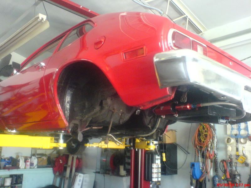

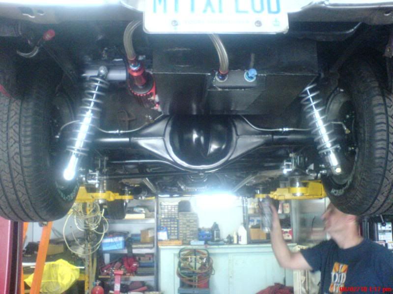

The car is done....for this year anyhow. Next i'll be redoingthe tranny cooler lines and installing a bigger rad, but that will be in the fall. New rear, new 3rd member, spool, four link with coil overs, wilwood brakes all around and new subframe connectors....enough for this year!

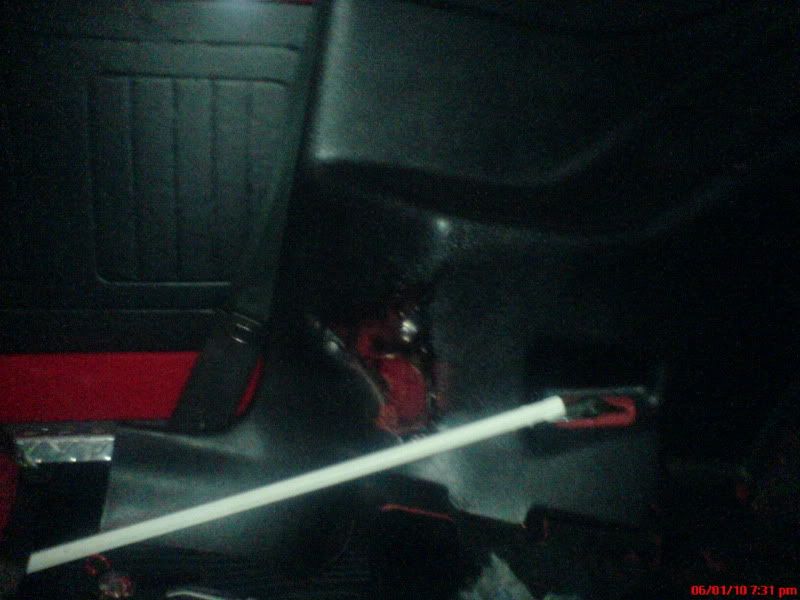

Still working on the ladder bar setup, post pictures later. Had a small fire using the plasma cutter, pinhole in rear floor and a spark lit the insulation on fire inside the right rear panel in the back seat! Fire was put out quick but the panel now has a gapping burn hole in it. Looking for a new panel if anyone has one they want to sell. It's the one the seatbelts pass through on the TRUNK model car.

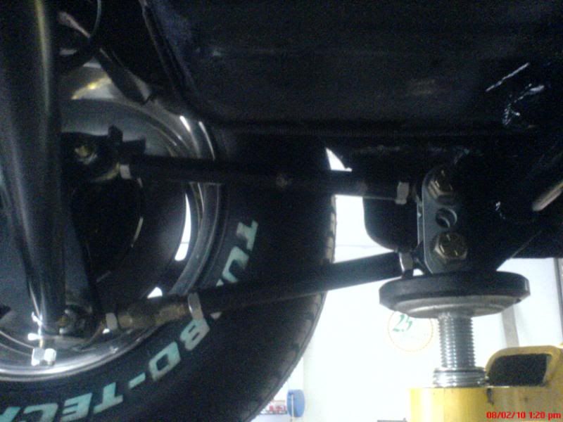

well, 275-60 15's fit in the wheelwell....buts it's real tight. They are 28 inches tall and i think i'll return them for a 26 inch tall as wide as i can get (i think 255-60-15's is the widest) The 28 inch are a little too close for my liking. Got a custom sheet metal 9 inch with 31 spline axles going in, old subframe connectors being cut out and redone.......very excited!
Don't you just love that tightness. i have welded in frame connectors and a 6 point cage with swing out door bars.  That car is tight.  I can jack it up from anywhere.  If you got power the minimum is frame connectors and i would highly reccommend the roll Bar.  You can get pretty creative with the bars especially with the high level of power.  either way just be safe...
The good thing with the ladder bars is it locks the rear, its like having a huge sway bar. And with the frame conectors hooked to the ladder bars it stops all the body roll under WFO, which as you know is the start of out of controll. The body roll causes the car to redirect its path against your will. With the new set up you may still get the wheel spin and maybe get a little slideways, but the car will remain level and more easy to controll while you still mashing the carpet flat. I can put a jack under the car behind the front wheel and lift the car and pull both front tires up the same, and same in the rear.
I do have my M/T ET streets, that should do the trick!
cant wait to see how she does. shame your not close we would throw my sticky mickeys on the back before you blast her.
This will be the first time since i owned it i won't be doing the work on it....but what can i do about that. If all goes well and i feel good this summer it will get one more trip to the track, so i don't think i'll put a cage in it. Put i will put my foot the the wood for one all out pass (if it goes straight) before they show me the gates to leave! I'll be happy to see a 10 second time slip on pump gas on 9 lbs of boost, anything faster would be a bonus! I'll take some pictures as my buddy Chris progresses with the brakes and rear end.
