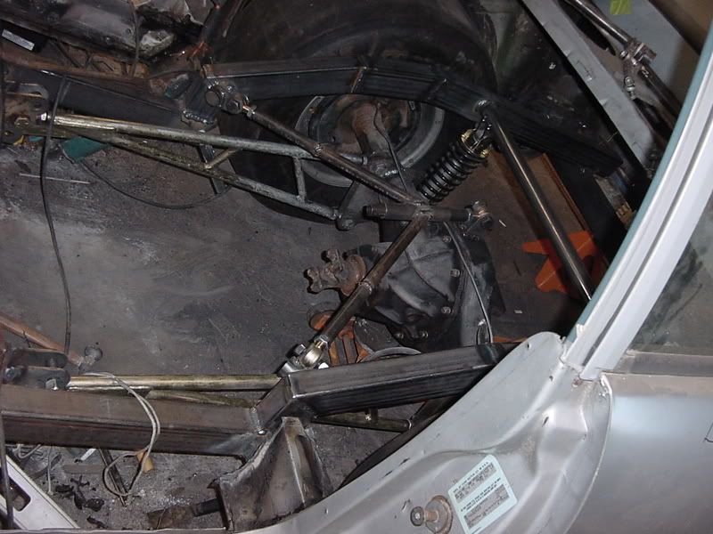

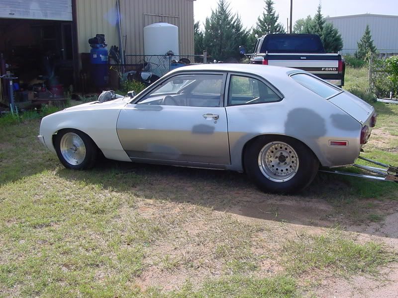

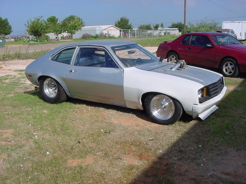

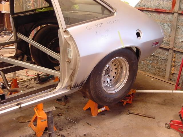

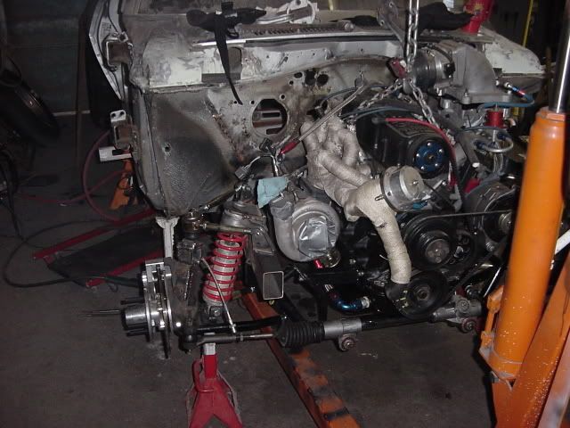

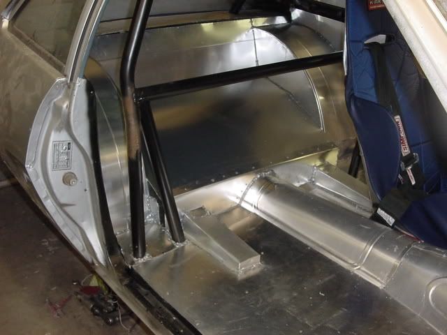

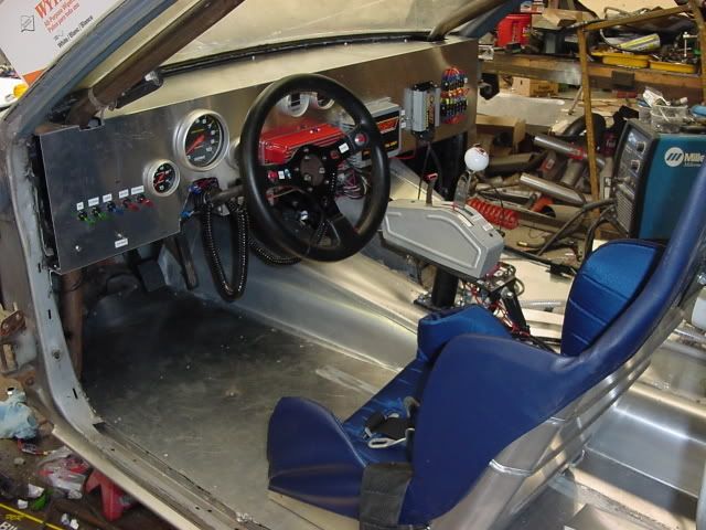

Just finished with the shakedown runs of my new project 2.3ltr turbo pinto drag car. I started building this car in May of this year after crashing my 85 turbocoupe in Feburary. I used everything off the turbocoupe except changed to a narrowed 9" rear end. The chassis is a full 2x3 .083 wall square tube chassis, ladder bar suspension and modified fox body front suspension with a SLA conversion of my own design. (similar to the Griggs SLA conversion)
Engine is a .030 2.3ltr, crower sportsman rods, je 9.0 forged pistons, esslinger svo head w/roller cam. I am also using a C4 that I built myself. Engine management is FAST bank to bank and running a PT67 T4 turbo with an air to water intercooler. Engine also has a full block girdle built by a machinist I know.
I sure there is a lot I missed, but here are some pictures and link to last Saturday's shakedown passes. Still a lot left in this little motor when I get the bugs out.
