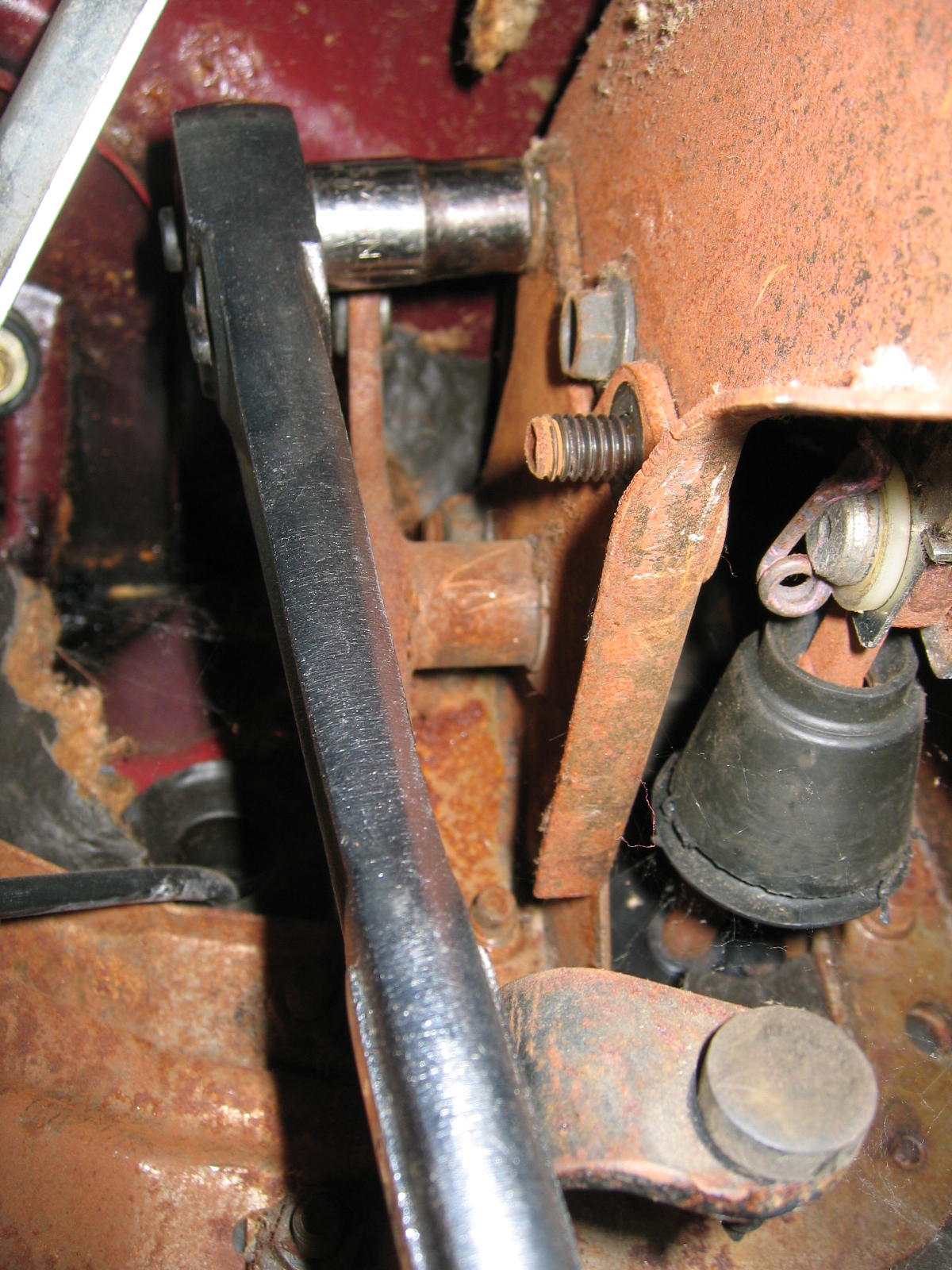

Since the 78 has an auto and I'm swapping in the T-5 with the turbo engine, I will have to swap the clutch and brake pedals also. As of right now I have removed the pedals from the 79 only. The 78 will be done at a later date. Its not much work just a lot of time on your back, with your arms and  :afro: under the dash. I removed the clutch cable from the pedal and then I was able to wrench off the three nuts securing the pedal to the column.
Big picture-->http://photos.imageevent.com/pandbz/78pintowagon/78pinto%20019.jpg
Then I removed the brake master cylinder rod and light switch from the brake pedal. I was now able to remove the clutch pedal bracket. I would probably have more room if I had removed the brake pedal first. :drunk: I was then able to take the clutch pedal out. I removed the bolt that holds the brake pedal up and removed the pedal.

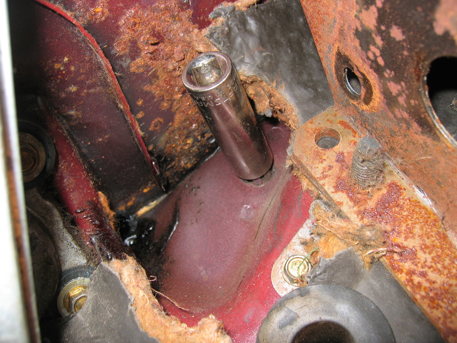

To remove the clutch cable from the firewall, I found a deep socket that fit over the star clip( ???) tight enough to close it so the clutch cable could be pulled out.
Big picture-->http://photos.imageevent.com/pandbz/78pintowagon/78pinto%20020.jpg

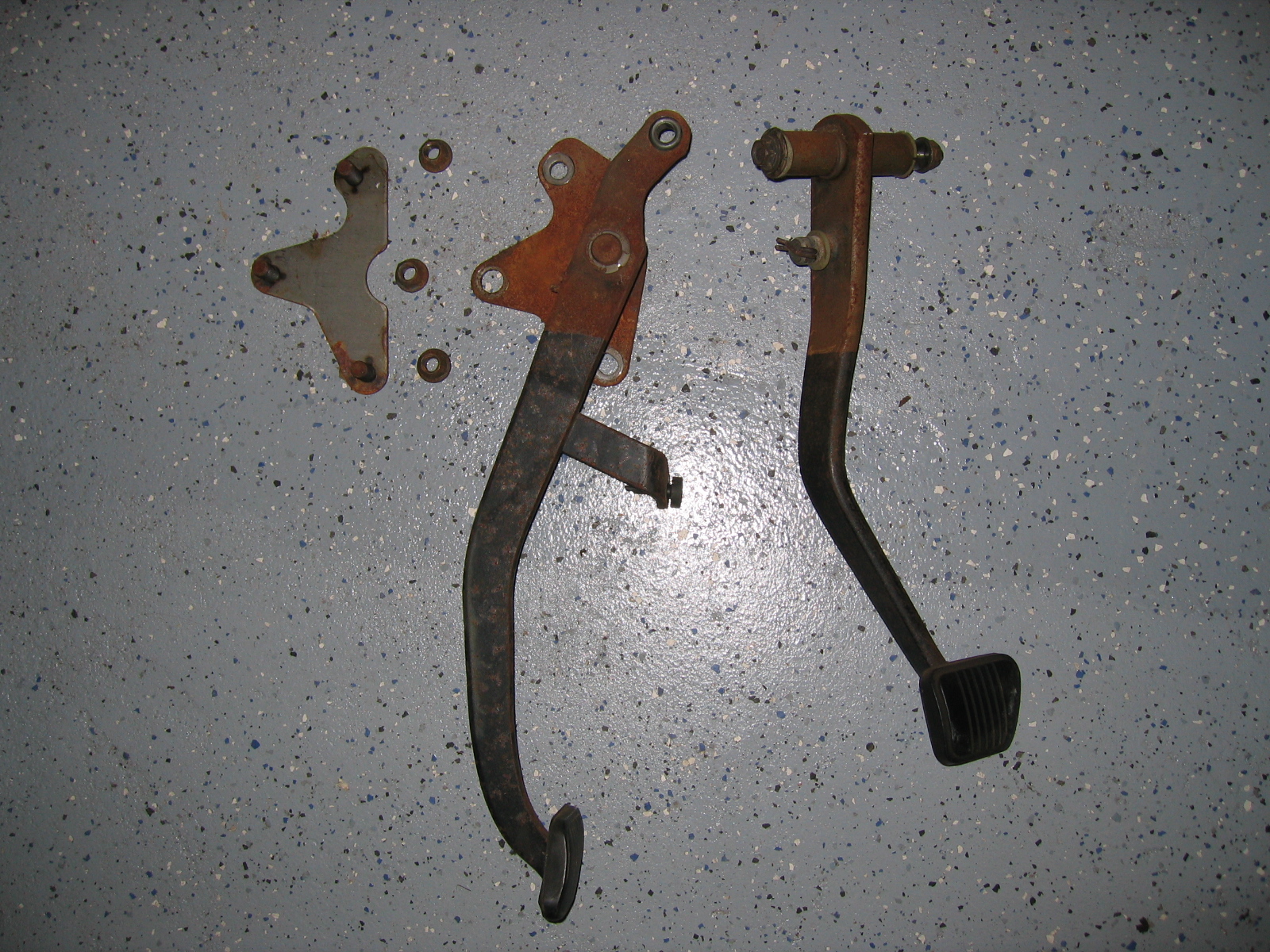

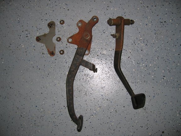

Heres the goods.
Big picture-->http://photos.imageevent.com/pandbz/78pintowagon/78pinto%20023.jpg
