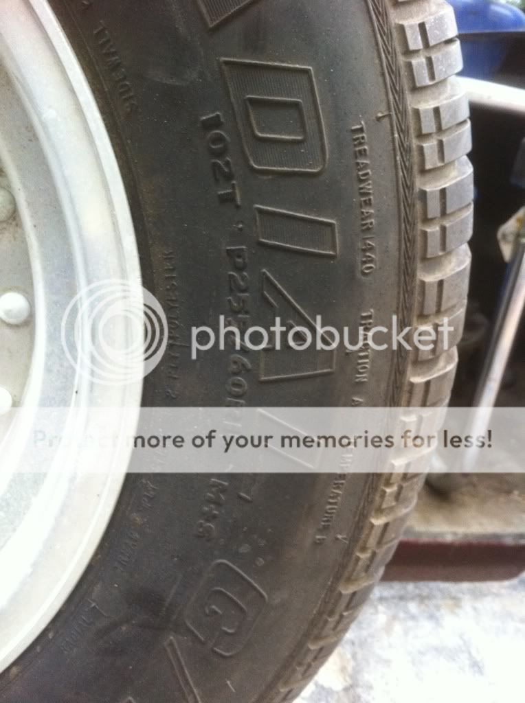

The wheels and tires for the wagon. It is a start. eventually I will want to go wider and taller as the times get faster.
