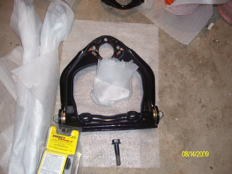

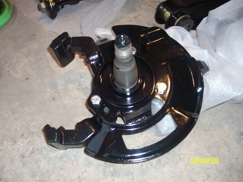

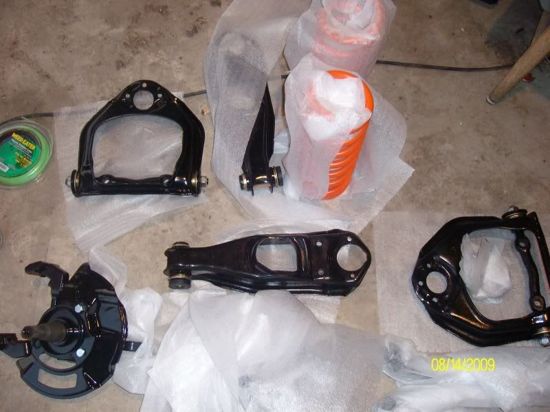

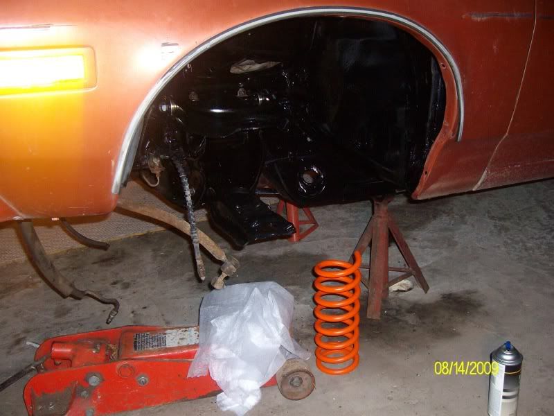

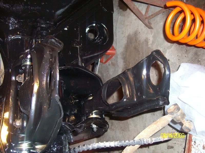

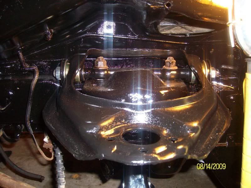

As sated, the parts came back from finishing.  I am undoubetely satisfied.  Even during my clumbsy reassembly, they are chip free!
The finish is a Urothane (sp??) baked finish.  Wet paint is applied electrostaticly, and then baked on for a rock hard finish.  Parts are prepped by baking them at 350 degrees to burn oils out of the metal.
My parts were done at Qualit Painters, in Chilton.  The owner said he would be happy to have parts shipped in, refinished, and return shipped.
If anyone is interested, their contact is (920)849-2333.  Ask for Bill Hostetler, and tell him it would be similar to "Crazy Brys Pinto Project"
And for all of us photo loving fans....
Finished A Arm
A Arms and control arms, along with assembled stock spindle& dust sheild
Spindle
Lower installed

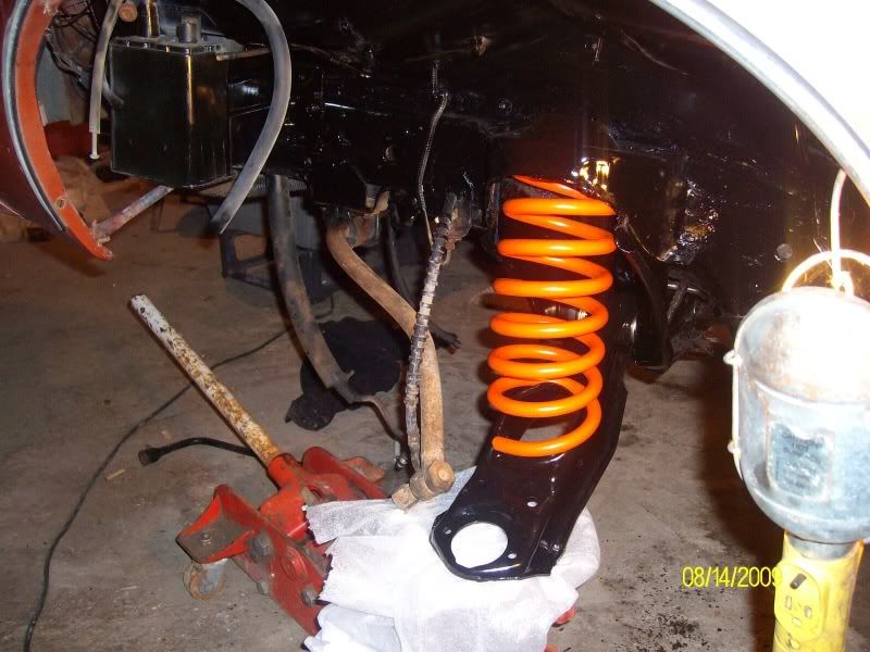

Orange spring set in place
A Arm installed....sans new nuts >:(
A Arms installed
Now I just wait for ball joints!

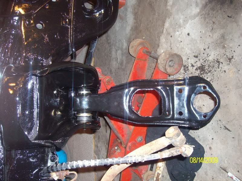

Well, the parts are all assembled now.  Pressing the bushings in was a pain in the arse!
TIP: For those who decide to undergo this project, learn from my mistakes, and follow these tips.....
1. Dissasemble the bushings.  There are 3 parts to each bushing - an outer shell, the neoprene bushing, and the inner sleeve.  Simply hold the shell in your hand, and tap the bushing/sleeve out with a rubber mallet.  The lowersare a tad difficult, but its worth your trouble.
2. Start the upper sleves both, insert the cross rod, put several large washers on, and then the nuts on the outside.  Tighten the nuts up to draw the shells into the A Arm - but dont ovr do it.  Once started, they will drive n with a brass hammer just fine.
3.When you insert the cross rod, make sure that the textured surface that mates up against the A Arm frame mount is down when the bend of th cross rod is pointed inwards.
4. The lowers should be pressed in with a hydralic press.  If you do not have one, a shop will do it for you for around $25 - money well spent.  When pressing the bushings in, cut a peice of scrap steel to fit inside the control arm to keep it from colapsing.
5. Insert bushings and reassemble!
I only have the drivers side painted, so assembly this evening consists of just that side.  I also forgot to get new nuts for the A Arm mounting bolts....uuurg!  Project for tommorrow.

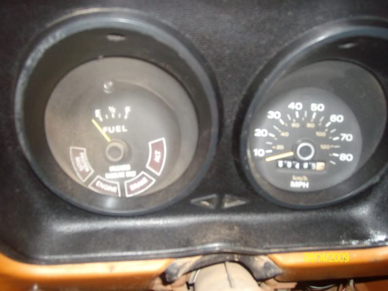

Well, I just bought a Rally gauge pack for (what I think) is cheap.  The seller misspelled gauge and rally....so I dont think most buyers saw it...  Even comes with wiring harness and 3 gauge.....I mean guage cluster!
http://cgi.ebay.com/ebaymotors/ws/eBayISAPI.dll?ViewItem&item=320414079269&ssPageName=STRK:MEWAX:IT

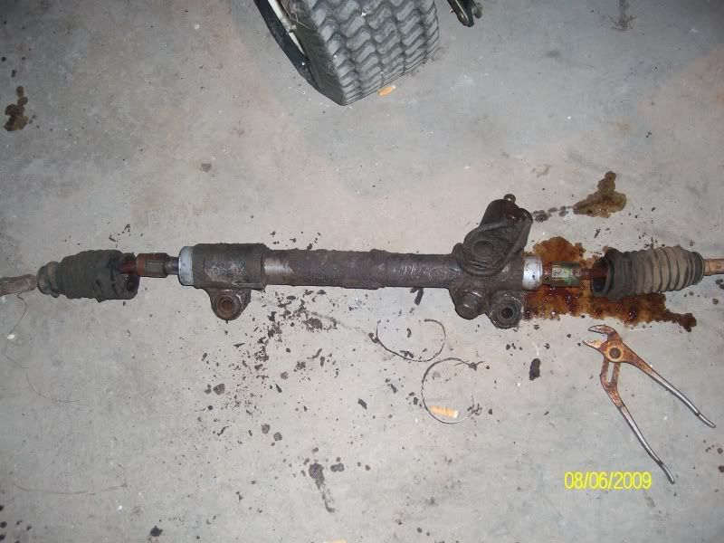

Back to the rack thing....well, it threw up on the floor.  I'm thinking its time for a new one!
I was also digging around inside the car, and after reading some posts on what the plastic behind/that holds the gauges tends to do, I looked a bit closer......
It is apparent to me that my plastic has long by taken it final resting....I did find a ralley gauauge cluster, with the 3 seperate gauges....but that plastic appears to be pretty far gone....so Im looking for ideas on this one for the future!

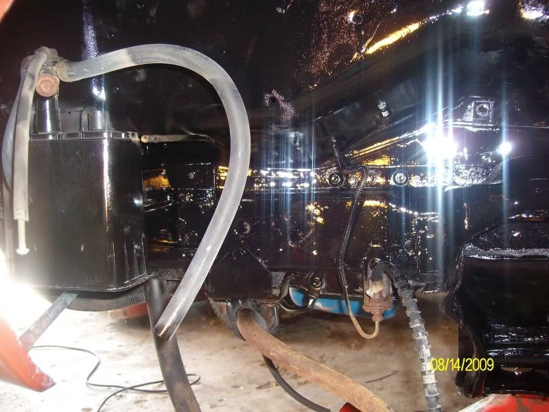

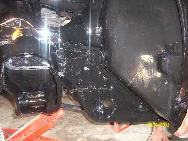

I laid on the ground, and pressure washed the entire bare front end.  Heres what I ended up with.
I decided to go with a know epoxy paint.  I used it on my horse trailer, and t has held up well.  I pay quite dearly for it....but its well worth it!  Here is what I ended up with on the drivers side fenderwell.  Its so shiney, its hard to look at.  And BTW, the runs are original - not from me!

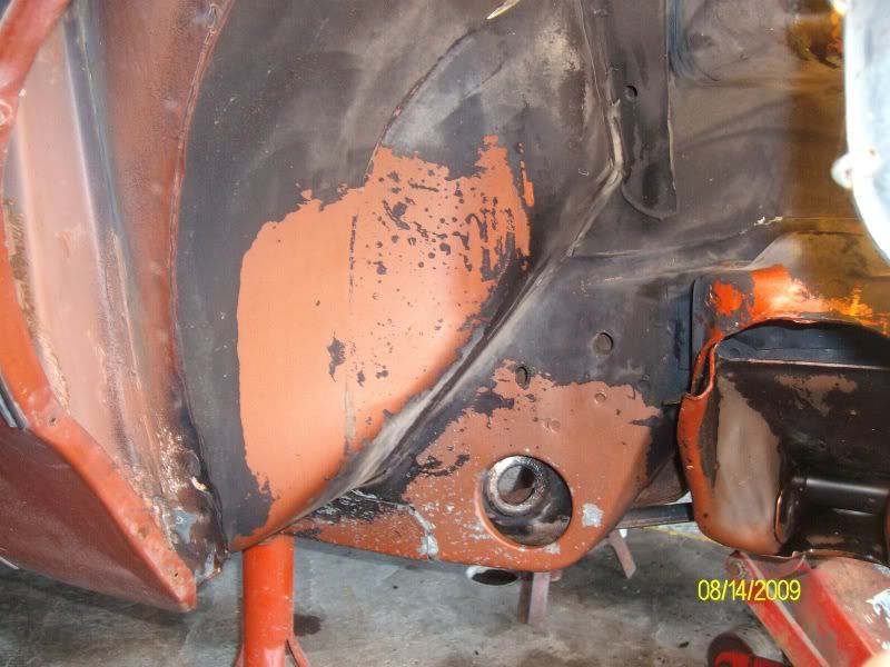

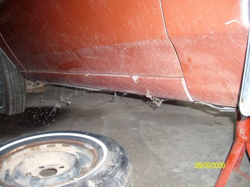

Thought Id throw some pics up of the rockers....like I said she's rust freeeee!
What a cute little V6

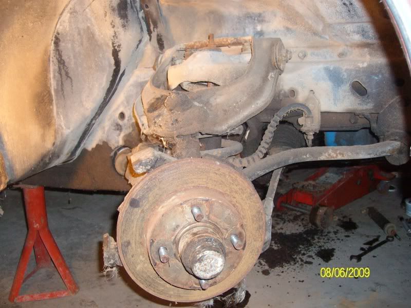

ANYways.  Got to dissassemble the left suspention
And get a good start on the passenger side.

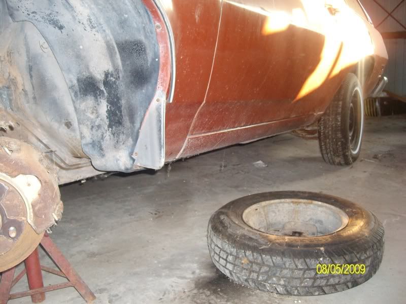

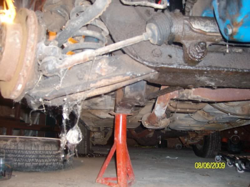

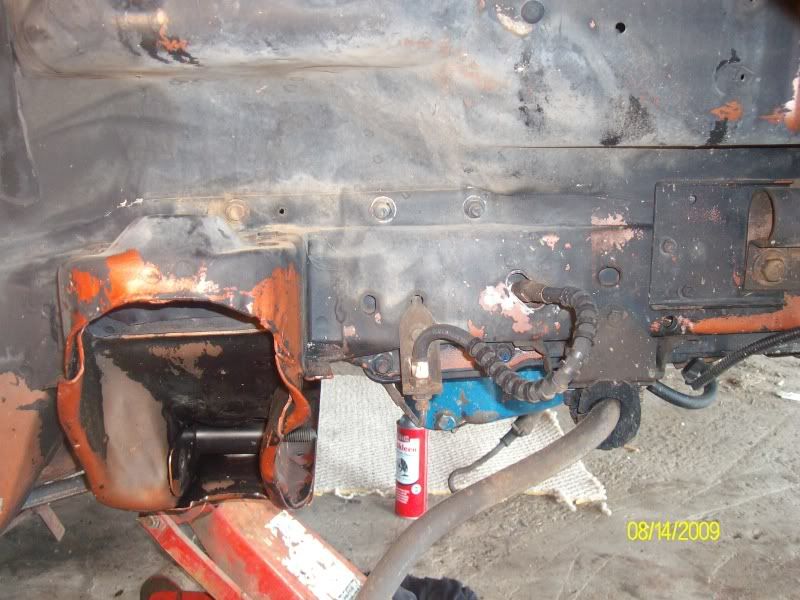

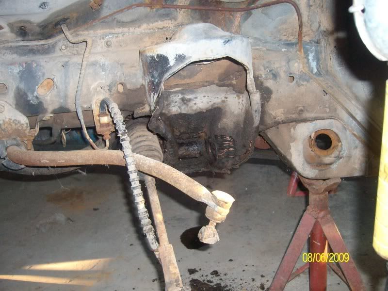

As we began the disassembly, we started to run across problems - all recitifiable - but issues.  The wheel bearing grease came out in one lump chunk....on both wheels.  The passenger brake line was hand tight.  All of the ball joints are junk.  Both of the inner tie rod ends have at MINIMUM 1/2" of play in them....so Im glad I ordered new of everything.  I will say this, thogh - its nice working on a rust free car, all the bolts come loose, nothing is froze tight, ect.
The downfall - everything is covered in 1/2" of caked grease / sand mixture.  After everything was removed and stripped, I started cleaning underneith (pics hopefully tommorrow)
I pulled the rack to change the inner tie rod ends and to clean the cross memeber, and in doing so, I found power steering fluid in the drivers side dust boot......Im assuming thats not good - info is appreciated, but Im gonna check around tommorrow.
