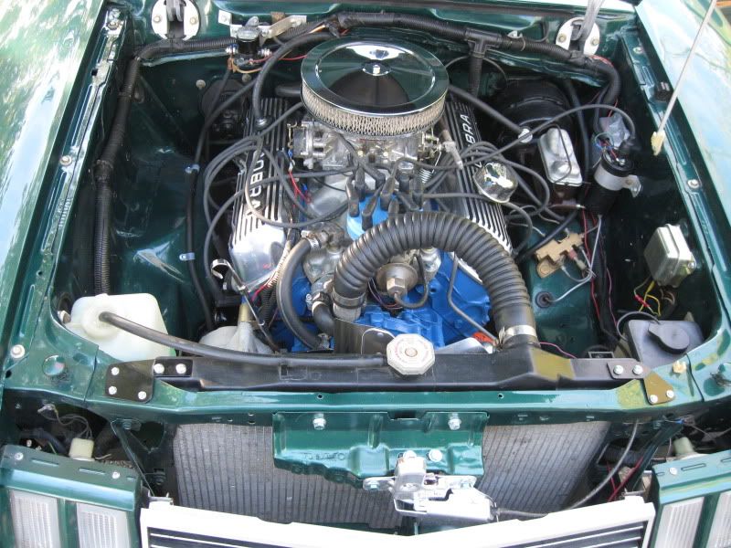

That is one one sweet looking Pinto. Need to see the engine bay  :tgif:
289pinto

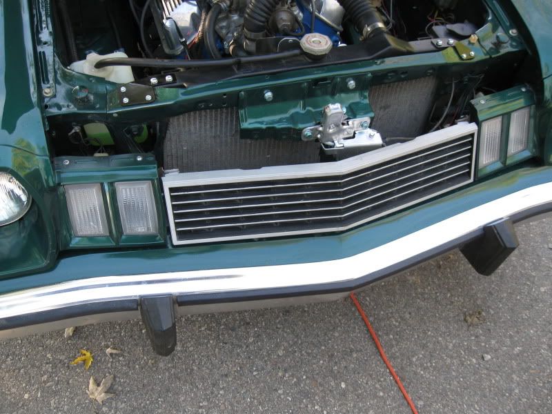

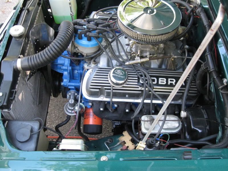

All my cooling issues are solved! Had the wrong intake gasket on the engine and it started to leak. Now I find out that I can't get the car to charge unless I unplug the voltage regulator and run a jumper wire on the plug. Weird but at least it's charging now. Putting the car in another show on the 10th! Hopefully I'll win something! If not it's still fun to enter it in shows! More pics to come!

Just finished up installing a dodge dakota radiator, still having some cooling issues though. I think all it is a thermostat sticking because two days ago I drove about 25 miles and didn't have a problem but yesterday it decided to piss out fluid I think from the water neck. I have one of those made in china chrome water necks on the engine with a tiny little o-ring and I think the thermostat sticks and it shoots the fluid out behind the neck. Going to put a good water neck on it and a fail-safe thermostat today and hope for the best! I'll post some pics of the radiator, turned out great!

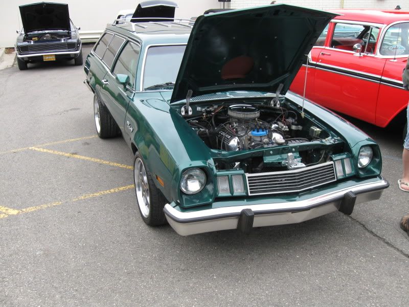

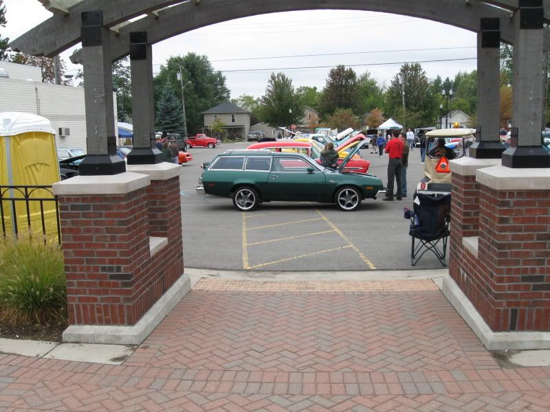

A couple from the show. Thought I had more but I guess not.
It was funny, My car was the first one anyone would see walking into the place. Couldn't beat that!

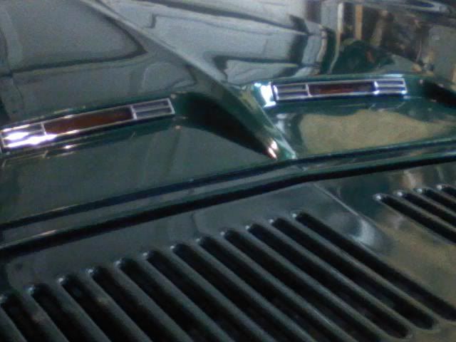

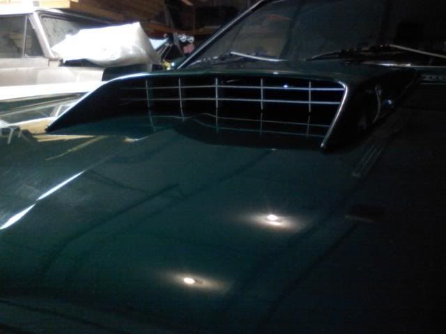

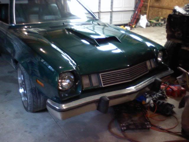

Got a few things done last night, put the blinkers in the hood scoop and the front grill in the hood scoop. It's an original ford factory scoop from mustangs and torinos and who knows what else. Looks like it came from the factory on my pinto!
1978 Pinto wagon, 289, 8" rear, 17" cobra R rims
