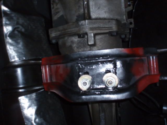

Definitely.  I used an automatic trans crossmember (1973) to install my T-5.  Reversed front to back and then slotted the holes all the way to the rear.  I even used the C-4 mount (rubber and bracket to the trans) as well. It is a round rubber piece that sits at an angle.
Tom
turbo74pinto
it looks like you modified the "straight" side of the crossmember dholvrsn.  take a look at my pic above.  i modified for the "humped" side of the crossmember.  i think mine may be in backwards like carolina boy said.  it works great and little mods had to be done.  keep in mind i also used a stick crossmember.  i think the autos are the same.

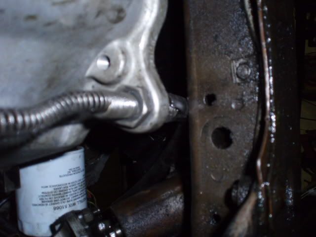

To add a few things.  While likely not impossible, the hydraulic setup (at least as it is in the Turbo Coupe) is NOT the way to go.  Get yourself a cable bellhousing if needed.  Most likely it will be the bell crank variety.  On my '73 there were crossmember to cable issues.  I used a piece of steel to offset the cable. The picture should be self explanatory.

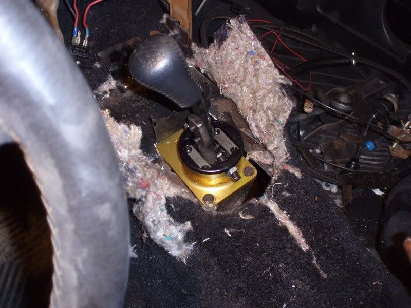

  I don't know your build.  I'm 6 foot and and found the stock shifter a L-O-N-G reach.  I added a plate to extend it rearward.  You will have to see how you fit when done.

crossmember is a pinto and MOUNT is mustang.  youll also have to cut your floor because the shifter sits about 2 inches closer to the front with a t-5

here are a couple pics. in the pic of the crossmember, the bottom of the pic is towards the back of the car.  the other pic is showing the clutch cable.  you can see its touching the crossmember.  it isnt binding but a "U" or "V" notch should be put there for clearance.
bob
turbo74pinto
use your pinto crossmember.  install it with the "hump" facing the back of the car.  im pretty sure thats backwards like carolina boy said but to be honest, i dont remember for sure anymore.  the 2 mounting holes will have to be elongated to the rear of the car.  dont remember how far.  pretty much as far as you can go with room for washers and bolts.  i used fat fender washers and ground down one side to fit, so the washers look like "D".  they also had to be ground just a tad to the outside of the car.  i used a regular 87 ford mustang stick shift tranny mount.
