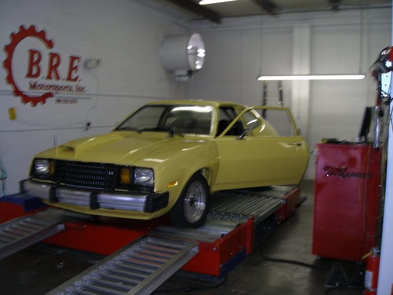

Turbo Toy
I finally got the Turbo Toy Pinto put back together with all the mods and put it on the dyno for final tuning this past weekend. I was pleasently surprised to say the least. I wanted to keep a conservative tune, so I wouldn't be killing a lot of parts and at the same time have a strong running car. I hate compromises, but I hate blowing up motors even more. With the Pinto on the dyno ( BRE Motorsports, Concord NC. ) and Wes Kiser on the lap top doing the tuning, it put down 420 HP to the rear wheels. The best part of this, is that it's running on 92 octane pump gas, 22* of timing and only 25# of boost. That is a very safe, conservative tune and I can run pump gas from any station in the country for daily driving and my occasional trips to the track. We feel that on good racing gas (C16), around 28* timing and 32 to 35# of boost, she should be good for 500 plus HP. Not too shabby for a daily driver. It feels great to have it back on the road and driving it every day again.
