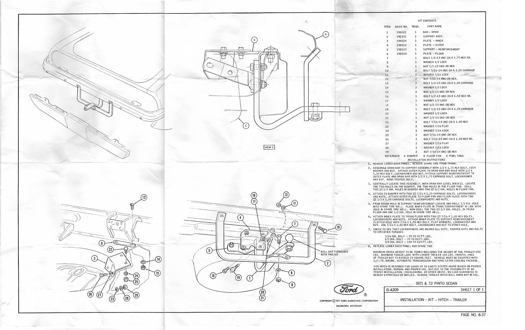

 ???  Hmmm.  Looks like photobucket resized everything.  Argh.  Send me a PM and I will e-mail you the full resolution jpeg.  It is about 3.5 megs.
I will work on resizing the scan and getting it posted somewhere for direct download.
Reed
Here is a lnk to a scan of the instructions.  It is a 17x11 sheet so I had to scan it in sections and paste it together.  I did it in three resolutions: full, 150 DPI, 100 DPI.  The lower the number the smaller the file, but the 100 DPI looks pretty chunky.  All of them are larger than 100KB so I can't attach it to this post, but you can download the picture from the link.
Full resolution:  http://img.photobucket.com/albums/v484/slantsixgoon/Pinto/hitchinstructions.jpg
150 DPI:  http://img.photobucket.com/albums/v484/slantsixgoon/Pinto/hitchinstructions150.jpg
100 DPI:  http://img.photobucket.com/albums/v484/slantsixgoon/Pinto/hitchinstructions100.jpg
I won't have any picture of it installed for a bit since I am waiting to install it until after I replace my bumper.
Enjoy!

The only thing I don't like about it is I have to drill holes in the bumper and trunk pan to install it. :(  Otherwise, it looks good.
I don't know how useful this item ever was though.  Max trailer weight (including the trailer itself) is 800 pounds.  Max tongue weight is only 100 pounds!   :lol:  Can't really haul a travel trailer or a utility trailer with it.  But i guess i could hitch up my 4x8 Harbor Freight trailer and haul loads to the dump.

I got a N.O.S. Ford trailer hitch kit off of eBay for my 71 Pinto.  The instructions say it fits the 71-72 Pinto sedans.  It is complete except for the ball and the wiring, but I don't think it ever had any wiring because the instructions don't mention it.
If anyone wants and pictures or a scan of the instructions for reproductions purposes let me know.
