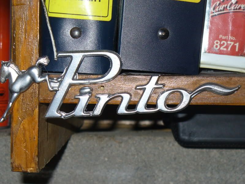

As promised, here's the pic of the emblem that was all nasty & pitted when I pulled it off the 78 I used to have.
I'll get a pic of the one I spray painted with chrome spray, so you can see the result of it.

Chrome spray paint makes the wmblem look better. On my first Pinto I kept the old, pitted emblem just because I liked it, but it was too nasty to put on a car. Anyways, I got bored one day & wanted to personalize my work area with some emblems for cars I have, so I sprayed the old Pinto emblem up in Chrome spray paint. It's not perfect, but it looks better than it did, and gives my car repair book shelf some Pinto class. I can take a pic & post it if you like.
