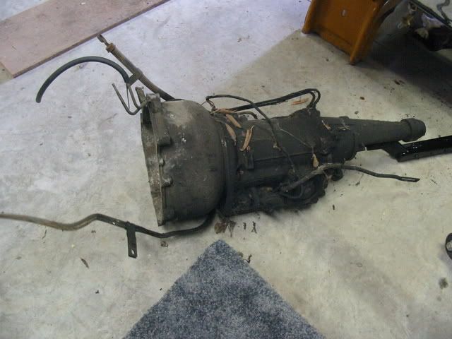

Last week we pulled the transmission and have set to doing a rebuild with a B&M rebuild kit.

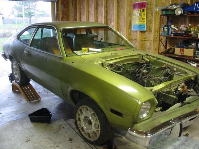

We now have the back end raised up.
We took out the stock exhaust.
And next we plan to drop the gas tank.

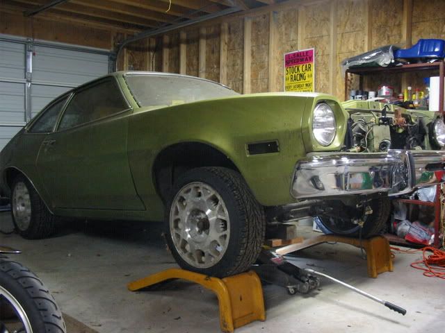

In other news, we have discovered that the T-bird rims themselves rub against the upper control arm.  We are considering using spacers or picking up some tubular control arms.  Has anyone else encountered this before, and if so how did you deal with it?

Here my Pinto sits on it's borrowed wheels and new tires.
The wheels came off of a 1988 T-Bird Turbo Coupe (engine donor car).  The tires are size 205/45/16 in the front and 205/50/16 in the back.  We won't know until the motor is in, but the front looks like they will just barely clear (I'm thinking that stiffening up the suspension should help).  The back has a little less then a half inch from the sidewall rubbing the bottom lip of the body/frame.

Okay, here's a few more pics and an update.
In one of the pics you'll see the front tire flat.  This has been replaced with one that holds air so we can move the car around.
The stock motor will be coming out hopefully before Monday.  When it's out, I will notify Pintony and he can come get it.
We decided to keep the Auto-trans instead of switching to the manual.  It's a C-4 and from what I'm told, a very versatile trans.
After the motor and trans are out, we will be tackling the surface rust with sand paper and primer to keep it from getting worse over the time it takes before the car goes to have it's proper paint job.
During that time, the trans will go to my auto-technician friend who will be looking it over and rebuilding it if necessary.
