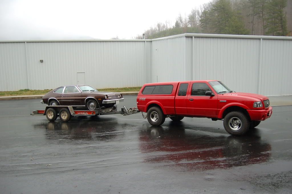

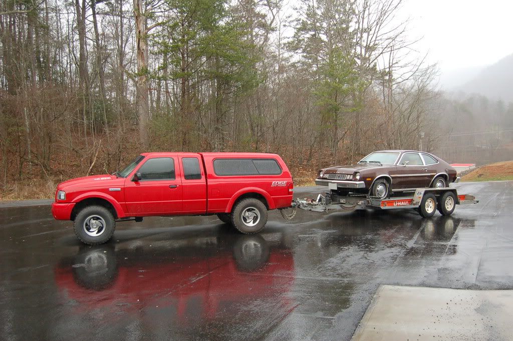

Quote from: jimspinto on March 30, 2008, 12:47:10 PM
   Will you please advise the cost of the "U-Haul Trailer"   I'm sure everyone will be surprised at the cost of a trailer rentail [vrs] a "Flatbed Tow Truck"
   If I remember correctly, I paid about $80.00 for a tow truck [towed about 30 miles]  And when I think about the time and etc.  rentail doesnt seem to be a good idea.  But I never looked into the cost.  Now I wonder  So, please tell about cost of rentail
Best as always,,,,,,,,,,,,  Jim at  jimspinto
I just rented a uhaul  this weekend  an  it was just under $60  for in town  one day rental(24 hrs)  But i had to travel 30 + miles to pick it  up an then  took it out of state  to get a car . All total i had the trailer for about  13 hrs and 450 miles   just returned it to uhaul after hours. also had to take it back to the dealed i picked up from ot it would have been $120 or to pick it up where the car was  and drop off in my town   it would have been  $169.  go figure  all the differences. it was the local uhaul dealer who told me to  use it that way
The light did not come on at all.
My friend knows a ton about cars, recently just over hauled/redid a 70's Camaro, and he will be guiding me or doing most of the work, and I will soak up all the knowledge I can.
The U-haul trailer cost around $53 for a day, I had it less than 2hours and went less than 20 miles with it.
Thanks for the help. I am ready to take it out on the road again, as frustrating as this car gets I still love to drive it. And I will miss it if I can ever get it sold.
