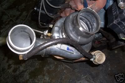

Even though I'm working on a bunch of other projects, I am in the middle of rebuilding a turbo 2.3 motor that I would like to drop in the pinto. Powered by a megasquirt ecu for the electronics and a holset hx35 turbo for boost. Will be mated to a T5 or C4 tranny that I have as well...
