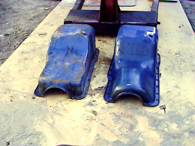

could you send a pic of the front of the oil pans.Does the mustang slop not stright in the front
RSM
I thought it might have been a Mustang II 302 pan. Thanks anyways.

The sway bar won't fit with the V8 in a Pinto. I had to remove mine on my 80 wagon.
fordpower
mine looks like the one on the left flat in back.Must be I have to go further and redo the mounts.Just seems I wont have room to change the plug.Oh well winter project any how thanks
Mustang II uses a different front sump pan then most normal front sump pans.
http://www.geocities.ws/frdsford/sidebysidepans1.jpg One on the right is a Mustang II Pan.
fordpower
my 302 has a front sump oil pan. Is a mustang 2 different. No way with mine can I get low enough and clear the sway bar.If I go back much further back won't beable  to cnange the left spark plug.
