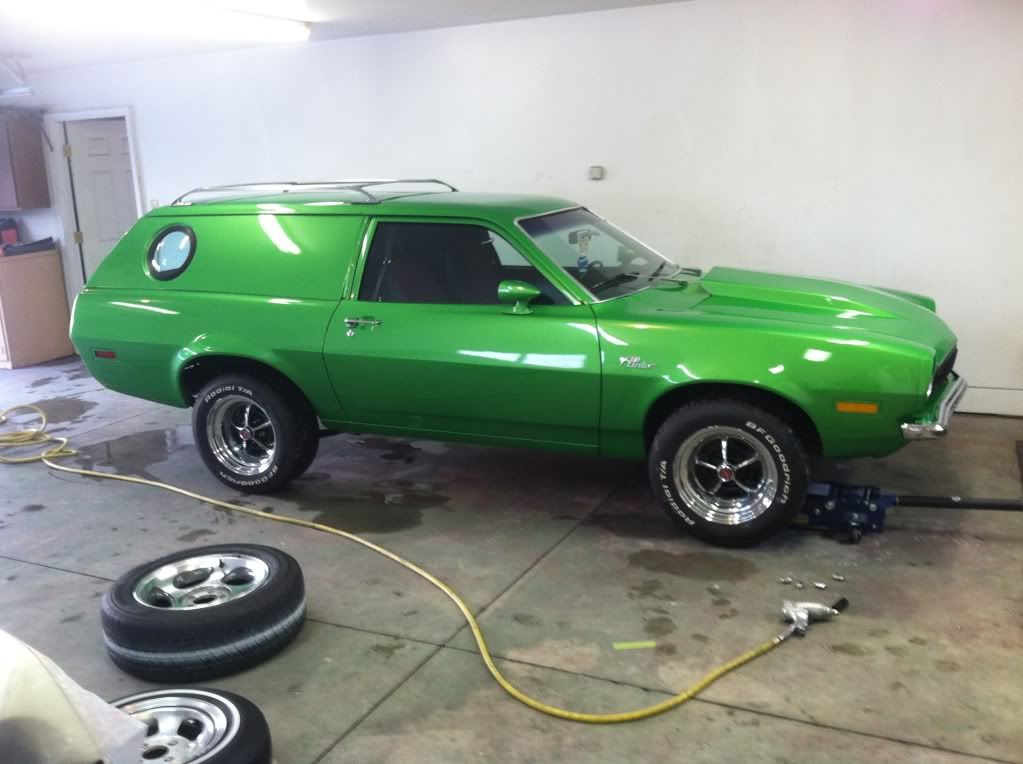

got wheels for it (17X8's +30mm) and finished the interior up mostly. thats about it for now. the wheels i hit right on for backspacing. I ended up having to run 1/4 inch spacers in the back with my narrowed explorer axel and none in the front after the 5 lug rotors. The tires in the front are 205/40/17 and in the back 225 something. they are old ones and they were free!

Just wanted to know if anybody had experience with cobra r rims on the front. I wanted 17X8's with 5.68" of backspacing an 1/2" spacers. Anybody know if this will work fine without rubbing?
