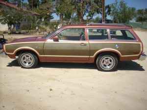

DaleFortune
You guys are great!  I'll be calling Sherwood pick-n-pull.  Here's the Pinto Wagon I bought last week.
