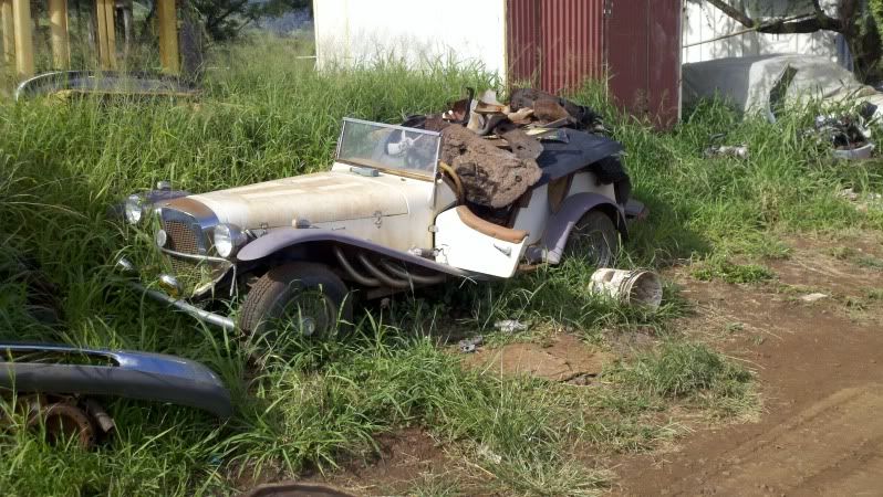

Quote from: sedandelivery on March 20, 2011, 07:29:52 AM
That roadster in your picture I think is an Excaliber kit car and most of them have Pinto running gear. Might be something there for you.
Those kit cars were built using various compact cars of the day, but it certainly couldn't hurt to have a look/see.  There just might be a Pinto lurking under all that!
sedandelivery

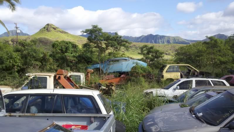

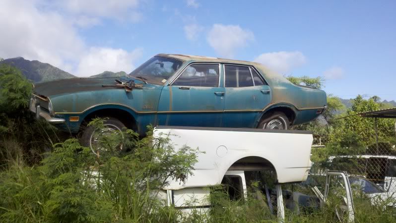

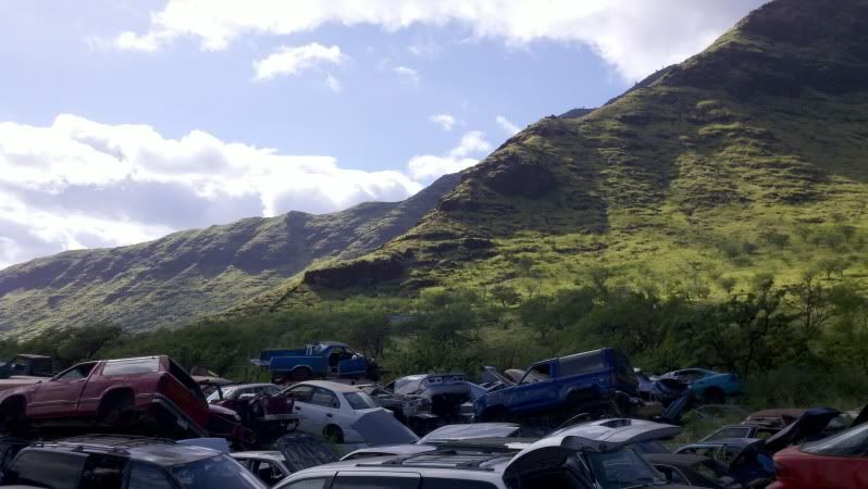

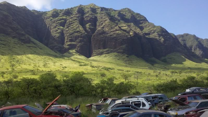

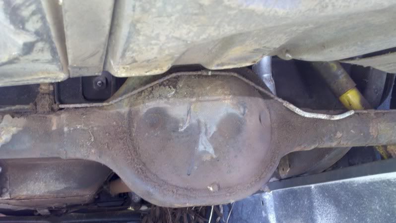

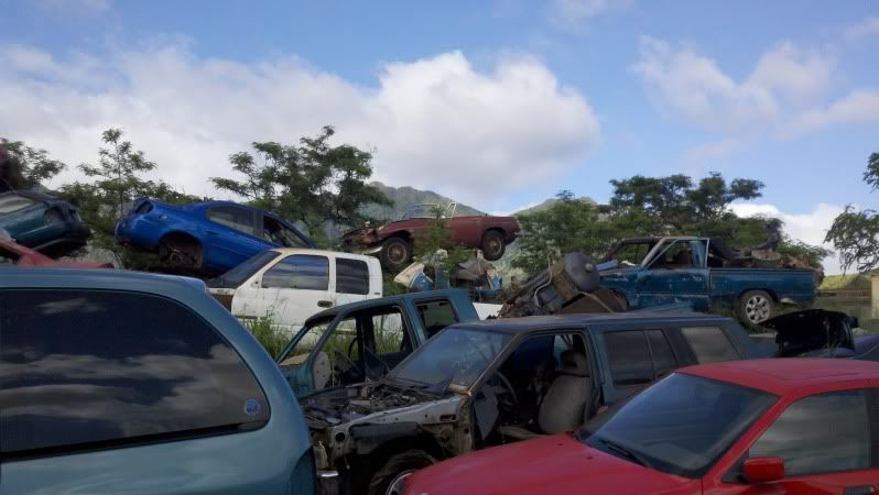

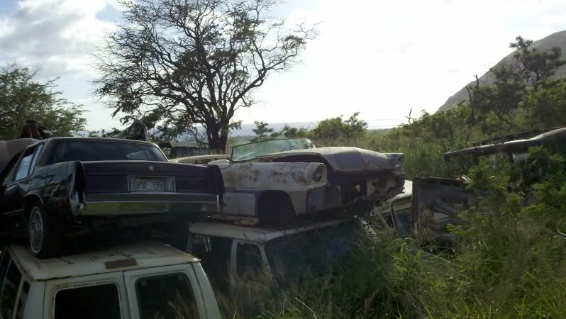

well i found a junkyard that had a small number of pre 80's cars still on the property.
thought i'd post a few pictures of my friday afternoon :)
and this last picture is the best one... or at least, the closest thing to a parts car for my 76 Shelly on the entire island :(
yep. a 1972 ford maverick.
i had a hard time getting a good look at the car considering where it was perched... but i know its has an 8" rear end.
only thing is that i really dont want to put a different bolt pattern on the rear end of shelly.. i paid quite a pretty penny for some custom 4x4.25 patterned wheels...
not to mention the guy who runs the lot wanted an outrageous $300 for a used rear end!! what a thief!
anyone know if i can just slip the axles from the 6 1/4" rear end into the 8"? that seems like it would be too good to be true  :'(
