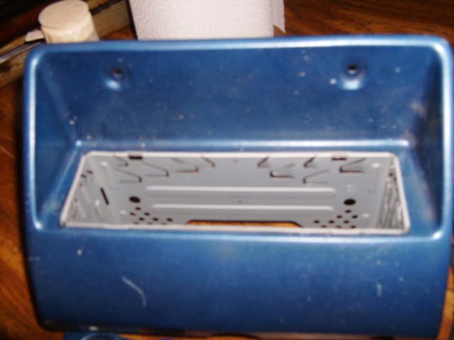

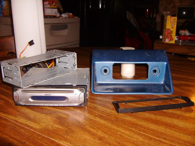

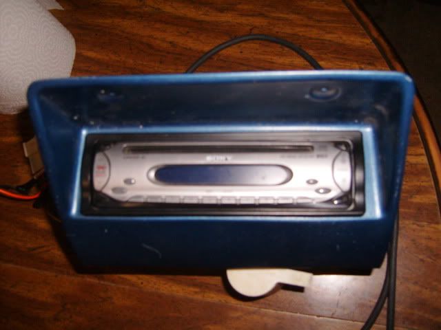

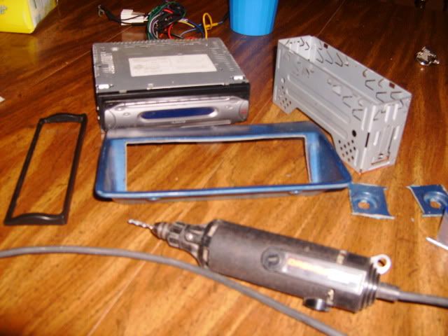

Alright. After supper I got the old dremel out. I cut away first the inner lines wich was just basically the knob holes on both ends. Then I filed it away until the metal cage fit snugly. Then I chucked in a drill bit into the dremel and beveled the edges to soften them and rough them up to take paint better. Here are three shots in a row to show the work and how well it fits and what it looks like with the radio in. Next step, lightly scuff the plastic so I can prime it with Duplicolor automotive primer. My favorite for canned paint. Thanks.

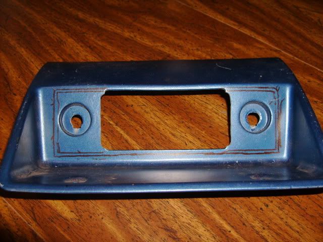

Alright, here we go. Step number one. Trace out the instalation box. In the photo you see two sets of lines. LOL. I began by drawing the out side one. This I could get the marker tip right up against. However, on the top side of the bezel, I could not get the marker in. So I reserved to tracing out the inside. However, I could not get the tip right up against the cage. So I went back and drew in the remainder of the outside line by hand. I will start by cutting it out from the inside line out until I am happy with the fit. I will be cutting the bezel with a dremal tool with a cut out piece. Since I am used to doing this kind of thing working with hacking up plastic model cars, I know from exsperience that the plastic can get hot and put out fumes. So, if you are concerned with such things, I would suggest wearing a paper 3M face mask. I have been around paints and stains many years and the smell does not effect me. So onward I go. LOL. Updates as I complete them. Thanks.
