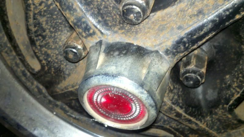

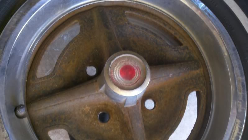

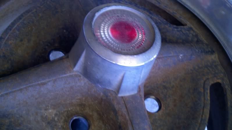

heres some pics of the 2 caps i have.
2 pics per cap
*BANG*
"What was that!?"
'... Speed bump?'
1993 camaro (6cyl)
Well I already have a set for my 78. I spent a good $60 repainting them to the original black color with silver "spokes" and "slots". The only problem I run into with them is the center caps. I lost one on the freeway last year, as the chrome cap flew off the metal clip!
I was wondering if you would be interested in selling the caps if they are in decent shape. I am still trying to figure a way of restoring them. I have three or four spare caps in storage but the red has faded/flaked away and they look mostly silver in the center.
I have four nice caps that I use on the car (I only use these wheels in the summer), but the one that I replaced has oxidized and dull chrome while the other three are nice and bright.

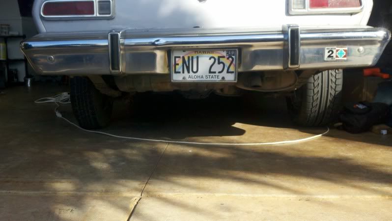

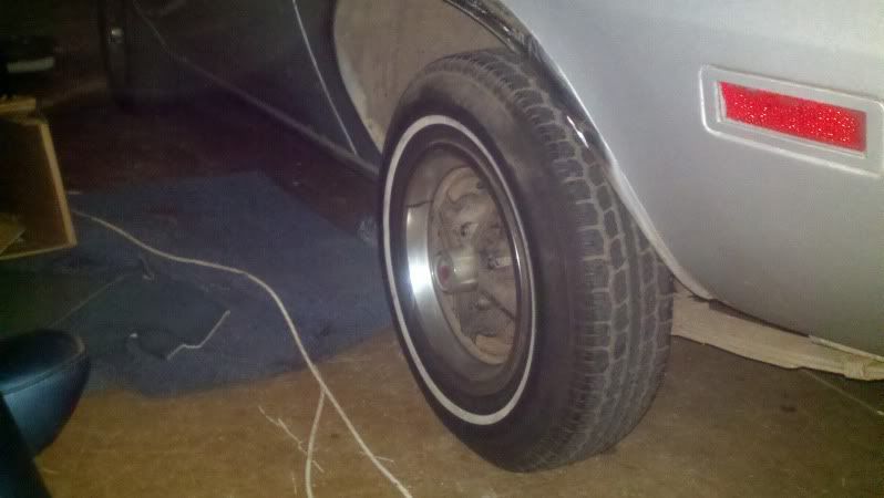

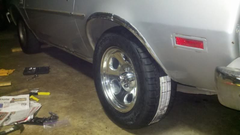

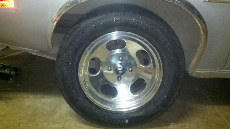

so. after much frustration and $$$ thrown away, i decided to just try and get the new wheels set up with tires.
so after careful measuring, measuring some more, and more measuring; i found a good size tire that fits on the 15x7 wheel in the rear wells with no rubbing whatsoever.
225/60R15's for the rear. still measuring front clearences
old rear wheel and tire;
new wheel and tire;
look at the stance difference hahaha

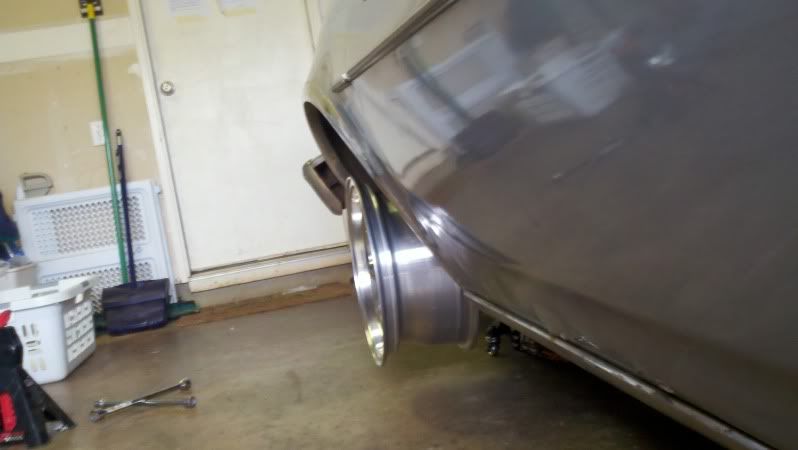

Jippah
ok update...
the hubcentric spacers do NOT fit on the standard pinto hub.
turns out, that .1mm difference is quite a hiccup, getting the center bore of the spacers machined down .1mm so they fit properly.
HOWEVER, the center bore on the wheels 72.56mm. so hubcentric rings are required.
RECAP;
Pinto Hub                                - 63.5mm
Hubcentric spacers center bore - 63.4mm
Hubcentric spacers outer bore   - ? ? ? ?
Ansen Sprint Center Bore          - 72.56mm
hope someone else benefits from my frustrating, time consuming finds  :mad:

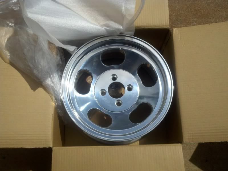

Ummmm, you will put some rubber on those before you lower the car, right?  :lol:
OMG those are beautiful!! How in the world did you find those? Incredible.
Jippah
It only took about 2 and a half weeks to get here too!  :mad:
i called the company and they said it was taking so long because they actually had to cut the wheels from a set of blanks due to the "strange bolt pattern" haha!
... and they had to be shipped half way across the Pacific  :rolleye:
15x7 Vintage Ansen's!!!
anyhow, here they are!
