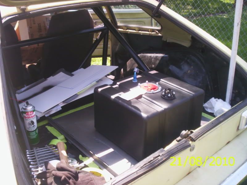

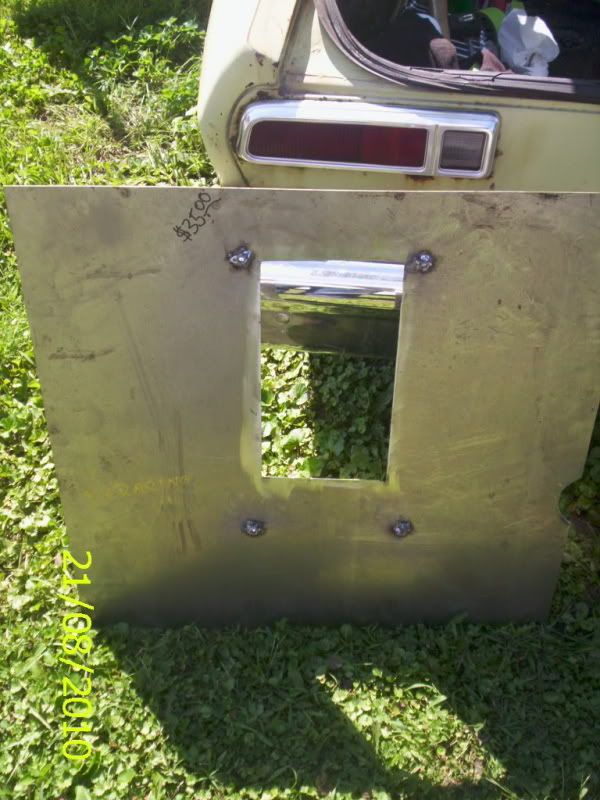

Back in the saddle again and working on the Pinto though at a very reduced pace.   This radiation stuff really kills all your momentum.
As last noted I had cut out the corners on the 16 gauge base plate and then took it up my buddy's shop where he cut out the sump hole.  We discussed it and we came to the conclusion that the hole would be too tight around the sump and just recut it a "tad" large.  Scientific measurement.... :read:
I brought it home and placed 4 stacks of car mags to get the base plate up enough and I dropped in the fuel cell.  I then placed the hold down clamps in place and marked where i needed to drill the holes for the bolts.  I drilled the holes {thank the person who invented the uni-bit] and went and got bolts, lock washers, regular washers and nuts.  We welded the washers and nuts to the underside of the base plate.  Reason for the regular washers was to spread out the pulling load from the clamps.  This is what you see in the first picture.
The next step is to create and place under the base plate are two bridge supports just to be sure that there is no movement while going down the road.  All of this is fitted into the spare tire well.
This pickture just shows the fuel cell sitting in place.
Got a lot more to do but you get the picture.  Also for those of you concerned with the cell just sitting there, it will be surrounded by a steel cage and aluminum sheet sealing it from the passenger compartment and adding another level of protection.
peace
