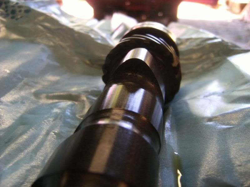

This shop reground my 2.8 cam for me. This is all they do are custom grinds. Very nice place to do business with, they work with your old shaft, you send them yours, they grind it to your specs (or tell them what you are looking for) and they will grind, then mail you your cam back. (they also grind lifters to match the cam) check them out.
here is a pic of my grind.
http://i109.photobucket.com/albums/n69/ru_ready_4_r_n_r/regroundprofile.jpg
http://i109.photobucket.com/albums/n69/ru_ready_4_r_n_r/reground.jpg
