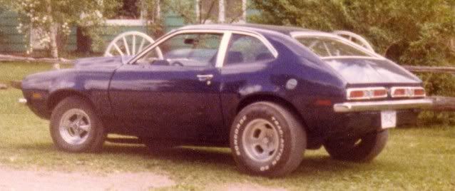

Had air shocks in this car:
Cheap way to keep the body off of the tires.
All I can remember is they were yellow ? Don't remember the make (hey, it was the 70s !).
All I did was measure the stroke of the original shocks and it turned out Mustang shocks were the same.
Had minimum pressure in them: Pintos are light !
