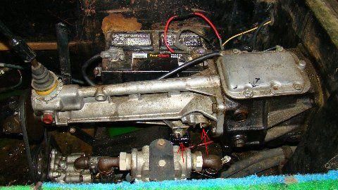

With what looks like a six bolt aluminum top cover, I'd say this is the english version from behind a 1600 kent engine. What is it mated to here? Be sure to put a little sealer around that core plug. JT
i was thinking the same thing.  my old brain tells me that the german trans had a formed sheet steel cover and, correct me if i'm wrong, isn't the speedo drive on the german trans on the 'drivers' side of the case?
72 pair is right, that is not the german built trans but the english version. I would fill it with silicone or JB weld.

grab that little shaft with a pair of vise-grips and pull, the whole thing should pop out. Without a tag I don't know how to ID the trans, they were all basicly the same, just different first & second gear ratio.

That is the german built 4 speed Pinto trans. The fluid is coming out of whats left of the speedo cable. You could put silicone there to fill up the hole, there should be a metal clip there to hold it in. Looks like the bolt hole has been filled in. (upper left of your second pic) I would just tap a freeze plug in there and be done with it.

this is what I have. Not sure if it's a 79 pinto  Jim

New guy with an oil leak. OK,this is the deal. I have  a pinto transmission  I think in a snow cat. The speedometer is not used  and it is leaking out of the spedometer cable connection on the transmission  and  the oil  has rotted out most of the transmission mount below it. Is it hard to get the parts? will napa have them?
