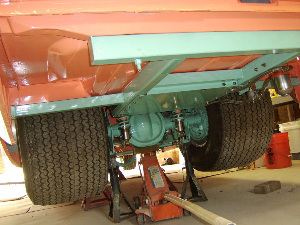

well, the new rear is done and i just have to install it tonight. what i ended up with is 8.8 3.55 gears, kevlar clutch pack, 04 cobra posi unit(its physically larger than a standard posi housing), new spider gears, new bearings and seals, welded tubes and a smoothed and painted housing with new perches.... im ready to get it back on the road.!!! oh yeah, new pp, clutch, flywheel, tranny, short throw shifter,  a little more of a tune on it and a head being done also......im gettin real close to the point of taking it to the track to get some baseline #s before the new engine goes in..... :devil:
