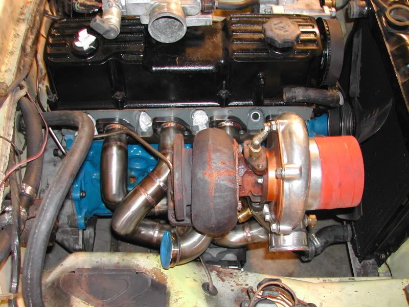

STR, I am using a 3" down pipe to a 3" flex joint, (to help keep the header from cracking) and a Magnaflow 3" oval race muffler dumped before the rear end, I also have the wastegate piped into the down piep, (I know it cost some HP but I didn't want the loud/open wategate sound.

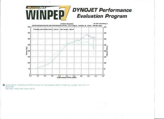

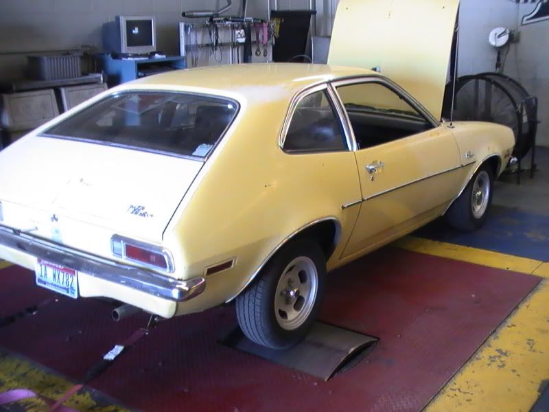

I put it on the dyno, the little pinto did ok, could not get it to hook on the dyno after 5k RPM, even with a guy sitting on the lip of the trunk, so the dyno really isn't truthful, it's low, 342 whp @ 6300rpm and 282 ft lbs @ 6300 rpm. now that I  have it tuned ok, I have to get after the suspension those little stock tires just aren't cutting it

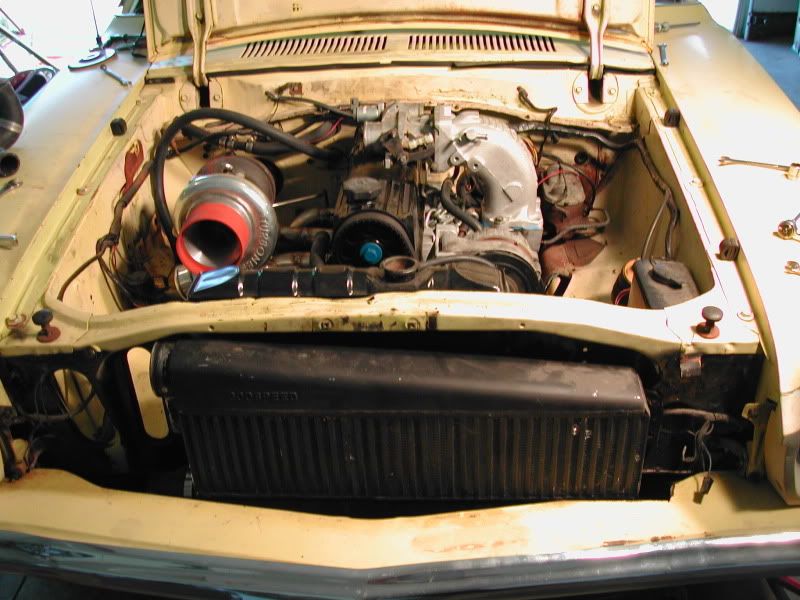

I haven't given an update in some time, so here's one, the pinto is up and running with an Electromotive TecGT ECU, not
Fully tuned and I have not back half'd the car yet, but at 13lbs boost the thing flat rips, I'm going to add more boost and do some fine tuning then throw it on the dyno and check number,

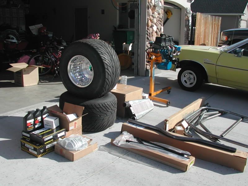

Oh my what a beautiful pile of parts.  :amazed: That looks like to much fun. Good luck with the project send lots pics.
very envous your gonna have all the fun. Where is all this taking place at?
fast64ranchero

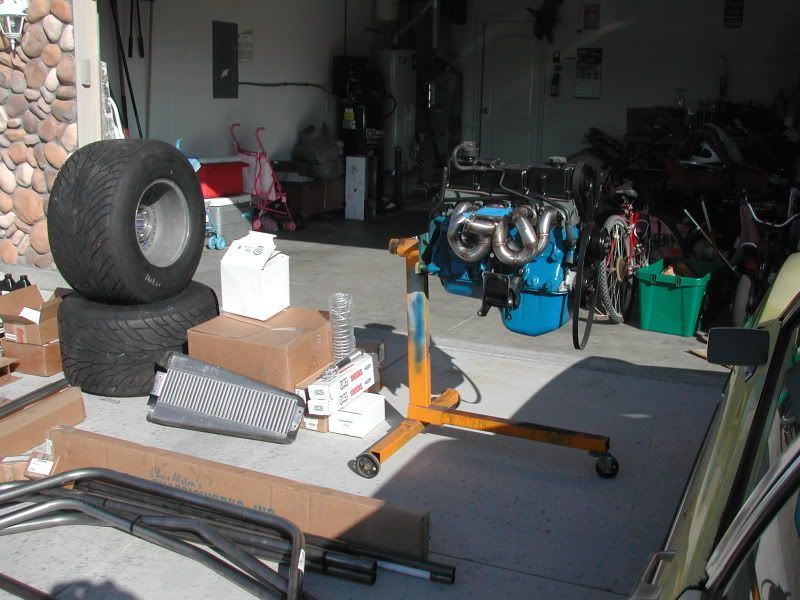

Well I've started the transformation, powered by a turbo 2.3 w/Bo port stage 3 head, cam, header, 31x16x15 tires 8.8 rear end 12 point cage, ladder bars,
everything is getting mocked up right now, after that I'll pull it out and paint the engine bay, wire it up for EFI and test drive it, after that I'll do the rear...
