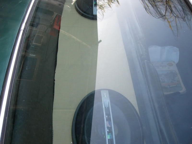

I just recently made me a cut out, out of cardboard. It isn't perfect but it filled in the back. I actually got lazy though and just did it "hit and miss" with the cutting. What I should have done, and what you can do to make a template is..... Go to a butcher or a grocery store meat cutter and ask them for about 6 feet (may be a bit much, better safe then sorry) of their butcher paper. Then take that home and proceed to push it into the deck area. Take a pencil and carefully trace the seems where the paper meets the walls of the car (should have been pushed into the walls having your fingers in between the top and bottom of the paper kinda makeing a seem per say). Then take it all out and cut your pencil traced area a little bigger then where the pencil mark is. Then of coarse you would just take the cut out piece and put it back in the deck area and do the final cuts!!
Hope that wasn't to confusing. I got the idea when the dash pad makers did that for my PT Cruisers dash. It was the first car they had like that so they had to make a template!!
Here's a pic of my not so good cardboard.
I was going to cover it with some type of material, but I didn't care for how it came out and decided to just use it as a temp fix until I can get some butcher paper and do it right!!!  ;D
