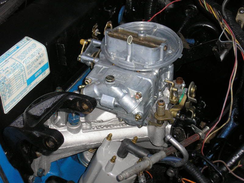

It looks like a holly carb to me, and not the stock one. If you need the origanal rebuilt P.M. me.

I take it the 'shrapnel' you're referring to is the preheater that has a 2" diameter hole for a hose that goes to the bottom of the 'leg' off the stock aircleaner. If your car is 'breathing' cold air it may affect emissions. I live in an area where smog isn't required but my car is pretty original and complete, so I'm planning to keep it that way. Your car should have had a Holley 5200 carburetor, it looks a lot like a weber.
In the second picture you can see the 2" hose I'm talking about and there is some sort of bypass that leads off the smog pump on the pass side above the manifold. This should also need to be there for the car to pass smog. In the first picture, below the carb is a silver canister with a vacuum hose on it. That is an EGR valve, and it looks like you're missing that too.

ok im goin to buy a stock carb, i have the stock exhaust manifold, i dont have the shratnel for it. my uncle had smoged the car before i bought it off him and thne i registred it to my name, so next time it comes to smogging ima have to put stock stuph back on. do i need the shratinal to pass smog? never have done before first car.

hey mike i my be wrong but i have got a 77 wagon and theres no way that engine with carb setup and header combo is going to pass a smog and test visual look fo the air cleaner and all the extra hoses that go the exhaust manifold .every hole has to be pluged up and all hoses connected to pass smog which for a 77 means it has to be running great to do. you got a cat on your exhaust system if not your kinda blow out of the water.nice stuff on your engine but ca. smog wont like it unless you plan on not  getting it registred.you pretty much have to run a stock carb air cleaner and all hoses connected to pass smog in ca.imean the stock closed air cleaner.ive got alot of chrome on my engine and i run a open filter ford racing air cleaner and bolt on all the stock stuff every 2 years for the smog test.if there wasnt anymore smog tests i would have a header manifold and all kinda of xtras on it.  chris

i bought the carb new from kragens, my uncle told me was the right one... i had to buy a addapter plate for it since it didnt bolt on. the original carb was a webber from a toyota i think. another one of my uncles had messed with the carb. i got a dvd that came with it and it tells me to buy a new bracket and ball for the linkage. it moves tword the back.
77 pinto first car!
What's that carb off of? It looks like a v-6 carb. that cable and bracket aren't going to work with it (doesn't look like). Does your throttle linkage (toward the valve cover)move to the front or back to open? If it moves to the back to open, you should be able to use that cable (it pulls)you just have to relocate the bracket to the backside somehow. That's provided the ball on the linkage is the same size as the socket in your cable) Your car has power steering right? (that should be the bottom picture) and the alternator should mount above it.

Do you have any sort of repair manual at all? I live in New Mexico, so I can't just "come over and look" but I will help in any way I can, and I'm sure others will too. The carb is a fairly simple thing. There's a base gasket which, on my 78 at least, you can't put on backwards. the throttle linkage faces the back of the car and the choke faces the driver side
there is one single wire with a black rectangular connector which goes to the choke, and the throttle cable has a socket that the ball on the linkage pops into and a spring clip to hold it in place. Then you need to hook up the vacuum lines.
