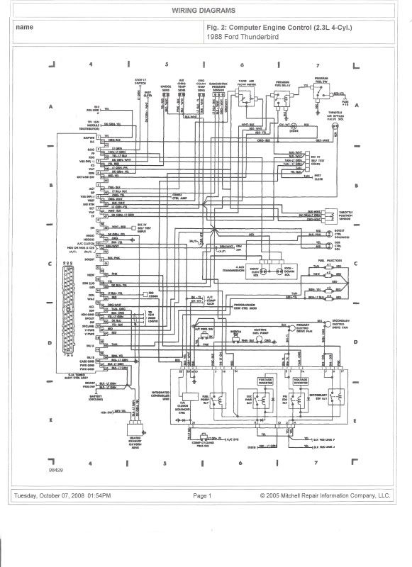

Hey, Thanks Old Kayaker.  Hopefully I'll get this one (cheap).  With my T/C steering column and the wiper and cruise control I'm in greater need than most of the diagrams I was able to find provided

did you try printing it?  i dont know if that would help.  i think my scanner is set on the highest setting.  like i said befor, if need be, ill mail them to you.  let me know
bob
Hey, thanks everyone for all the input, links, postings etc.. Turbo74Pinto I was able to get to your diagrams, but they were hard to read.  Is it possible to re-scan them at a higher rate?
I did a lot of  wire tracings and with the '88 T/C harness it's like separating conjoined twins!  However, I did get the Computer, Alternator, Coil, Wiper Control, Dash and a few other things sorted out.
Which, by the way, amongst using the T/C steering column, alternator and wiper control, I also intend to attempt to configure the T/C dash (Speedo - Tach) into the Pinto bezel and use an ESS gauge pod for the other gauges.  I guess I know no limits to torturing myself!  :lost:
Tom
turbo74pinto
here you go.  i printed and scanned them.  if you cant read them or they wont print, i could send them to you in the mail.
bob
http://i307.photobucket.com/albums/nn294/ford371/scan0002.jpg
http://i307.photobucket.com/albums/nn294/ford371/scan0001.jpg

Well..., I don't know whether to be glad almost everything is done on my '73 Turbo Pinto conversion, or to cry because I have reached the dreaded wire harness stage.
First off, let me say I am aware of the recommendation for the Merkur harness.  But..., I'm stubborn and cheap and nothing else has been easy on this project, - so why change now.  I also adapted the T/C steering column so I can have the intermittent wipers, high beam control AND criuse control.  This is, in part, why I want to use the '88 harness in spite of the difficulties.
Everything I have came out of an '88 Turbo Coupe (I know..., I know, the worst harness to start with).  I have it all placed out and this is what I'm seeing:
1. "Most" of the "computer to engine" harness is separate. However, there are a number of things that seem to be on other harnesses.  Those that I have found are the "Test" port, the Coil connector and the Fuel Pump.
2. Off the main "computer to engine" harness are a green and a gray connector each with 8 - pins.  Do these feed to the mentioned items above?
3. It appears the inertia switch is "in-line" to powering the fuel pump rather than "reporting back" to the computer for shut off. Is that correct? Also, is the fuel pump triggered off a relay or just the computer?
4. I have converted a C-4 to a 5 speed. Is there any necessary wiring regarding the clutch safety switch, 5 - speed feeds to the computer (if any)?
5. I'm retaining the Turbo Coupe alternator, the electric fan controls, the "regular - premium" switch, and need any associated connections for them.
Frankly, once sorted out it doesn't seem too difficult to do.  I have wired up TV Studio's for years and am familiar with such tasks.  That said, any advice to using the T/C harness would be appreciated so I may apply the experience of others who have gone before me.  Especially regarding what wires HAVE to be cut and what wires DON'T.
Thanks for any input, Tom
