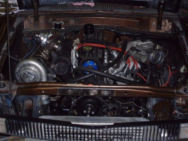

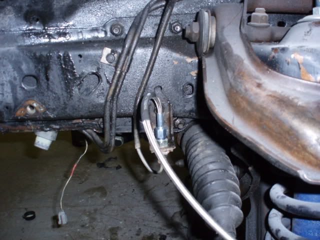

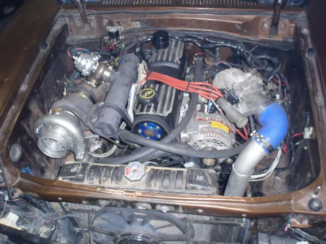

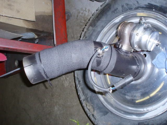

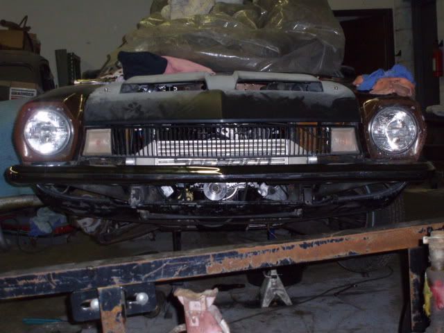

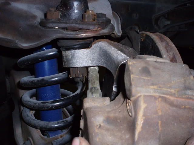

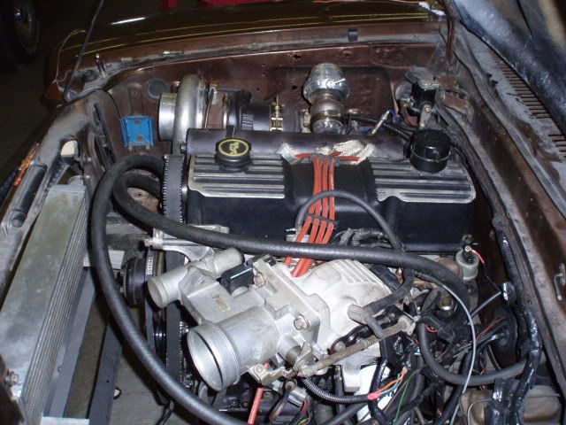

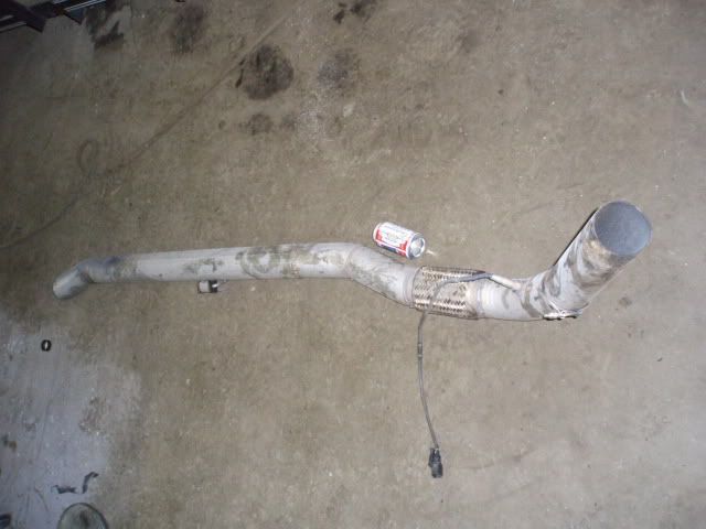

oh, i now have the header, turbo and full exhaust back on.  i have the ic mocked up where i want it to sit.  its only shimmed up with 2x4s so its crooked in the pic.  the brake line issue was solved by going to a -3 AN braded brake hose and addaptors.  it set me back about $55 which wasnt as bad as i thought.  next is mounting the ic and radiator.
bob
turbo74pinto
here are some pics.  i have one pic in there of the exhaust with a can by it so you can see the size.  i also included pics of the brake line problem.

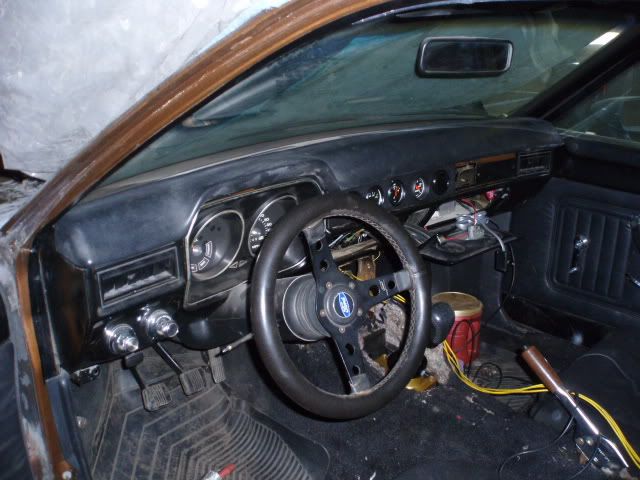

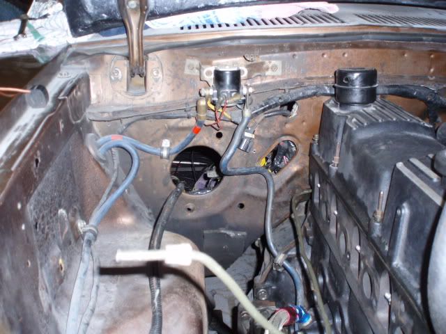

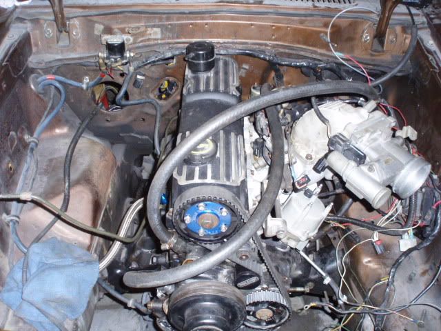

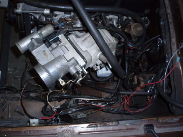

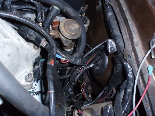

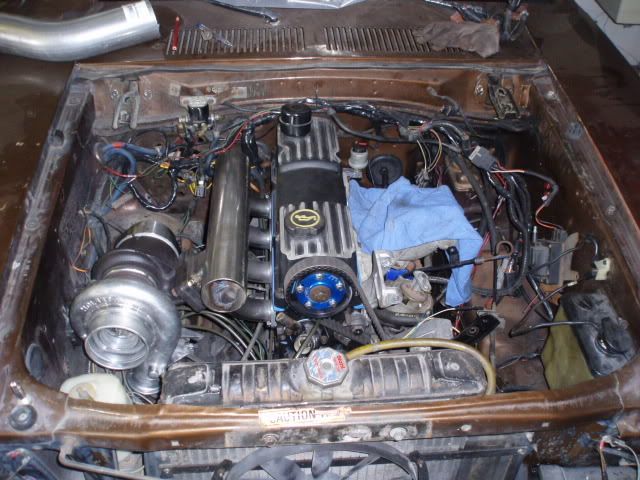

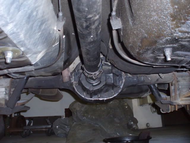

after a few hours working on it again, the motor is back between the rails.  tranny, rear diff, axles and drive shaft are also back in.  the upper intake is back on the engine too.  i wanted to run the wires behind the inner fenders but that didnt happen.  i ran them behind the firewall and brought them out with the factory harness below the speedo cable.  spring fever is hitting me too hard!  i still havent figured out what im going to do with the brake lines.  im leaning towards running a -3an hose and fittings. today i remade my guage cluster and mocked it in the dash.  i have to weld a few metal tabs on the dash to screw it to and paint a few scratched up areas.  then rewire the guages and install the cluster and the dash cap.

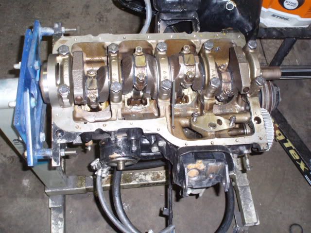

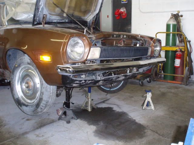

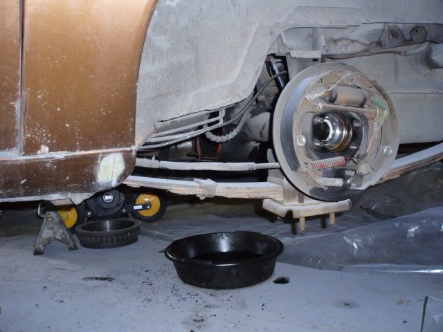

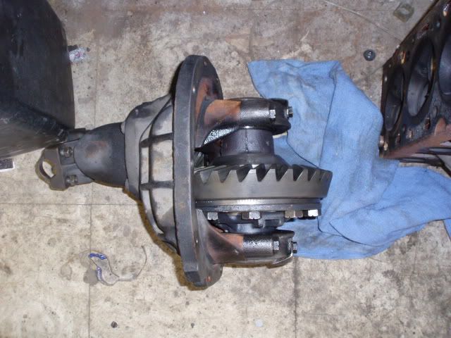

well everyone, ive been back at it.  the car is apart...again.  i dont have pics but ill take some today when im at the shop.  the motor is on its way back out for new rings and bearings.  the rear diff is getting a minispool.  the spool is installed, but the pig is still on my office floor.  im going to hide as many wires as i can behind the inner fenders and firewall when the motor is out.  ive also recieved my dropped spindles in which one is installed.  im having brake line clearance issues with the upper balljoint nut though.  a heat sheild is being fabbed up for my header and the down pipe is being wrapped.  id also like to get the dash together again.  im also still trying to find some sort of shifter boot.  id like to find one of the lower boots for a mustang or t-bird.

here are some more of the car plus a video!!  this is how it will look until its back from a dyno.  then it comes back apart for winter.  i plan on painting the engine bay and hiding as many wires as i can under there.
bob

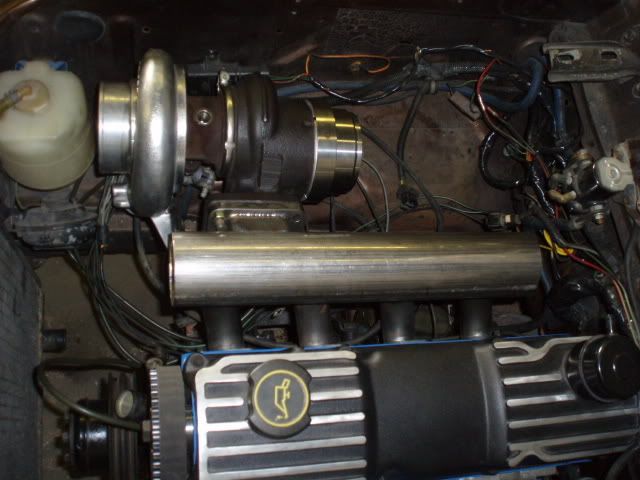

ok, im getting farther.  i have the fenders back on it.  the header is tacked together and the turbo is sitting in possision.  when i get the waste gate, ill finish the welds and have it ceramic coated.

the dash is almost crackless.  the crack is only about half an inch long or so above the guages.  i think its an original.  its still somewhat soft.

Ok I gotta know, is that a crackless dash pad or a plastic dash cap?

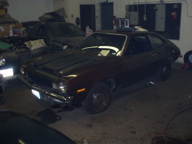

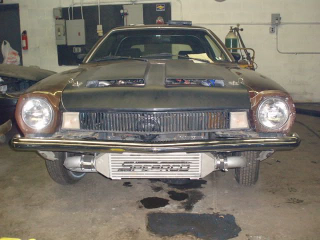

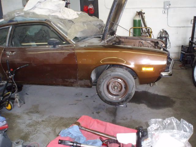

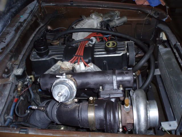

well, here it is.  it a 74 runabout that was set up for road racing when i got it.  ive changed springs and put it on somewhat of a diet.  my regular street rims are stock 13s painted body color with the dog dish hubcaps.  the motor and tranny are out of an 88 turbo coupe.  its a stock, but ported, head on a studded short block.  the short block is just a basic rebuild....for now.  the cam is an esslinger 2277 hydrolic roller.  the intake is a knife edged and ported lower with a gutted, rotated and shortend upper.  im in the process of making my own log style header that will feed a hy35 turbo exhausting into a 3.5 inch exhaust that will dump in front of the rear axle.  intercooler is a front mount spearco.  i am converting to a blow through mass air flow.  twisted innovations will be doing all the computer tuning and dyno work.  these pics are pretty much the stage its in right now.  i will post more as i go.
