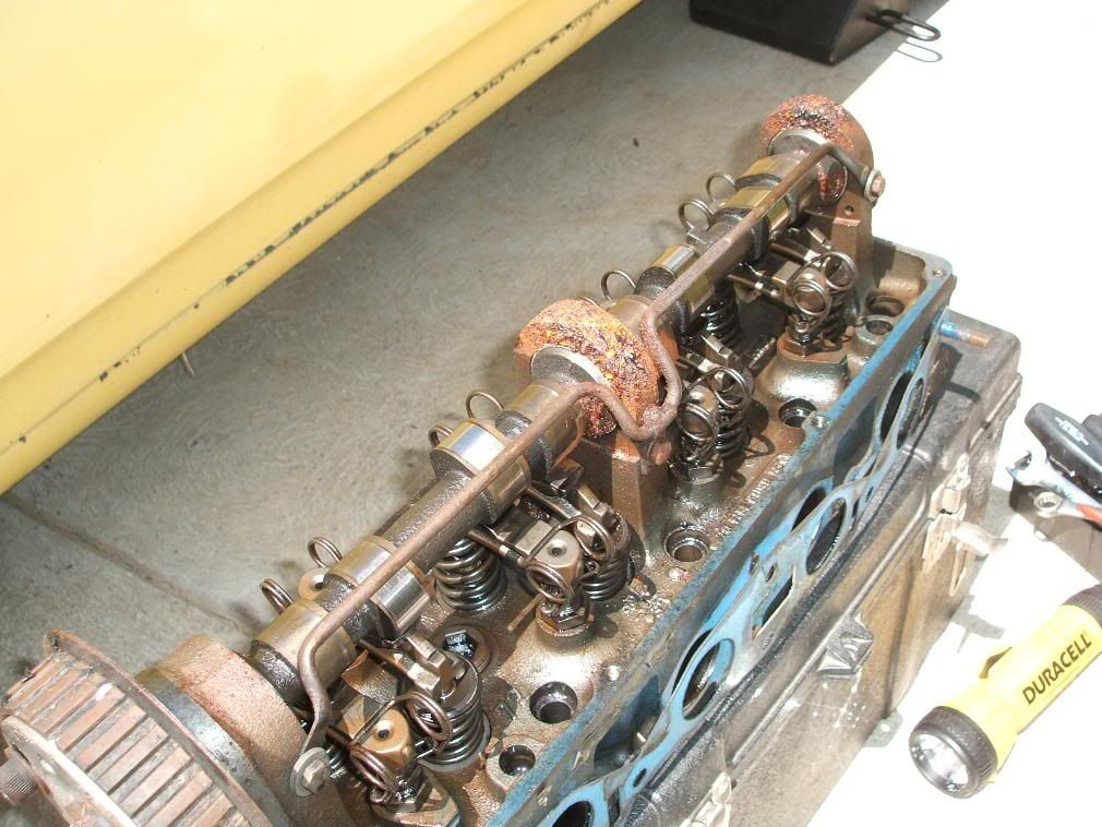

Hopefully you don't have this problem:
The best way I found to prime a 2.0 is to remove the radiator, remove the timing cover, unhook the timing belt, and spin the oil pump pulley with a drill (using a few extensions to reach it). It is nearly a straight shot to the oil pump pulley above the valence and below the bumper.
This will build normal oil pressure without having to actually turn the engine over.
Here's a pic... not a great one, but you'll get an idea.
