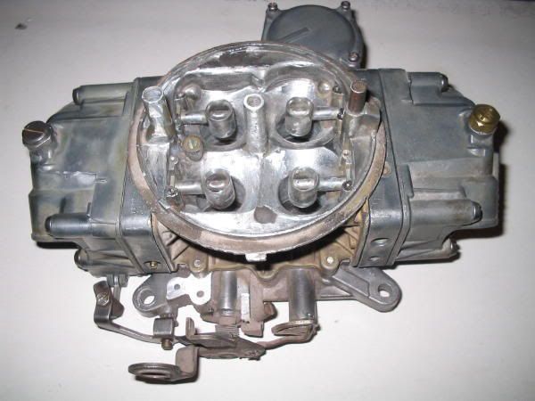

Well, the Holley racing carbs are basically the same. It doesn't actually increase the flow through the carb, it reduces the possibility of air cleaner combos causing a restriction in air flow. I don't want anything up through the hood so I need a low profile air cleaner. I'm actually using a procharger carb hat and a cone filter on the other end of a stainless toob. In the header side pic you can see the hat.
It doesn't need a choke as it isn't a D.D.
'77 pinto,Reinforced stock chassis.2300,courier trans, np205 transfer,9" rear,427/430 gears
So, it looks like you cut off the choke body and did some blending of the venturi area. How much more cfm do you think you got by doing that?

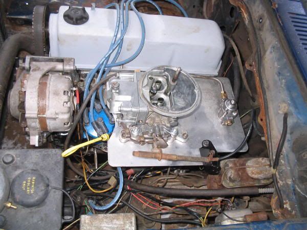

I don't have any pics of the body yet. This is just an exersize in what can be done with a 2300. I'm going to run it basically stock, then upgrade from there.
This is the engine in a test fit. It will be coming out in the spring and all the holes will be filled and the engine compartment  repainted. All the wiring and components will be removed from the engine compartment. It will take a keen eye to find a wire when it is done.
That is the 2bbl, 350 cfm.
This is the 4bbl, 390 cfm
I have other carbs to try. The Mutant pony runs best with a huge 600cfm 2bbl. Now I know that big of a carb should be way to big for a 2300 but, somebody forgot to tell the car.
