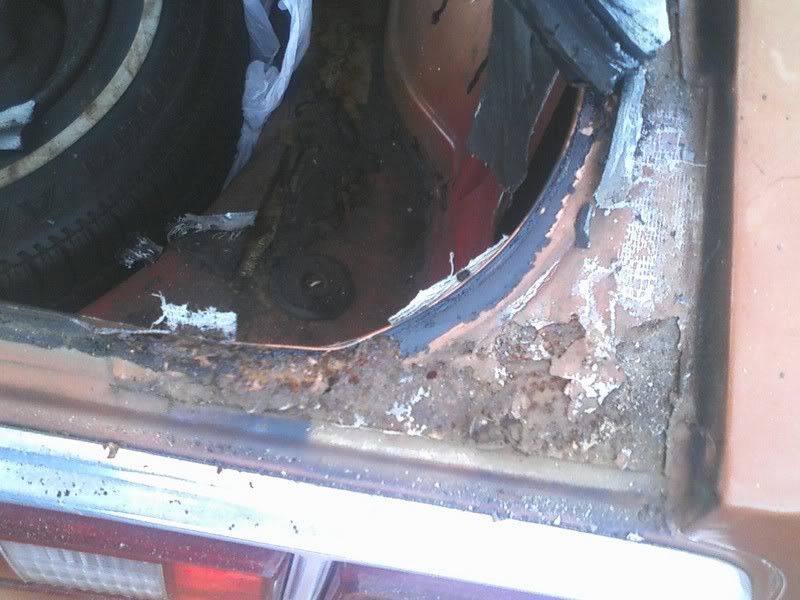

once you get all the rotted metal cut out you can then trace the area onto a template to transfer onto the new piece of metal. i'd cut the new piece a little bigger then you think youll need the first time and trim it down to fit rather then accidentaly making it too small the 1st time. it shouldnt be too hard of a job. atleast its not really a visable area that needs to be perfect.
That's the whole reason why I was asking. So I knew the better way to go. I'll end up going to Home Depot & picking up some sheet metal to fix that with. Would it be best to make a template out of some cardboard so I can get the cut right? I've never attempted this type of repair before so I want to make sure I'm going about it the right way.

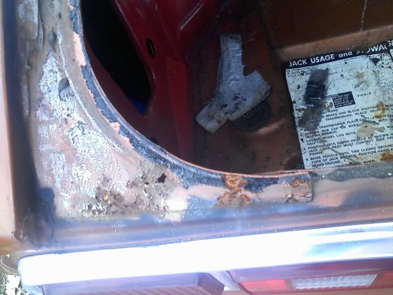

that looks like it would be easy enough to just patch with steel. cutting from another car seems a little excessive
Thats all flat. All I ever did was cut out the bad stuff and weld in repair sections from sheet metal (E-Z). I have repaired MUCH worse.
Finally got a couple pics of the rusted out corners I'm referring to. I need help on this please.
As you can see the metal is so rusted I can't just patch it with filler, but need new metal.
The question is, should I take a graft from another Pinto sedan, or try to make a replacement piece with sheet metal? Someone, please help. The fuct tape won't hold anymore.
