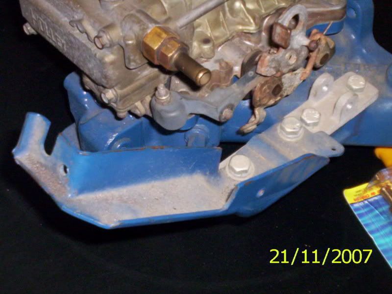

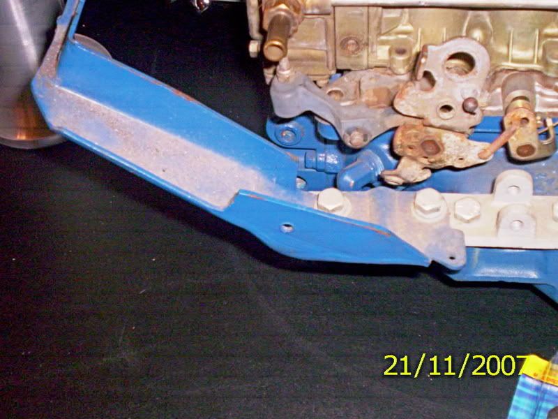

You are right it does look the same.  If you look at the two pictures, it would seem to me that there is a piece missing that attaches to the aluminum block at the end of the bracket.  Any ideas on that???
Bracket 2
Bracket 1

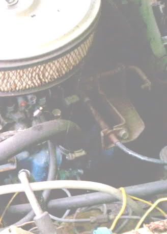

Jim, that looks like an extender piece for the throttle cable that came with the carb / intake?  I am not sure what that would be used for other than a for the kick down?  Sorry I can't be more help to you.  I will pull the cable off the car tomorrow when I am at my mom's house for dinner.
I have a MT car but this is the linkage that is on it. i believe it to be from an automatic car.

Jim, I posted my pic. It looks the same.  Here is the spare one I have.  I will have to pull the cable off my parts car.
Bracket 2
Bracket 1
