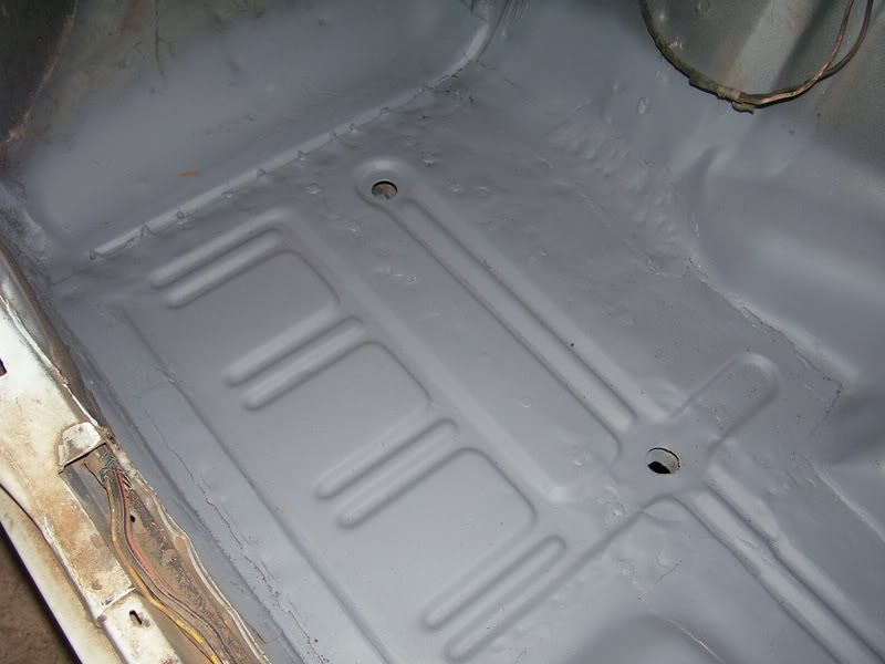

Well I ordered some Por-15 a few days ago and got it last night. I used it on the fenderwell where the battery tray was. It was badly rusted so I welded in new sheetmetal where needed and Por-15ed the rest. I also bought some of there Por Patch that comes in a tube which is Por-15 just thicker. The Por Patch feeled inthe holes beautifully and then painted Por-15 over that. The finish turned out nice and smooth and it cured rock hard. So far it performs as advertised. I'll get some pics of before and after.
I just used this stuff of the driver's side floor pan in my 78 sedan that has gotten bad. It's rusted through in spots, but not to the point that it's destroyed. I plan to cut it out and put a new one in at some point of time though. Great stuff

It would be great for undercarriage use. You just have to get the metal absolutely as clean as you can get it. I mean the "Navy White Glove Test" clean. After that it should go on without any problems.

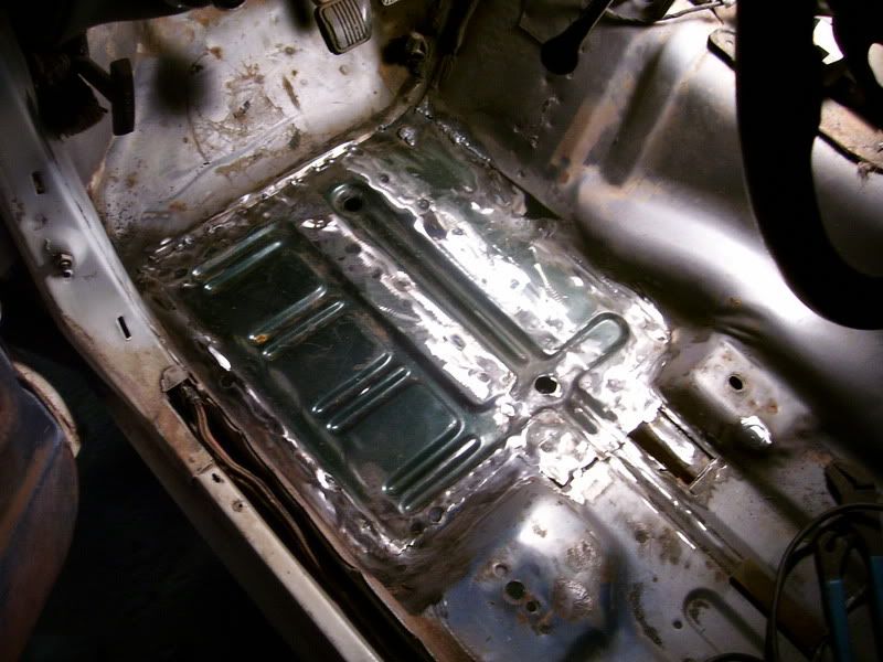

Well I didn't Por-15 the floor pan but here's a few pics of the floor pan after the repair. I thought I got a before pic of the pan but I guess I didn't.
It's not the best you've ever seen but it will do.

I just replaced the driverside floor pan because it was completely rusted through. I had a donor pan I cut out of an 80 Bobcat that was rust free. Wow, what a pain in the royal neck. It took me about 11 hours to finish. In spots the metal was so thin, the little wire welder I was using would blow through the metal as soon as I hit the trigger. Weld, Weld, Profanity, Profanity, Weld, Grind, Weld, Grind, Profanity. After all that, I am never replacing floor pans again. Anyway, the passenger side is in the beginning stages of rusting too. So what are you guys using or doing to stop rust in it's tracks and preventing it from coming back?
