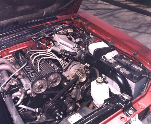

In addition, the "Pinto 2.0" as it is called both here and abroad is the 2.0 EAO platform. Very common in Europe and evolved into quite a racing platform due in large part to Cosworth.
The 2.3/2.5 and Ranger 2.0 is known as the "Lima" platform after its main manufacturing plant in Lima, Ohio. The only purpose-built DOHC heads for it were some protoypes that Ford's Special Vehicle Operations were developing for what would have been the '87 Mustang SVO. The plug was pulled on the entire operation and nothing ever came of it. SVO reemerged later as the Special Vehicles Team( SVT) that we know today, but high-performance factory Lima development died in '86. The '87 Thunderbird Turbo Coupe got some SVO-esque parts like the intercooler, more boost, more power, and a faster ECU, but even it only lasted through '88. Ironically, the turbo era of F1 racing also died at the end of '88.
Nothing is a direct interchange between the EAO and Lima designs, BTW.
