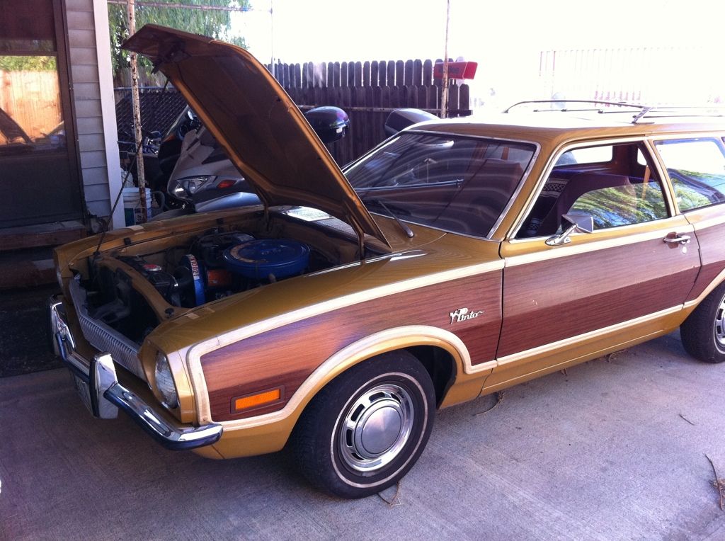

Yah, I finally dug her out of her parking spot. Got the cob webs and dust off of her! I have been procrastinating on driving her because I just feel like she is getting hot. She had a hot smell to her when I drove her last year. I have been waiting for hubby to install a temp gauge under her hood, but things keep getting in the way. I decided I couldn't wait any longer. Just had to drive her. I figured at 3am and 8am in the morning, it won't be all that hot so she should be ok.
I checked her fluids, well except for the water, that is why her hood is open in the pic., a reminder for me to check it when she cools down! LOL So she should be ready to roll at 3am tomorrow!!  ;D
I know, boring, but I haven't started a post in a while, so what better to talk about but Nellie Belle! LOL
