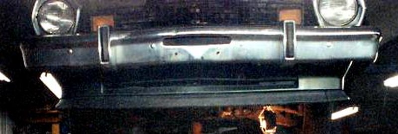

hi pattywagon77 this is a old post but this is what i used. wrecking yard part ann not hard to do.  chris in ca

hey phil nice job on a good looking easy part to your car and it looks like it should be there. mine follows the bottom metal edge of the bumber and gets slighty trimed to bent alittle to follow the shape of the bumber .on the end side you will be maybe about a 1nch or less short to the side of the bumber so a small strip of sheet metal painted black and sheetmetal screws used to attach to the edge of bumber and air dam.used as a spacer to bride the gap.happen on a day walking through pick n pull and a 77 pinto was ther with the bumber laying on the ground to measure up.you gotta make things fit with finding new parts to work on these cars. ;D   chris

Nice idea, So  i copied sort of.... I mounted mine differently. I drilled  holes in the bumper core and  used the  push pins to  hold it  at the same  time it slide between the bumper and the core. I did have to modify the airdam some. how did you get the sides to stay up as it is just  the same width as the bumper?
Cost $5 and 2 days of playing, ok it realy tookabout 2 hrs. I just like to  make sure  that is what i relay want  to do I have tried to get mounting pic  but they are to dark  something about black on  black and little light... and the  flash  washes it all out

thanks guys for the nice comments. maybe some time well be able to meet up in person. not sure when it will happen though. i will be trying to make it to knots next year for the show.as far as the srews go they are mounted on the front edge of the bumper in front of the air dam.i like things that go on easy and fit my small budget for fixing up my wagon.   :)  chris

from the looks of it... the bolts are in front of the spoiler?

hi it worked as you can see the aerostar air dam is almost the same width as my 77 wagon bumper. attached by screws and washers from the bottom edge of my bumper. it was easy to install trim as needed to follow the shape of yhe bumper. it looks like it should have when it left the factory. hope this helps chris

hi to all went to my local pick n pull and got a plastic air dam from a ford aerostar minivan.with some metal screws and washers  i drilled on the bottom side of my alumium bumper. looks great and looks like it was made for a pinto.25.00 total investment and 20.oo was for the air dam.so for some of us who are on a budet it works well. thanks chrisf1219
