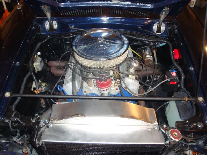

Looks pretty good. I have to come up with a fan shroud myself. I know I'll get caught in it eventually if I don't!

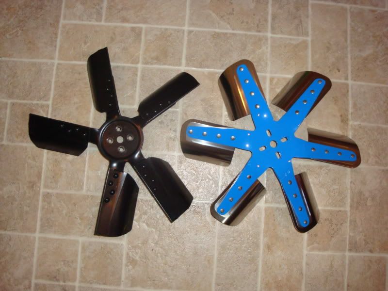

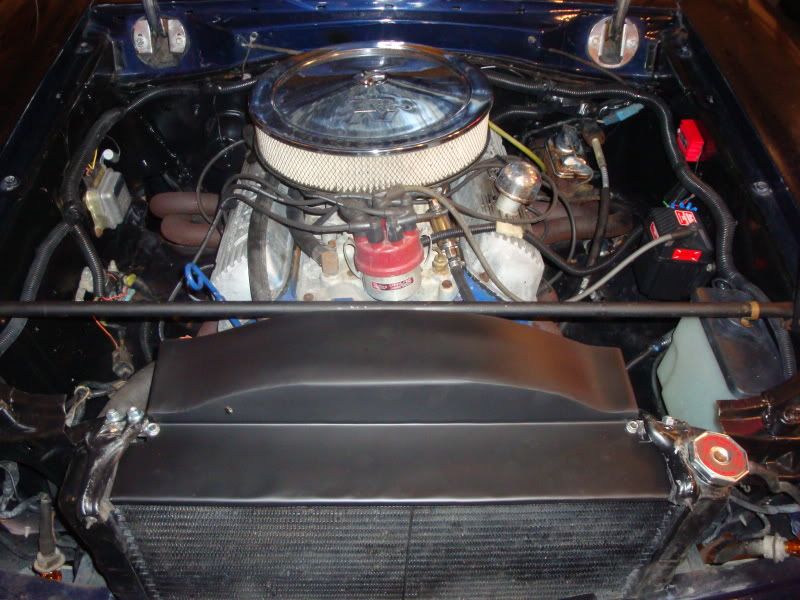

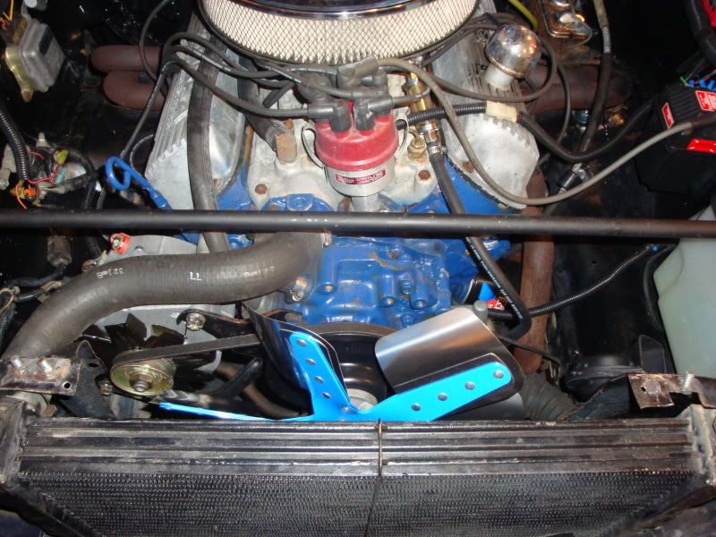

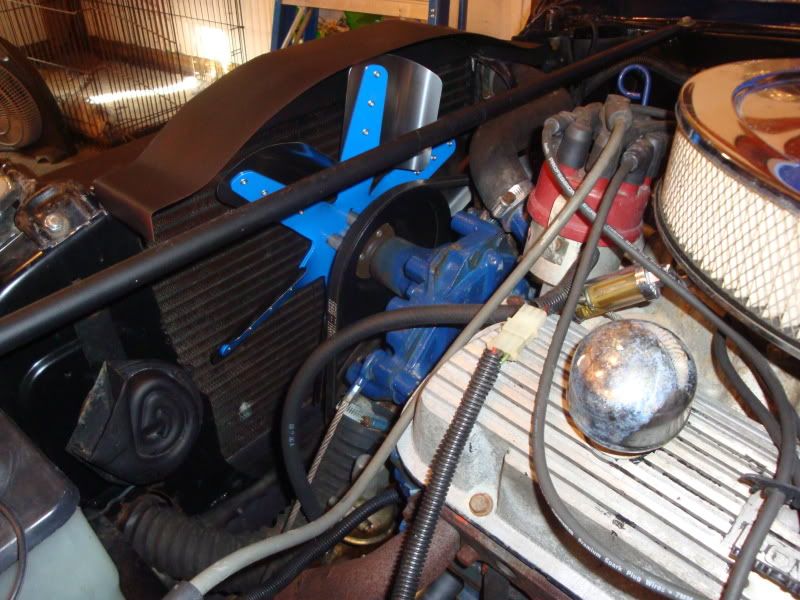

 I just got the new fan today. This is the last of this part of the project. Finally finished.

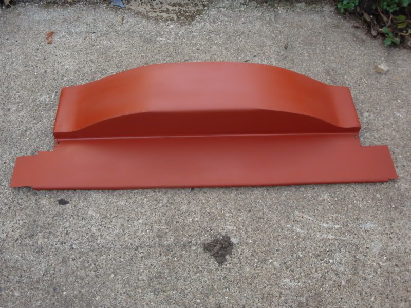

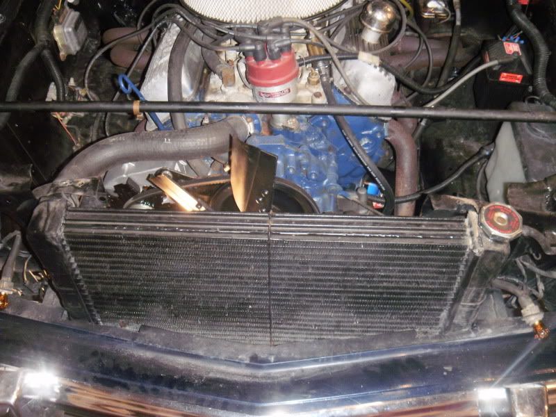

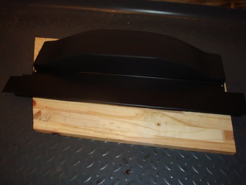

well  today I cut it to fit better and mounted it. I also got it painted and I ordered a new fan my current raggady one has 5 blades and I ordered a new one with 6 blades I hope it fits ok. I will put it all together when the new fan comes in.
heres the fan I bought..  http://www.summitracing.com/parts/FLX-1316/

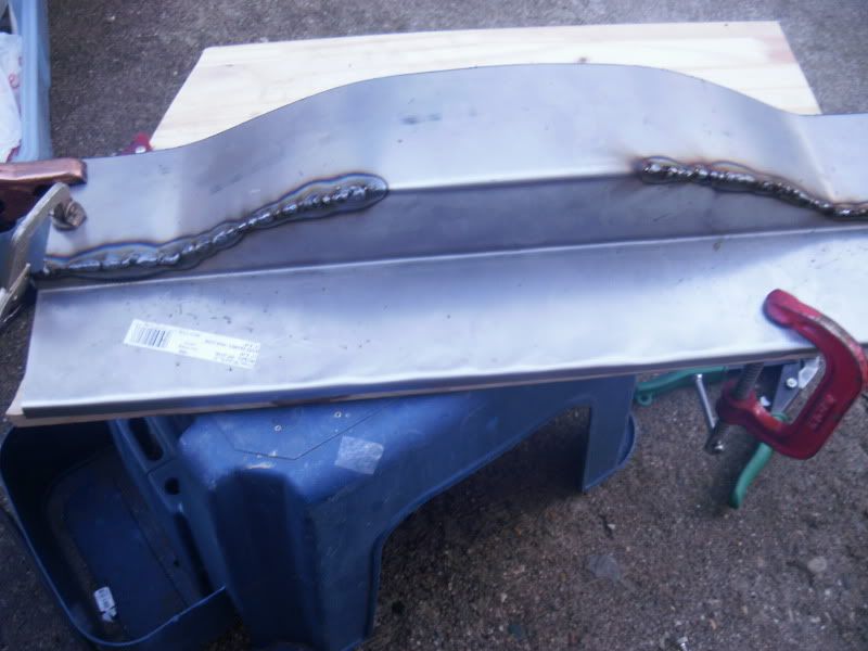

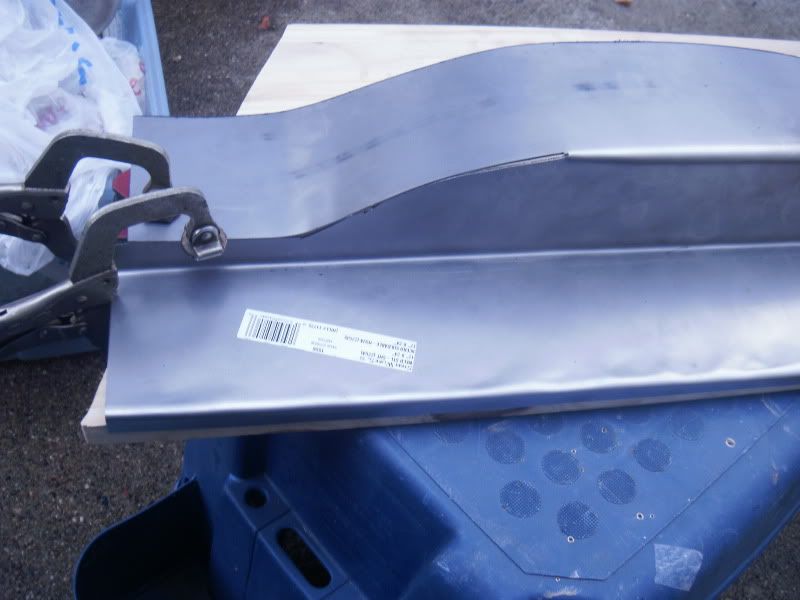

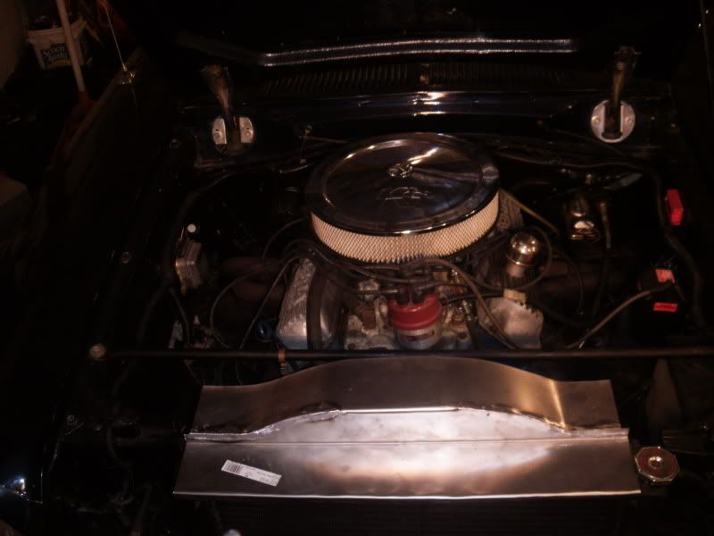

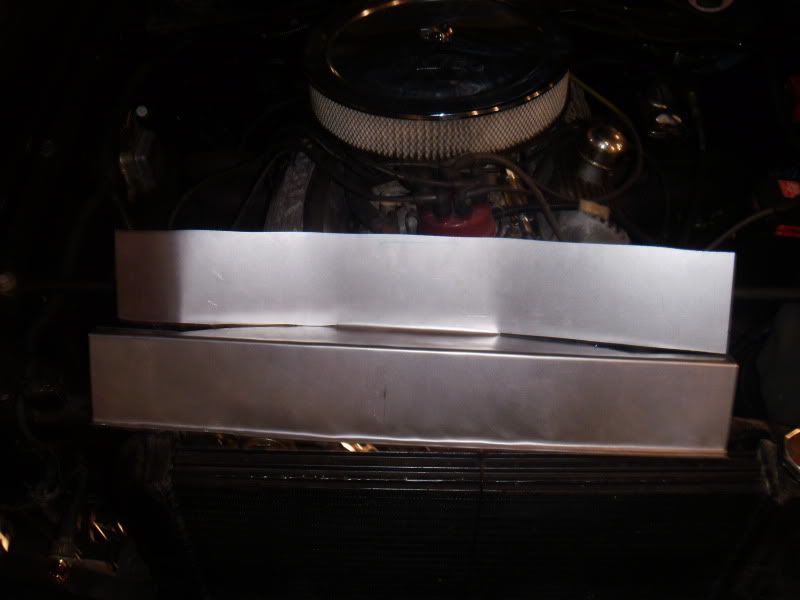

I just thought I would show you what I did wasting my day today. My wife told me that if I do not somehow fix the dangerous exposed fan on the Pinto I will have to sell it or I can keep it only if I fix it. Well after 25 years I started the solution. I am not done yet but maybe tomarow. I did make progress today I started with a flat piece of sheet metal. Just so you guys know I am a Firefighter not a pro Fabricator this is as good as it gets for me. As you can see by the first pic when the cars running the fan could bite. I will have to trim it and mount it in the morning it is tight but I think it will fit.
