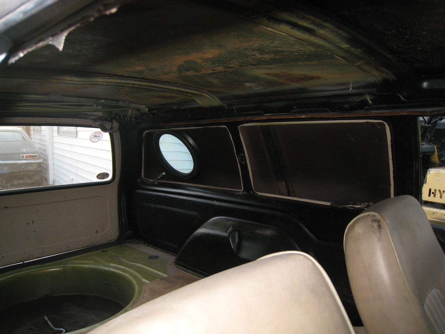

gotta ?? can u use an explorer headliner??? it is molded and rigid but flexable it is one peice and no steel support bows  undo the top trim and pop the headliner in
I wouldn''t know the answer to that! Maybe someone else will know! Sounds like something to check out though!!  ;D

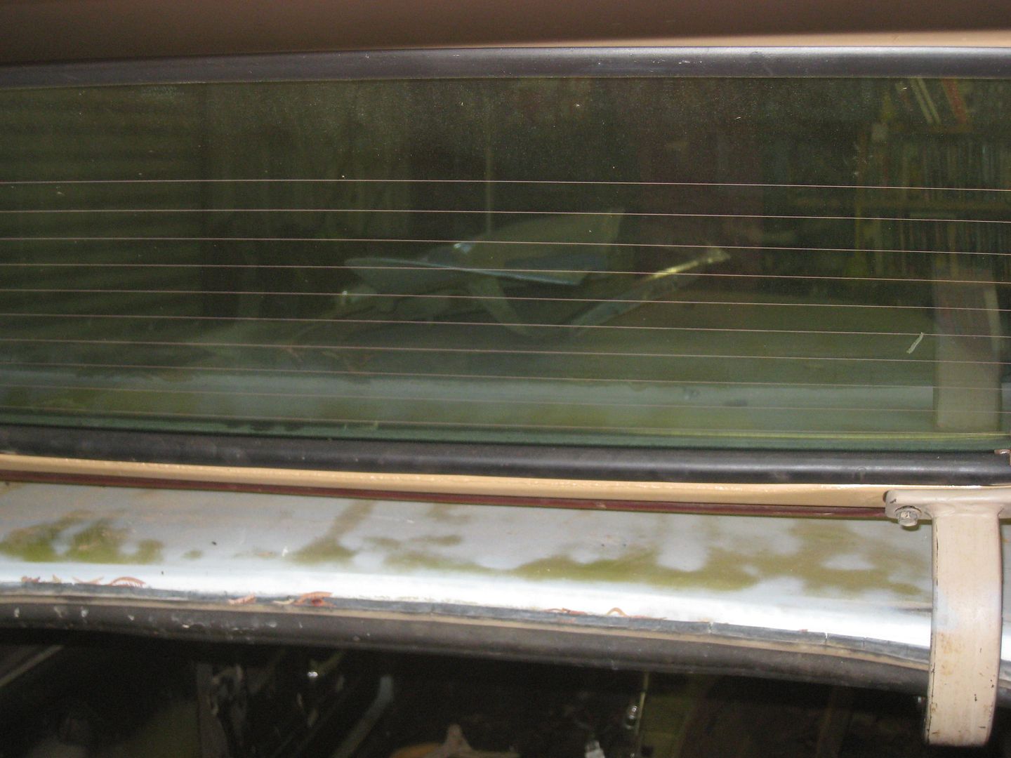

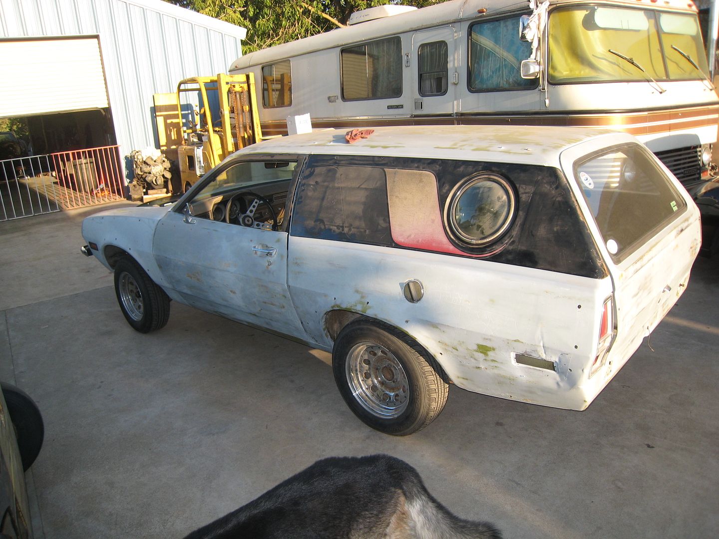

Wow, look, finally an update on Shaggy!!! LOL
Yesterday hubby made some shelving units to store Pinto stuff that needed to be in a warmer atmosphere then what it is in the Pinto shed!! So today we put the door panels and some of the seats up on the shelves. In order to do that though, we had to move Shaggy out of his space. Then after we did it, we had to clean up the space. That gave me the perfect opportunity to have hubby help me R&R Shaggy's rear hatch!!

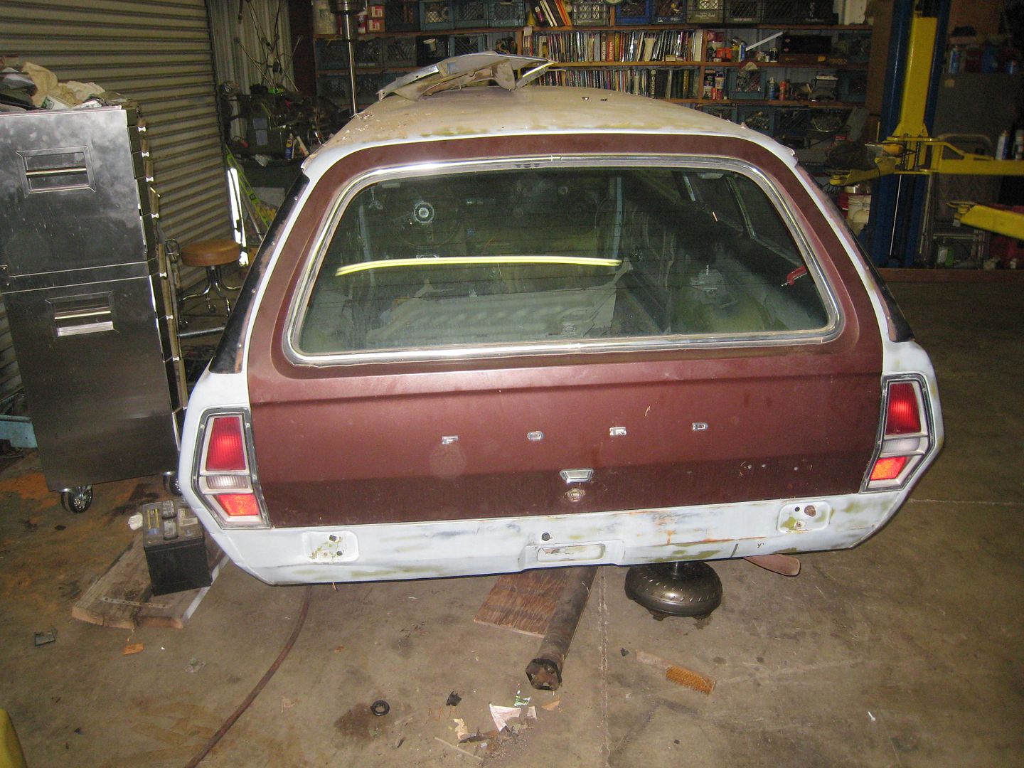

Now Shaggy is sporting a 77 Defrost style window, hatch!!!  ;D ;D
Here is the storage shelf!! Above the shelf is 2 smaller shelves for the door panels!!!
Not much of an update, but at least we got one more step closer to painting!!!  ;D

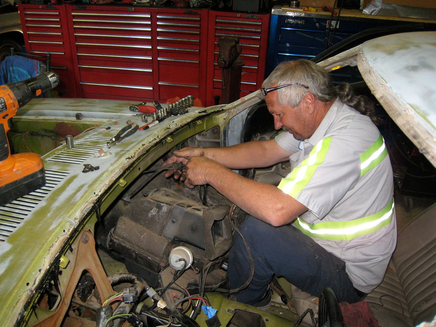

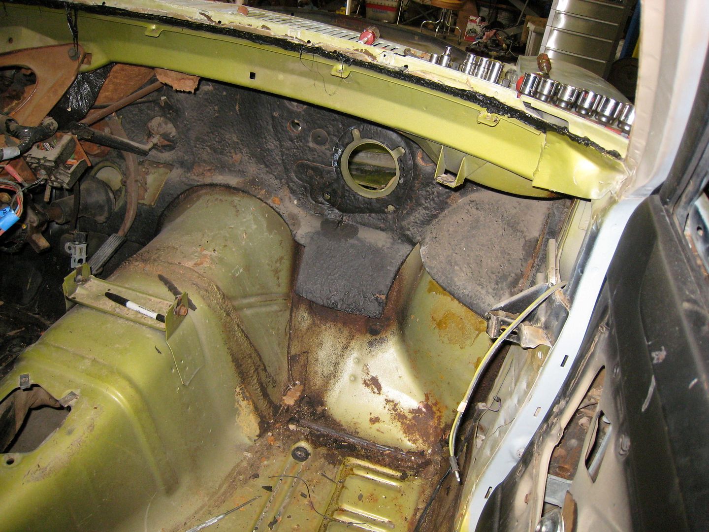

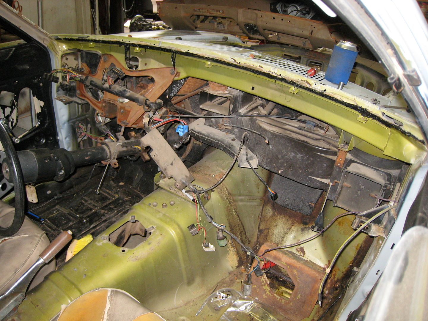

Well, thanks to Fred, I have made a lot of progress on Shaggy!!!! He is here visiting so what better thing to do, but to work on the Pinto!!!  ;D ;D
Today Fred and I got the dash pulled!!
Then he told me how to take the clutch pedal and brake pedal out! So I took them out and installed the automatic brake pedal!! So I am now and automatic car instead of a stick!!  ;D ;D

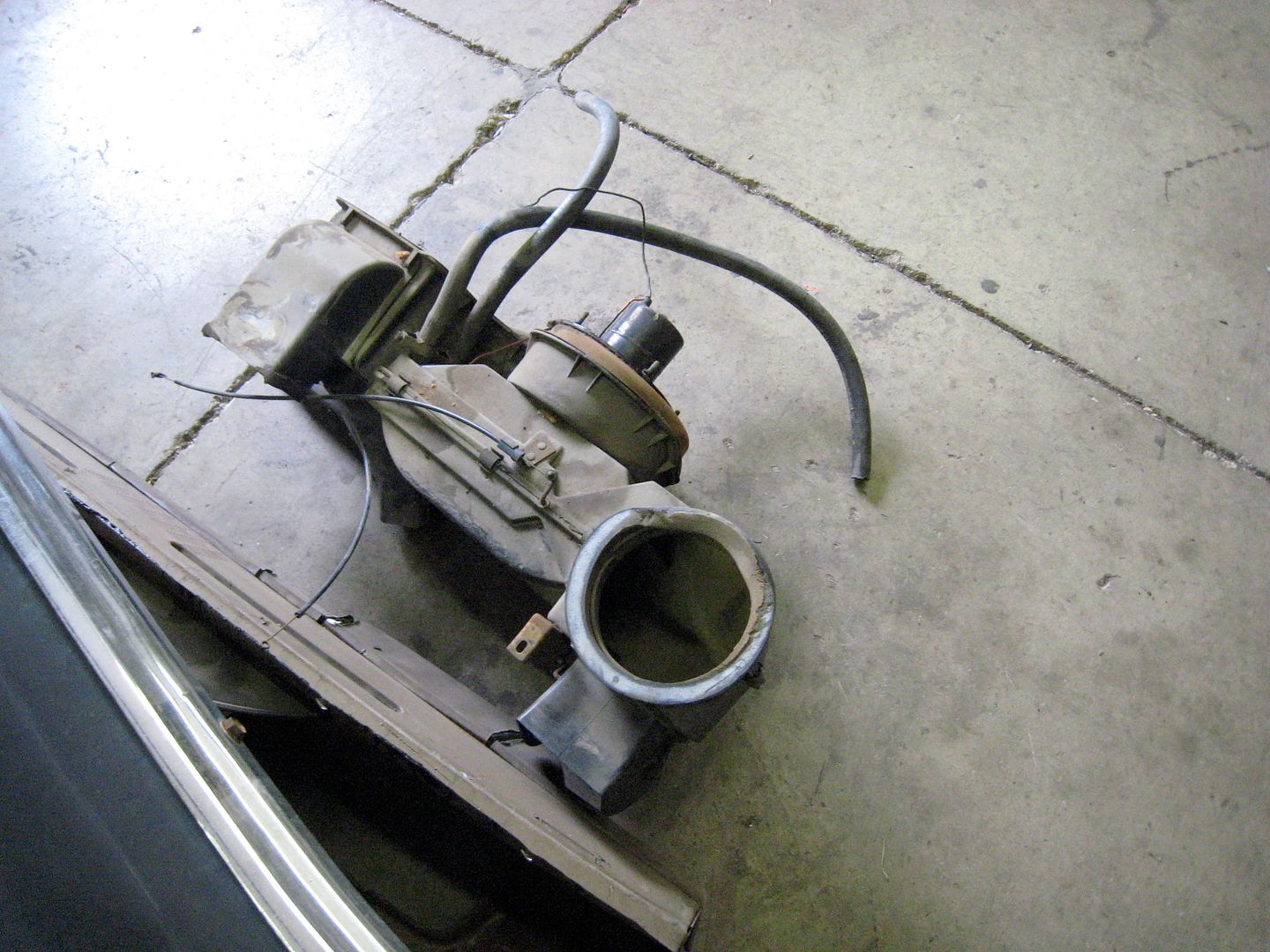

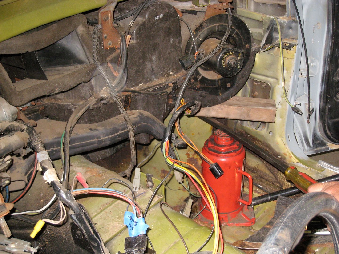

Then I pulled the heater box
I set the a/c heater box next to the non a/c one and for a while there we thought it wasn't going to work!  We decided that I should make a template to see if any of the bolts would line up and to see if the a/c part would stick through the fire wall. So I got some cardboard and made the template and with that I was able to determine that 2 of the bolts looked to be in the same spot and the a/c part would fit through the old heater box fan hole. So I made marks on the car to drill the 3rd bolt hole, and the heater hose holes. Then I went to work drilling. Got the holes done and tried to install the a/c box. No go. So with further inspection we decided I needed to make my holes a bit bigger, even if it meant I had to use bigger washers to bolt it on! So that is what I did, and with some pushing and prodding, we got the 76' a/c heater box to fit in a 73' Pinto wagon!!
Hey, that's not Fred!!!!
How do you install an a/c unit?? Use a hydrolic jack!!!!! LOL
So Shaggy got his brake pedal R&R'd, then dash removed and the heater box R&R'd. So now the next step for me will be to finish cleaning the windshield goop off the pinch weld of the car and also off the dash. Then I will remove all the stuff out of the dash in preparation for the paint job!

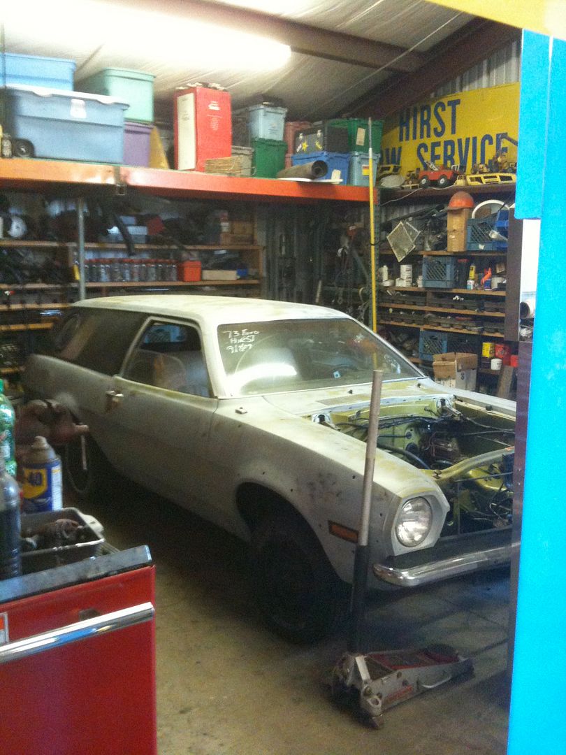

Look what happened over last weekend!!!!!
Yep, Shaggy made it inside the garage!!!!

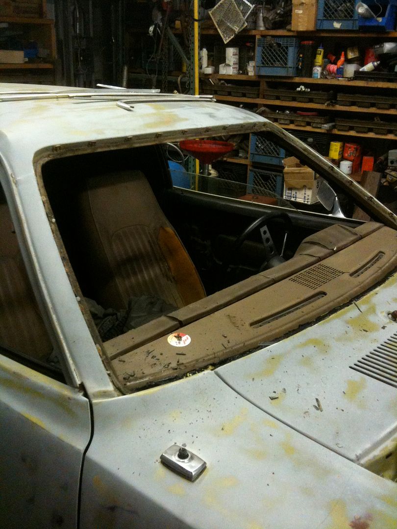

I already took the windshield out and finished takeing some of the dash components out. Now I just need to remove the dash and the heater core box. Then we can see how the new/used a/c heater box fits. I will take pics and update as we go!! I hope to do a lot of this work this up coming week! I had one week of vacation left and had to take it before mid Oct., so I only have 3 days till vacation!!!  ;D Then after mid Oct. my vacations start all over and I gain one more week for a total of 5 weeks a year!!!! Yippeee!!  ;D ;D Anyway, I will update on the progress!!

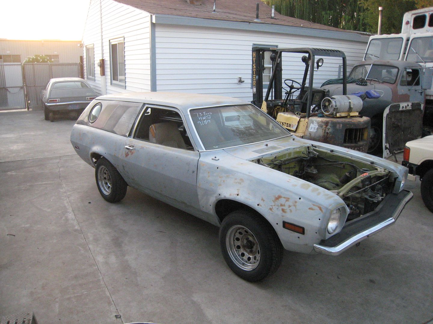

Yippeeee, I finally got my wagon back home!! Now it is mine and will always be mine!!! LOL
I got right to work on it. I took the grille off (to not break it trying to put a motor in) and took the hood off. Then I decided to try the cruisin panels on for size!  ;D  Wish I would have decided to do that first because then the pics would have been better! No hood kinda takes away from the overall look!!
Here she is with panels!!
It was hard to get decent pics. The day was wearing down and the driveway is a bit packed! Can't wait for the kid and his girlfriend to find a house!! LOL
The panels are just vice gripped in for now, I will probably jam the windows then hang the panels on for painting!

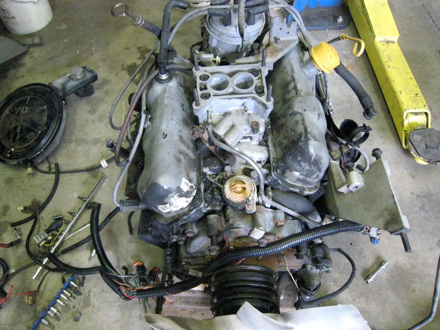

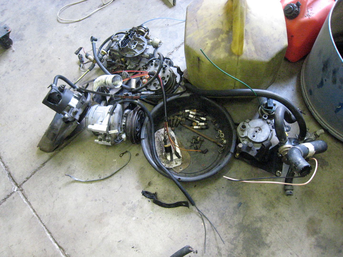

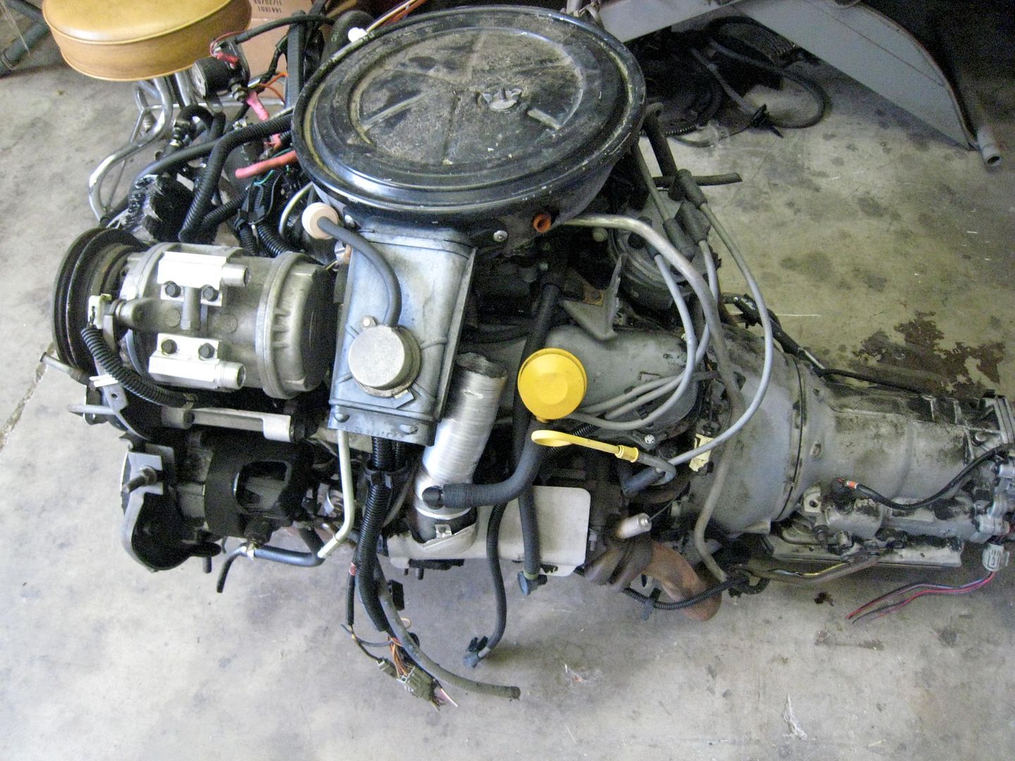

Today I finally started to tear into the motor that we are wanting to put in the Shagon Wagon.
So far it has gone from this,
To this,
I figured I would stop there for now, till hubby came home from work. That way I don't take to much off. I'm not sure what all he wants off!! I know his plan is to do a test fit into the wagon, once it comes home! I think once we know for sure if this set up will work or not, we will re build the motor! Then I can paint it and give more before and after pics!  ;D ;D
