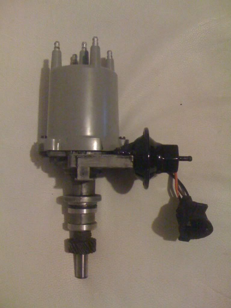

Hey I just got a Duraspark dizzy and Duraspark 2 brain box with a blue tab. I just cleaned it up as  it was greasy as hell.
This is the correct dizzy for my stock 2.3 right? I heard from someone I might have to change the gear on it.
Any help would be awesome.

The 79 Bobcat should have a compatible ignition module.  The Duraspark system was used on MANY different cars and trucks.  The same module used in Pintos can be found in 80's F150s also.  It had a simple job - to convert the tiny 2VAC signal from the disty pickup to a switching on/off of the coil.
Since you have a 2.3, a later DS2 disty should work.  Rockauto has rebuilt ones for 50 bucks.
Coil can be had at RA or off the Bobcat mentioned above.  Good time for new cap and rotor, wires, etc.  Get wires for the 78 model so they will be DS2 compatible.  The earlier ones might not handle the higher voltages well.

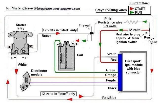

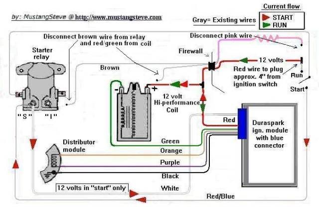

Here This should not only help me out but a few others. The first is for a high performance coil, the second is for a regular coil.

Yeah Ive heard good things about the duraspark system, my cars a 74 with a stock 2.3. Im in the process of getting parts for my car and am planning on getting a duraspark distributor and brain box. any good wiring diagrams for the install? I heard its pretty damn simple to install. So I need the duraspark dizzy and brainbox and the correct coil right?
Edit: The brain box im getting is out of a 79 bobcat, is this a duraspark 2 box?
