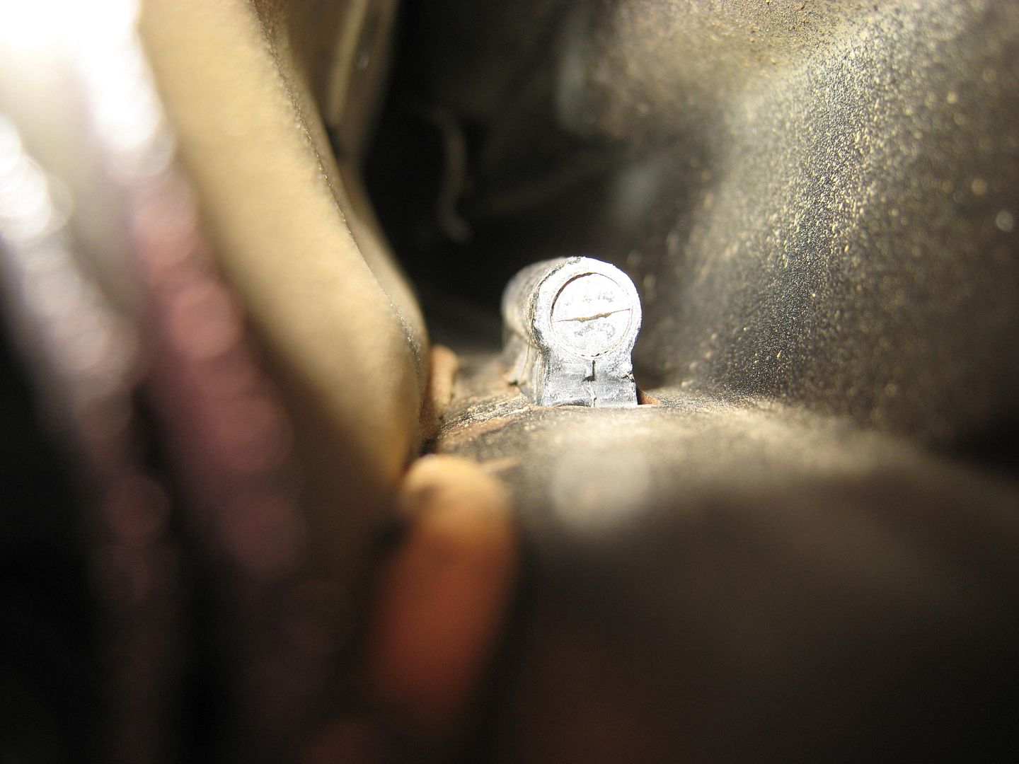

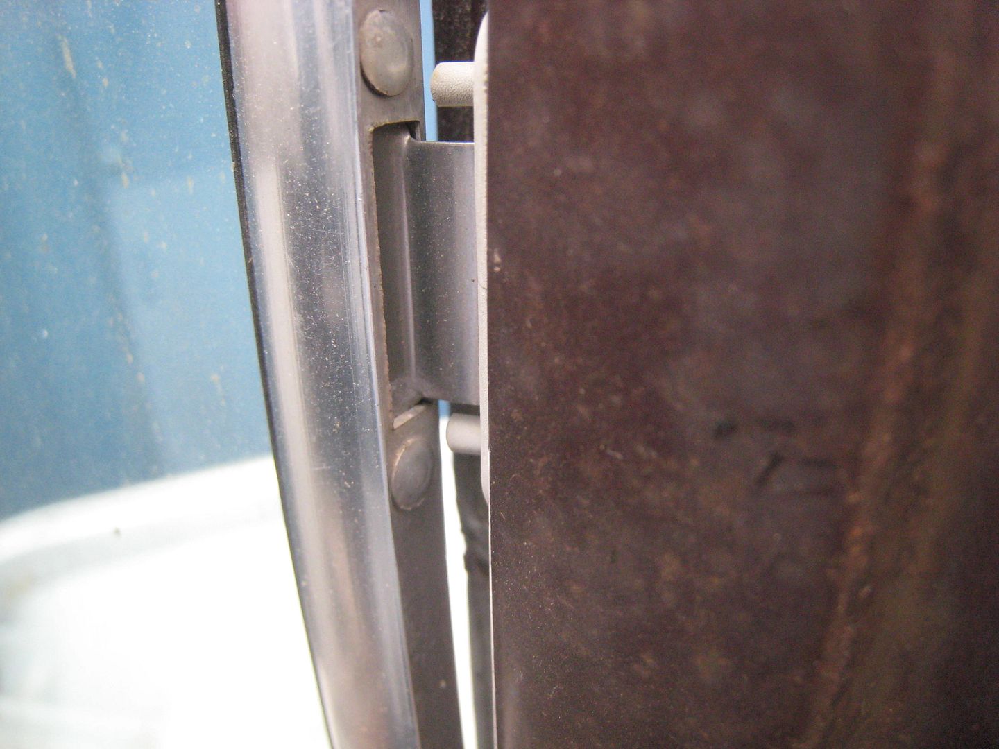

I looked all over and couldn't find where you would push a pen??  Here are some more pics. Do any of them show the pin you are talking about?
The red arrow shows the "tab" on the inside of the post!
This last pic is of just the window part of the hinge. I broke the hinges taking out this window!

So, what do you guy's think it is??
Ok, I'll tell you! LOL
That is what the wagon window hinge looks like on the inside! We stripped the 77 wagon today and because everytime you try to remove the hinged windows, the hinges break, we cut the posts out instead! LOL So now we have two hinged windows windows with good hinges! Although I don't know how one would remove them intact! LOL
Actually I think it can be done! It's hard to tell from the pic, but there are small little hook pieces on both sides of the round thing. ( Like my technical terms? LOL) I think if one cut the metal to expose the hinges, one could use a screw driver or a pair of plyers to push it back out from the "inside out"!
