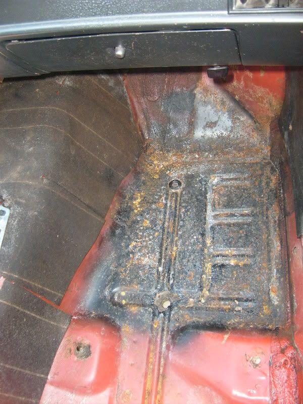

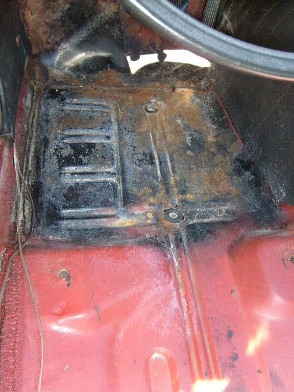

Heh.  I just went and checked in my gargae and I forgot that I already have a "Trunk and Floorpan Repair Kit" from POR-15!  Yay!  I will get this floor repaired quick.   :afro:

Thanks!  I will read those threads and go from there.  Years ago I bought a product called "Rust Bullet" for my 66 Plymouth Barracuda Formula "S" project car, but the car was too rusty to save.   :'(  I still have a bunch of the Rust Bullet, so I will give that a try.
Thanks!
With rust that lite I would use a wire brush and rust converter.
fill the holes worth seam sealer or a epoxy (the little holes Big hole get welded) then sand and paint it.
the under side would be treated the same but undercoated.
I've done a little floor repair on the my Daughters car.
http://www.fordpinto.com/smf/index.php/topic,7894.0.html

I think he is seeing the sunspot as a hole as well.
There are no commercial sources for Pinto floor pans.

My suggestion, having JUST been through this, please go back and visit my thread called "RUST LIKES TO HIDE" from a few weeks back. I had worse rust than you do, and I used POR-15 to repair all of it. Read the thread to get an idea what I did ti fix mine; this stuff is VERY good, and I have solid, dry, strong floors now without cutting or welding sheetmetal.

Really?  I think the passenger is actually worse.  There is a bunch of surface rust, but the passenger side definitely has more and bigger holes.
I don't suppose anyone actualy reproduces Pinto floors or will a Mustang II floor fit?
pbean09
The driver look bad enough where it might be smart to go ahead and replace instead of a band-aid.
