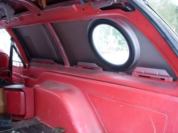

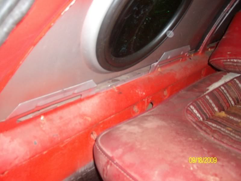

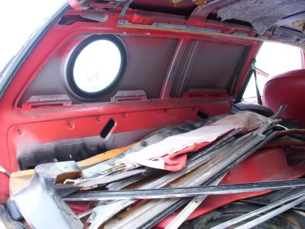

Are these the spot welded tabs we are speaking of?
Yes those are them
Also, does anyone have any of the trim peices that go over the screws they care to part with? They need NOT be in great shape, as they will be painted to match body color in the end....so fit and finish is not a neccessary detail.  OR are there any alternatives that serve as a quality replacement?  This is what I have now... :'(

There are also drip rail extension pieces that go along with the kit as well as the special brackets that were spot welded by the factory to hold in the interior carpet pieces.  Having these items plus what Mark said would get you a complete kit.
