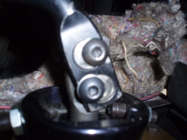

no need to notch...IF you move the mounting point of the cable on the bellhousing.  stock location will hit.
bob
dick1172762
No need to notch anything as joe escobars pictures show.
turbo74pinto
i ran a cable clutch.  i used a bell out of a late 80s mustang that was not a direct pull, it has the fulcrum (thats probably spelled wrong). a notch in the crossmember should be made if you run a bell like i have.  if not, the cable will rub.  look at the pic below. the way i look at it...why bother switching something that works fine???  in my opinion, there are no benafits to running a hydrolic clutch, other than it doesnt have to be adjusted.

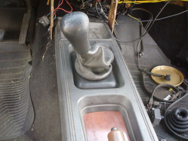

oh yeah, and for the reach:
someone, i think it was wittsend, said they didnt like shifting it like this and used a different set up.  ive had no problems the past year kickin "n" stickin with this set up.
bob
turbo74pinto
amxtra
 Im guessing thats what I will have to do, seemed to be about that amount. Is the shifter farther to reach? and have you ever run a console to see if it still fits. I had put a II console in a couple of my Pintos before, liked them.
in both pintos ive swapped the 5speed into i had to cut the opening 2" forward of the stock opening to accomodate the shifter.
amxtra
  Great job of recording your process, nice work too! I wish I had taken some pics of mine, will be starting now though, Im nowhere near done. When I get a chance to get back into the garage, I can compare it with how your shifter sits.  Thanks for that link, and the older bumpers were worth the effort always liked them better too.
