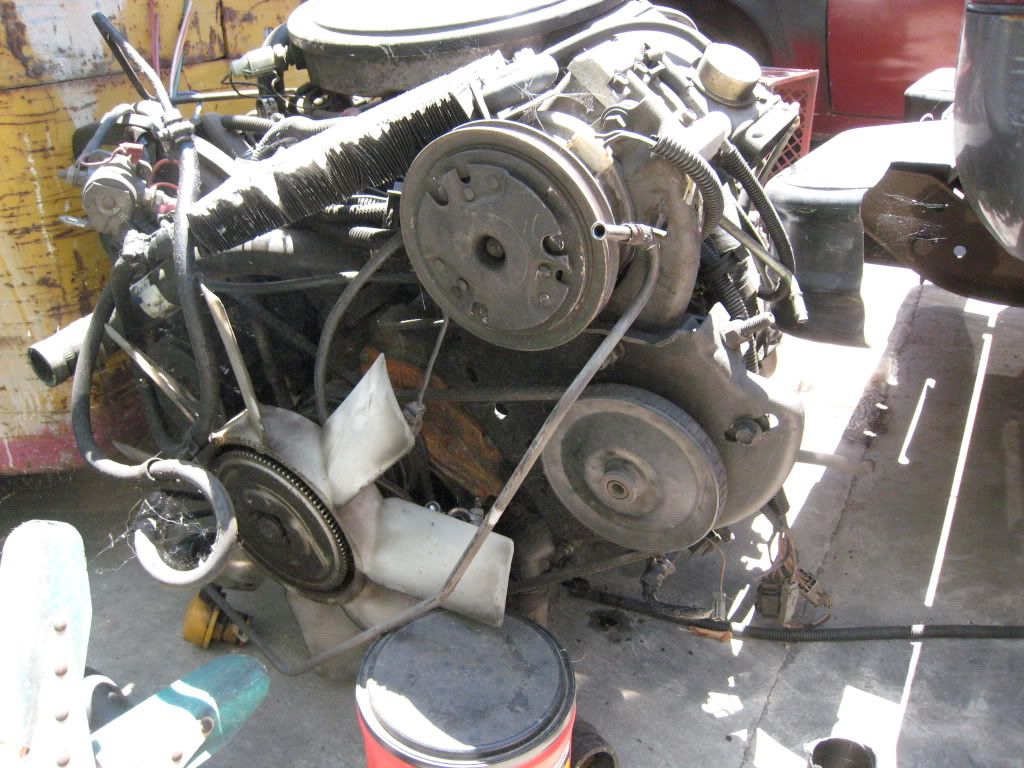

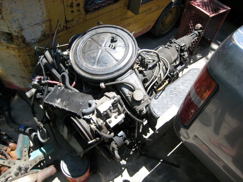

I have a pic of the motor! I know it probable isn't that easy to figure out what it is, but hey, you never know! LOL

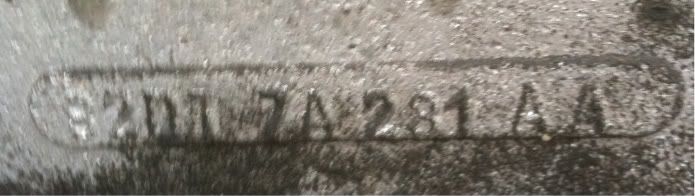

Ok, I am again thinking about using this v6 motor out of the Ranger. Still not sure what size it is though. I asked hubby what year Ranger it came out of and he doesn't remember. He didn't pull it a friend did. He is supposed to ask this friend but he forgot! LOL  I did take a pic of the numbers on the tranny though. Can anyone tell me what it is and will it fit in the tunnel??
These numbers are on the same side of the tranny, just one is in the middle and one is toward the end! If you can't see the numbers in the pics, I will reply again tomorrow with the numbers! To tired to do it now! LOL
Exactly Fred, the manifold is a dead giveaway. Also noticed it has a swaybar. That is a plus! I think it would be great with a Ranger v6 in there.  :)
You can tell by the exhaust manifold it was 2.0.  Fred   :)

he said it had the 2.0 in it.

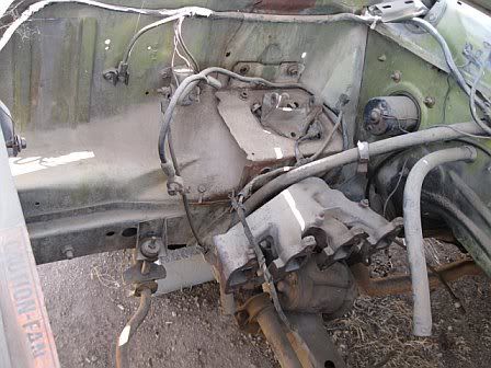

I really don't know what was actually in the car. I don't know if you all can tell from the engine bay or not? I will find out next Sat.
So, what do you guy's think was in it?
